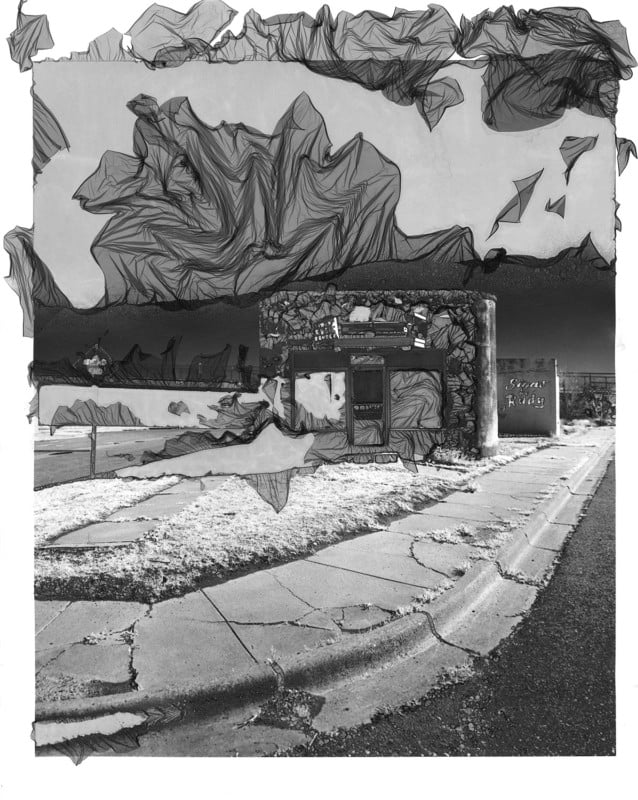

The initial traces of the project started around four years ago, when Lazarus shot infrared (IR) film with his medium format cameras and enjoyed the unique, alien-looking landscapes that it created. He created a selection of IR landscapes — although without an underlying concept or theme at the time — and shelved them for a couple of years. This body of work was later resurrected in 2019 when he had to test out some Mordançage chemistry for a workshop. Simultaneously, he realized that the black skies in his IR landscape shots gave him the necessary tones to start experimenting with the fragile veils that the Mordançage process creates.

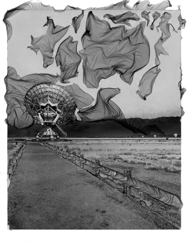

The fragile veils produced using Mordançage chemistry

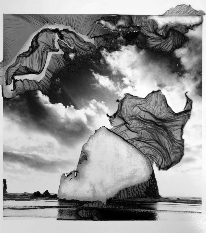

The way this technique begins is with a bleaching process. The darkest areas of the print’s emulsion lift, creating very fragile veils that can be moved and manipulated with paintbrushes and the gentle flow of water. The print is then washed thoroughly, reprocessed through developer and fixer, and then washed thoroughly again. While transferring to each of the separate baths, utmost care must be employed, as the veils tend to carry a lot of water between them and the print’s paper backing, making them heavy and easily spoiled.
An image isn’t ruined if one rips — in fact, a lot of photographers rip them on purpose for a creative result. However, photographers have to be willing to change the intended outcome of the image drastically if they are careless or rushed. Lazarus also employed this unique characteristic of the process by allowing the veils to burst — which adds an additional dimension to each print — as it creates an impression that the landscape is “quite literally falling apart.” After working on this process for some time, Lazarus realized that perhaps this is something special to continue working on for his project.
Each individual Mordançage print takes him about five hours to create, from loading up the negative in the enlarger to final print. He only spends about one hour on his initial black and white print, one-hour processing it through the various chemicals and washes, and two to three hours manipulating the veils in the final rinse.
