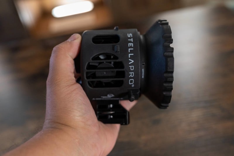

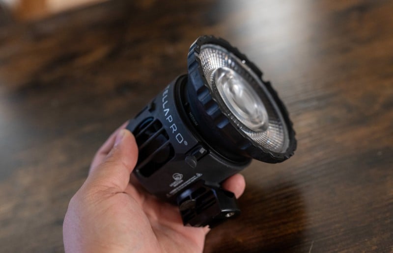

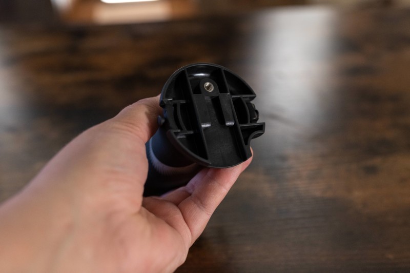

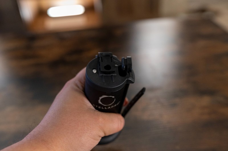

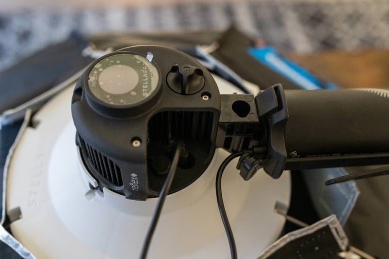

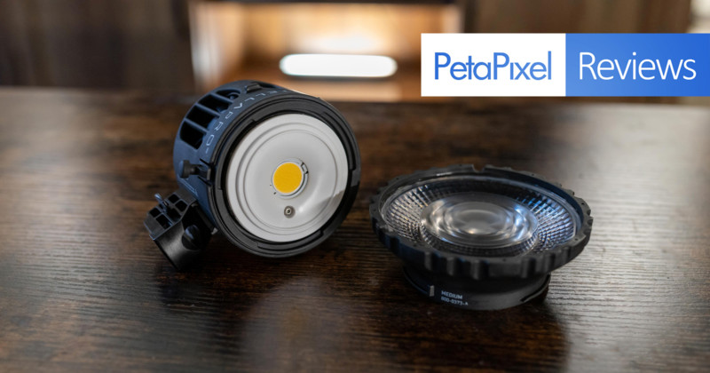

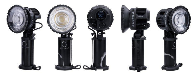

The new Reflex and Reflex S lights are impressively small and lightweight which makes them ideal to travel with. The light head itself can fit in the palm of your hand and just needs a USB-C connection to power it up. Below the light head is a sort of cold-shoe mount that can be adapted in several ways for a variety of different mounting solutions, from a camera hotshoe, to a variety of lightstand combinations.
It works well, but the only thing that concerns me with the design is it is pretty much entirely plastic. While this keeps the weight of the product down, the mounts require a perfect fit to ensure it has “clicked” and is locked in, and in more extreme temperatures (hot or cold), this could prove to be problematic. Especially with heavier modifiers attached to the system, it feels as though the system is a bit precarious and could come tumbling down.
That said, the company promises that the light is incredibly durable, capable of withstanding drops of up to one meter without incident. While I did not want to personally test this feature, it is a bit reassuring to know that if there ever was an issue it would likely survive the fall in most situations. And while I had fears of collapse, none ever presented themselves in real-world use cases.

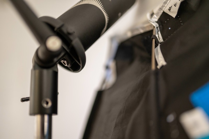

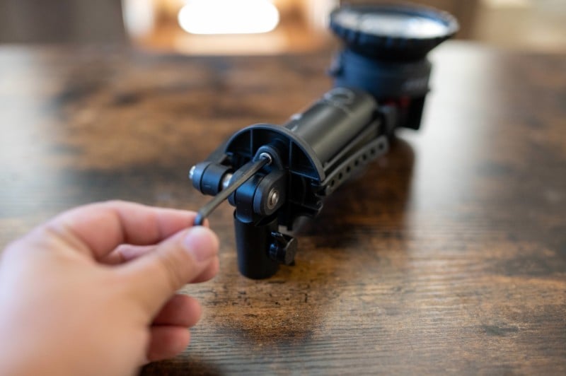

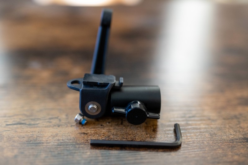

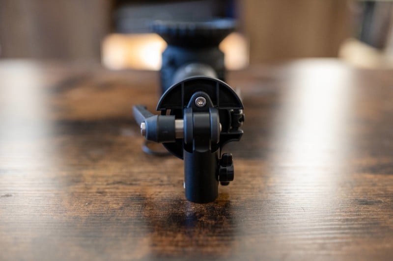

Another element that I was less of a fan of in the product design is the way the adapter works for mounting the light onto a light stand. You have to put the system together and then screw it on using a supplied hex tool. My issue isn’t the stability or security, but with the workflow. Ensuring the battery is securely mounted to the light stand isn’t exactly fast, so if you have to make quick changes, this will pull you out of your zone for a moment — especially since the screw can be easily dropped and lost.
The company also states that the lights are IP65 rated for weatherproofing, meaning you could potentially use these lights in a heavy rain or snow situation. This is something I was unable to test, but it does have me wondering how accurate this is and I’d love to see some actual footage from people using it in wet scenes. The light has exposed grates for a fan and cooling, and while my initial thought is to hide these lights from anything weather-related because of them, Light and Motion’s promise of weatherproofing has me wondering if the way they work is akin to air conditioners, which have external fans that sit in the weather without issue despite all the electronics.

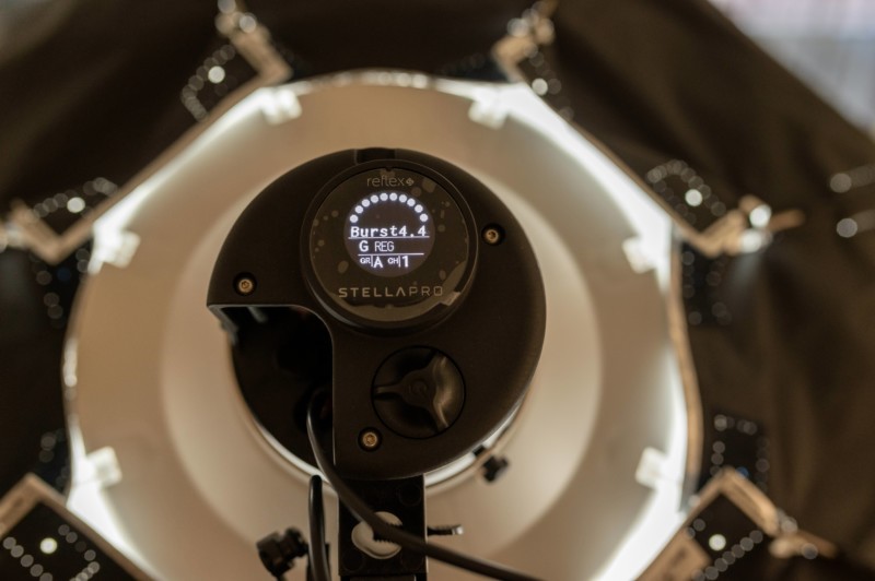

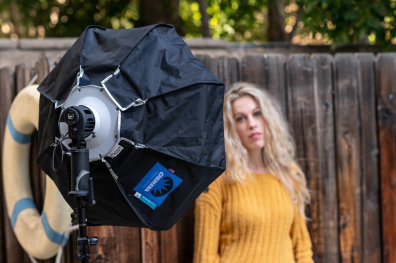

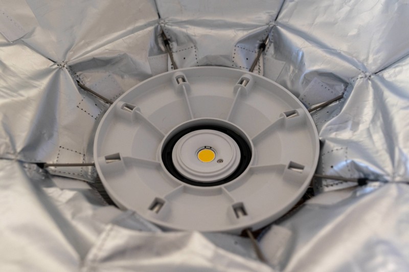

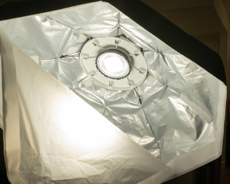

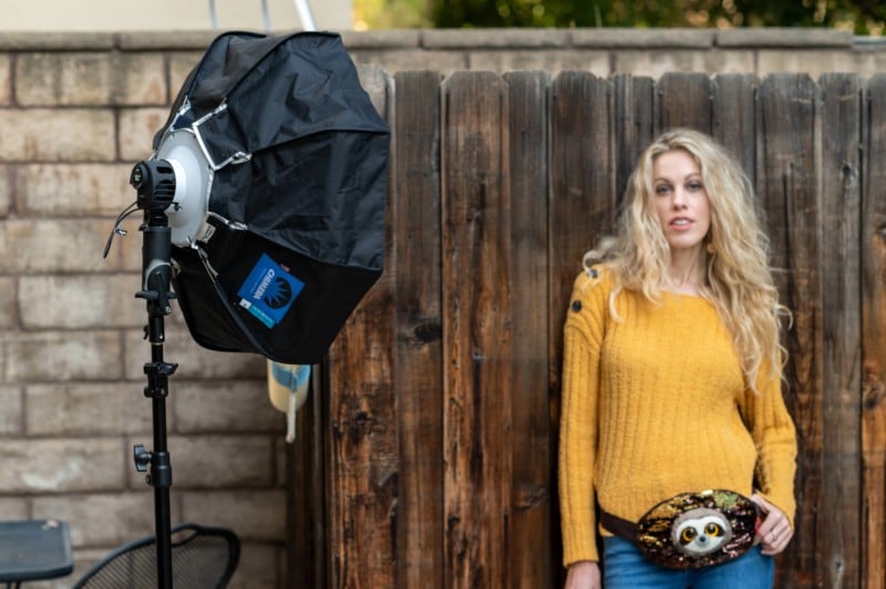

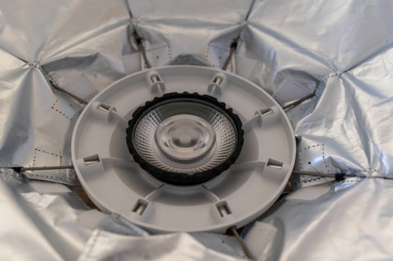

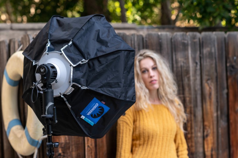

The Reflex and Reflex S are designed to be used with a variety of modifiers and accessories, and are capable of working with nearly any shooting scenario. For this review, I simply used the light bare-bulbed or with a Chimera Beauty Dish that was provided by Light and Motion. In my testing, I found that mounting and adapting these accessories was very fast and easy perform.
One thing to keep in mind is no matter what setup you plan to use, ensure the magnifier (fresnel) accessory is placed back on the light once you’ve attached whatever modifier you plan to use. The lens is critically important when it comes to overall light power, so it’s a must. The instructions do not explicitly say to do this, so in my first tests with the beauty dish I left the magnifier off and the light output was surprisingly low.
The last major concern I had with the Reflex light is the size and positioning of the power switch and menu buttons. The power button on the battery pack is small and positioned very close to the cold-shoe mount which I found makes it awkward to get to when the whole setup is mounted on a light stand. Additionally, the dial/button for making changes to the strobe or continuous power levels is somewhat awkwardly placed and can therefore be cumbersome to make quick adjustments to the power levels.

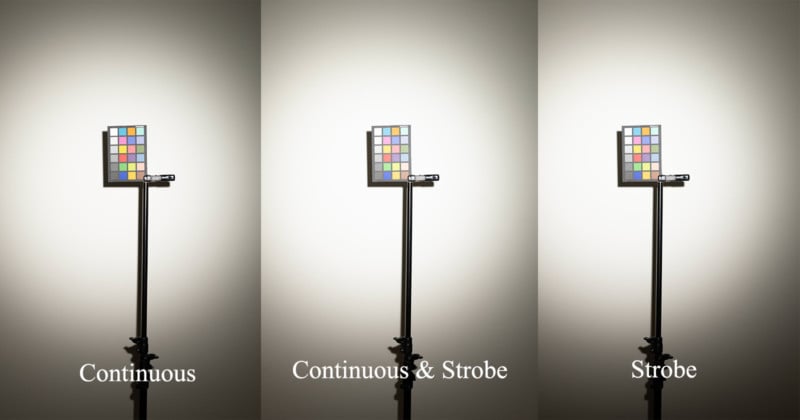

As a moonlight, the Reflex S can output about 86,000 lux at a one-meter distance while using the spot optic with a color temperature of approximately 5,600 Kelvin. The light (when used as a continuous source) can be dimmed all the way down to 100 lumens making it useful for controlled ambient light sources in the video as well. Especially when paired with gels to recreate daylight temperatures or certain mood colors for the theme of a video. That is a good point to make: the light’s color temperature is not adjustable.
Continuous Light
Strobe
Gratefully, I did not notice the color temperature of the light change with variations in power. If there is any change either warmer or cooler, it’s to such a minor degree that it doesn’t affect real-world use.

It is also worth noting that when operating the light in the 4,000 lumens and above, the cooling fan will kick in and it is surprisingly loud for such a small system. It is comparable to a gaming laptop fan when kicked into high gear, and the high-pitched “whirr” can sometimes be difficult to ignore, especially indoors. This is not really an issue for photographers, but videographers might find it annoying to work around when filming in a quiet environment.
