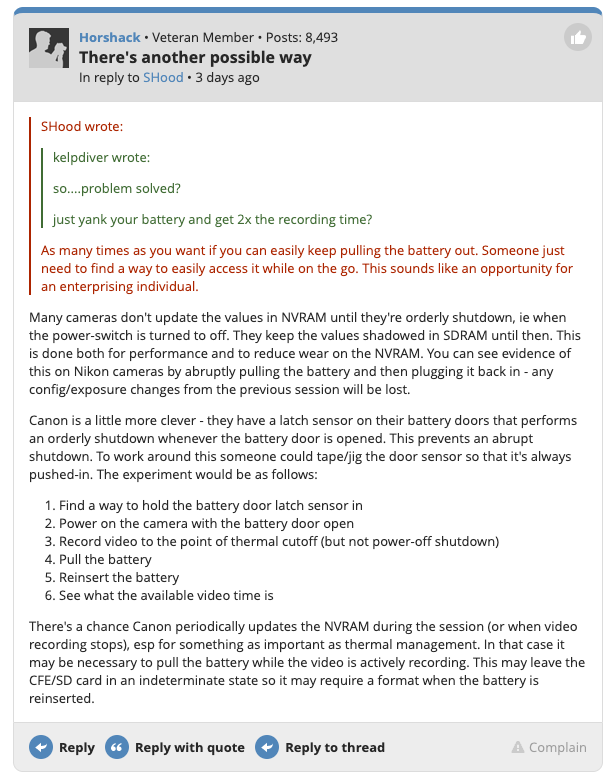

“Another way” by Horshack on the DPR forums.
In a post on the DPReview forums, a user who goes by Horshack proposed an easier way to bypass this function. He suggested that you could “reset” these timers by activating the Canon’s battery door sensor and then pulling the battery while the camera is still recording. This would prevent the R5 from writing the thermal information to non-volatile memory (NVRAM), and if you don’t corrupt your footage in the process, you can shoot as much 8K or 4KHQ as your heart desires without running into the overheating limits.
Long story short… Horshack was exactly right, as you can see from the various videos testing his theory below.
Several people, starting with YouTuber J. Marcus Photography, then Reid at EOSHD, and then some of the bigger YouTubers like Matt Granger, have all run some version of this test and produced the same results: if you can prevent the camera from writing the thermal info to the NVRAM, it resets like nothing happened.
If the overheating limit was actually based on a temperature sensor and the heat inside the camera, then this “hack” wouldn’t work; the camera would just re-read the thermal info as soon as you turned it back on, and find that it’s still overheating. The fact that these tests reset the timer without issue seems to prove that Canon baked a timer directly into the firmware instead.
