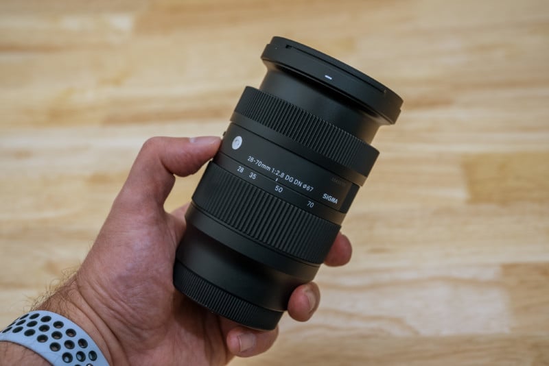

The Sigma 28-70mm f/2.8 DG DN is a compacted take on the popular “desert island” 24-70mm f/2.8 lens that makes a slight concession in focal range at the wide end in order to make itself smaller, lighter, and cheaper: just $900.
This is the latest lens in the company’s “Contemporary” series lineup, which is a categorization of Sigma optics that are typically designed as lightweight, practical alternatives for everyday use and as such are generally available for a more reasonable price than competitor lenses or anything in Sigma’s Art line. Usually, the maximum aperture is the trade-off, but in this case, it is focal length. If you consider the 24-70mm f/2.8 as the common utility zoom lens, Sigma has designed this as a 28-70mm f/2.8, dropping 4mm off the wide end which allows for a more compact design while keeping optical integrity.
This lens has the DG DN designation meaning it was designed for mirrorless as opposed to adapting an SLR design. It comes in Sony E-Mount (used in this review) as well as L-Mount.

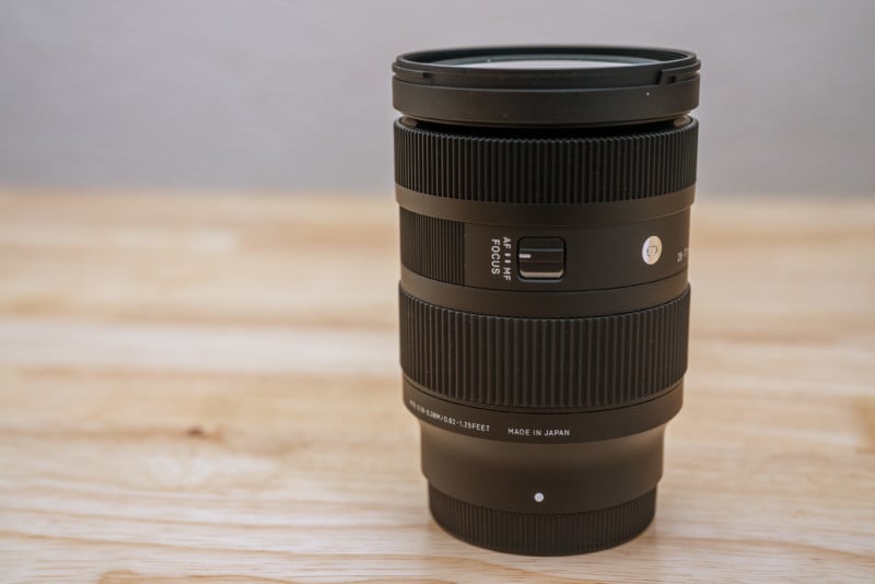

The Sigma 28-70mm f/2.8 DG DN Contemporary lens features 16 optical elements in 12 groups. There are three aspherical elements, two FLD elements and two SLD elements. The lens features a 9 blade aperture and has a minimum focus distance of 7.5” (19cm) at 24mm. As you zoom out this changes to 15” (38cm) by the time you get to the 70mm focal setting which affords a great deal of versatility shooting subjects at close range.
So we have an advanced design, a nice close-focus range and the lens weighs in at 470 grams. While this is light-weight and easy to handle, I was particularly impressed with the rendering characteristics. This is something I typically don’t expect to be very good on zoom lenses at this price point. I am, however quite impressed with what Sigma has developed here.

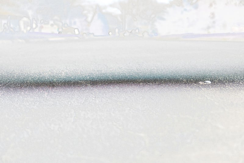

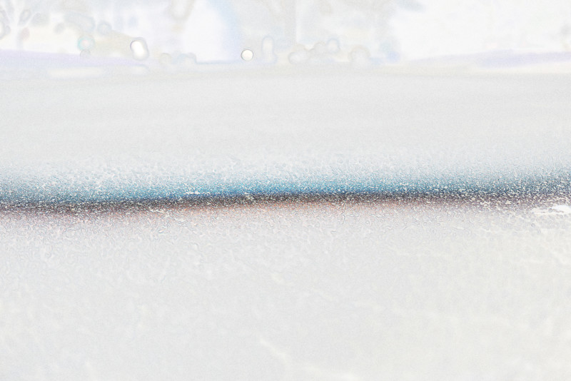

To test this I used a technique that Roger Cicala at Lensrentals talks about quite often. I made an image of a flat surface with texture, in this case the asphalt on a street. I ran this through the “Find Edges” filter in Photoshop.
The “Find Edges” filter will separate anything sharp in the image by making it darker than the other areas. The examples below were all shot at f/2.8 and you are looking at the field of focus. I took three different photos at three separate focal lengths: 28mm, 50mm, and 70mm. You can see that the lens is fairly consistent throughout the range of the zoom.

Another thing you can see is how sharpness is best at the center of the lens and it shows that there is a slight fall off as we move to the edges of the frame.
This is somewhat to be expected on a zoom lens, and of course, will improve as you stop down. However, in practical use, I did find that I was losing sharpness even when I closed down the aperture. This might be an issue if you are looking for tack sharp landscape images, but for portraits and other general use where you’re less dependent on sharp corners, this shouldn’t be a major concern.
