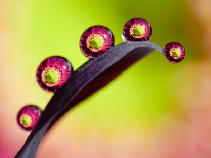

Like tiny crystal balls, water droplets can add a magical element to macro photographs. There are a number of moving parts to consider, but the basic concept is simple: a spherical droplet can act like a lens, refracting light from whatever is behind it.

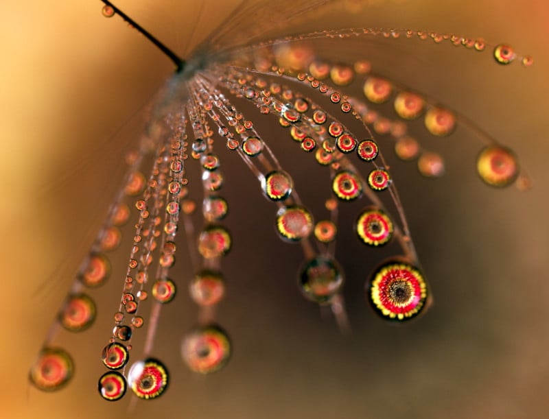

Getting good droplets can be problematic, as most surfaces will cause water to spread out rather than to bead up nicely. Using just plain water (no glycerine or other additives), one of the easiest foreground objects to use is a dandelion seed:

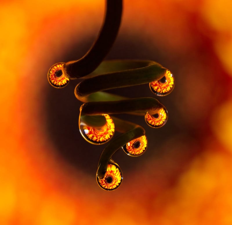

All wildflower seeds with any amount of fluff on them are likely to be a good performer here, creating exactly the kind of droplets we need while also allowing a clear line of sight to the background with no obstructions. Other foreground surfaces that work well with simple misting from a spray bottle include bluegrasses, spider webs, Barberry, and Lupin leaves, and vine tendrils.

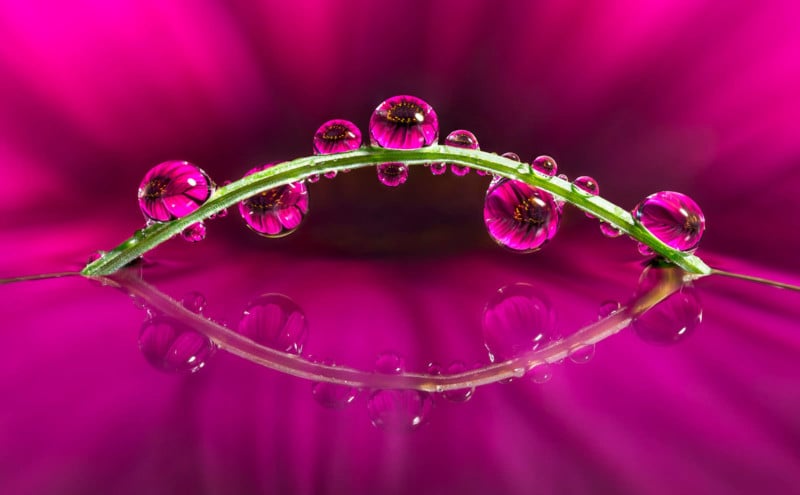

Something as simple as a twisted blade of grass covered in fine droplets can make for a compelling composition, but these images reveal one of the challenges all macro photographers face: depth of field becomes so shallow that it does not extend to the depth of the blade of grass. We reap the benefits of a soft and smooth background, and some images can survive with such a shallow depth, but focus stacking is the answer if you want perfect foreground details.

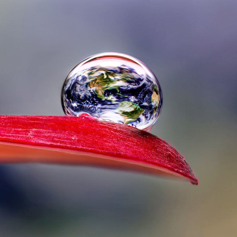

Every image so far in this article has been using a daisy-like flower of some sort — the radial symmetry and flat design work great for initial experiments, but don’t feel like this is a limitation. Put any photograph behind the droplet and see it refract through the minuscule lens as well! How about fire, or an exploding firework image? A butterfly? Better yet, dig through NASA’s public domain archives to find a map of the Earth and put our planet inside of a drop of water:

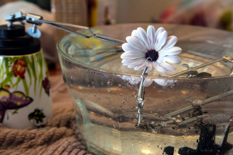

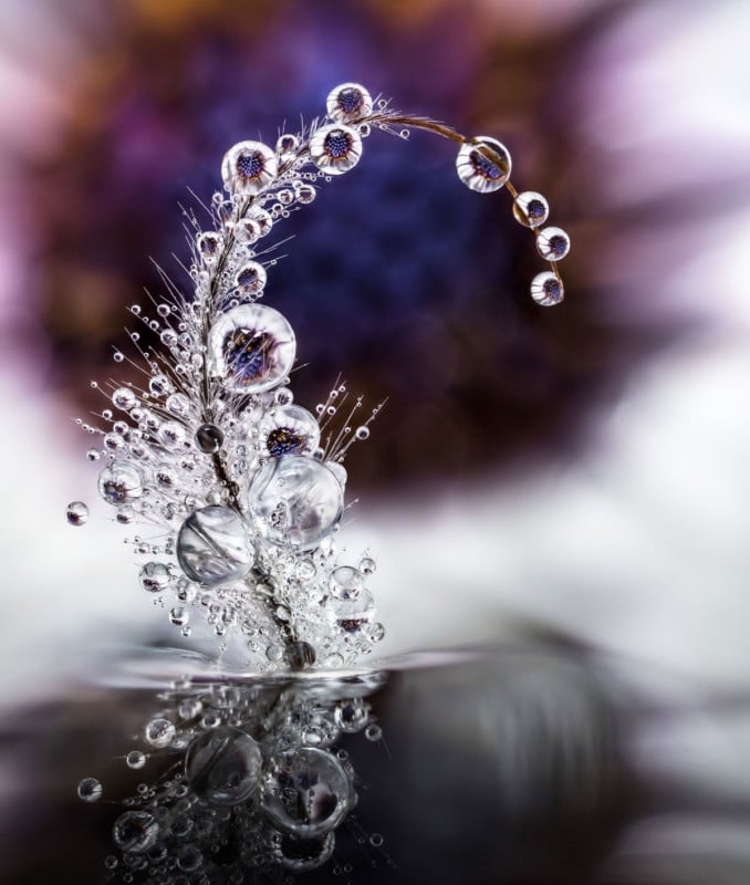

The above behind-the-scenes image depicts a Prairie Smoke wildflower seed clamped under the surface of water with a “Third Hand Tool”, easily bought on Amazon for less than $10. You’ll want a few of these, they are an indispensable tool for this type of photography. They also break easily enough and rust out if you leave them in buckets of water, but they can be replaced for $5 apiece.
The wildflower seed in this image is tricky to deal with since they “animate” when they get wet, twisting and turning when their spine absorbs moisture. You think you’ve got the perfect composition? Add water and it changes almost immediately. The better part of a day was spent guessing where a curve would change and then finally photographing the desired lines and shapes:

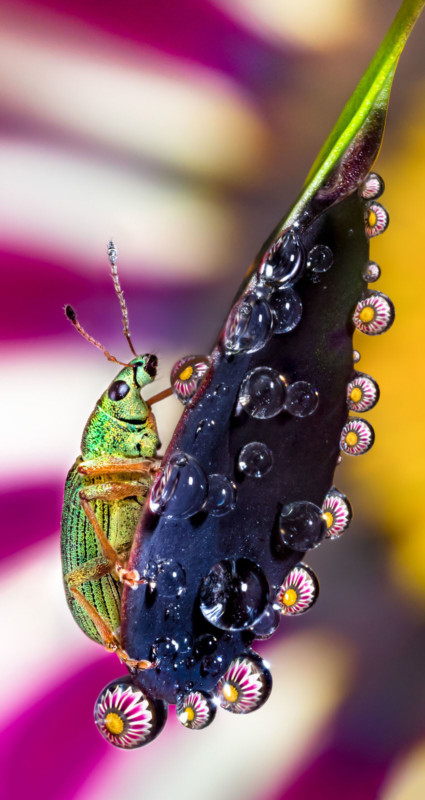

A moving plant is one thing, but what about a live actor? Some critters will sit relatively still, like this Green Immigrant Leaf Weevil on a young Barberry leaf. With lighting in place and exposure and alignment tested, just add in something more dynamic! These weevils don’t move too fast, often sitting still for a few moments at a time:

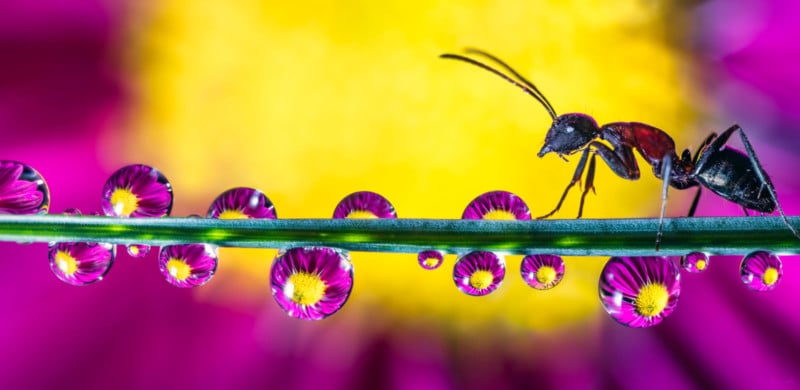

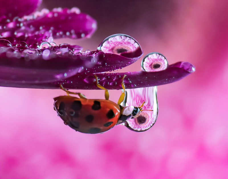

Ladybugs and ants are a different story, requiring you to chase them around to some degree, hoping that you can still keep alignment for decent droplet refractions. Once you’ve mastered the simple droplet refractions, however, adding extra challenges can be a fun endeavor. Sometimes you don’t get the shot, sometimes you get lucky:
