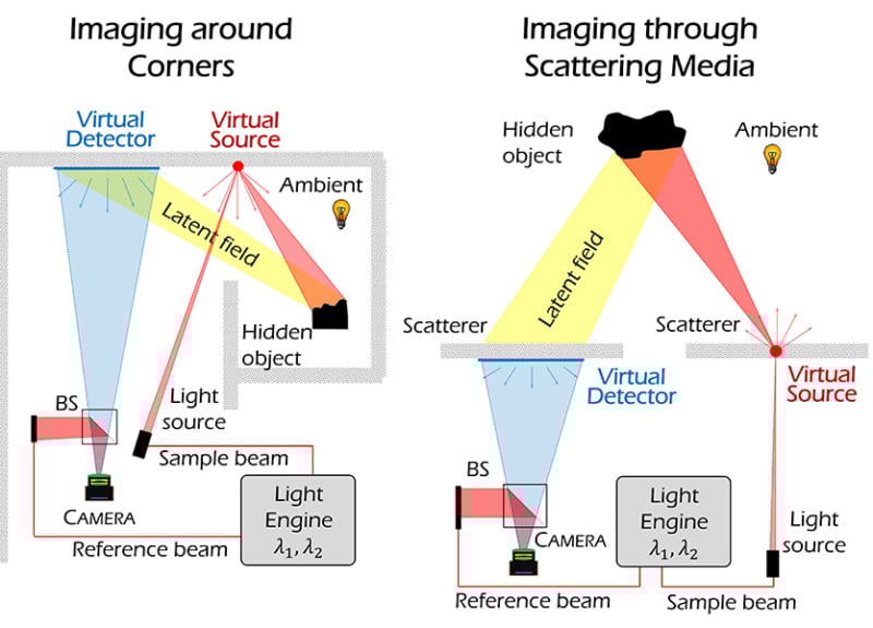

The process is called synthetic wavelength holography, and it’s a new method that works by indirectly scattering light onto hidden objects, which then scatters again and travels back to the camera. An algorithm then reconstructs that scattered light signal in a way that reveals hidden objects. The team says that due to its high temporal resolution, the method also could potentially see fast-moving objects like cars speeding around corners or the human heart beating through a chest.
The idea of photographing or visualizing a subject around a corner versus seeing an organ inside a human body may sound like completely different challenges that would require different solutions, but the team says that they are actually closely related, since both deal with scattering media in which light hits an object and scatters in a manner that a direct image of the object can no longer be seen.
Synthetic wavelength holography is part of a new field of research called non-line-of-sight (NLoS) imaging. The method developed by the Northwestern researchers can rapidly photograph full-field images of large areas with what they describe as submillimeter precision.

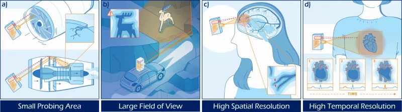

The SWH approach combines four key attributes highlighted in the following potential future NLoS application scenarios: in each example, a scattering surface or medium is used to indirectly illuminate, and intercept light scattered by the hidden objects. a) A small probing area allows to inspect defects in tightly confined spaces, e.g., in running aircraft engines. b) A wide angular FoV allows to measure/detect hidden objects without previous knowledge of their position as, e.g., important when navigating in degraded visual environments. c) High spatial resolution allows for the measurement of small structures, such as non-invasive imaging of brain vessels through the skull. d) High temporal resolution allows to image objects in motion, e.g., to discern cardiac arrhythmia through the chest. The integration of these attributes in a single approach to NLoS imaging distinguishes SWH from the current state of the art.
