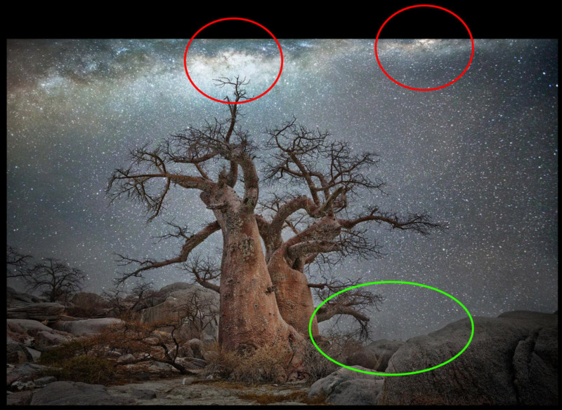

This picture (which was at the center of the controversy) can only be a panorama and not a single exposure. To be able to capture the whole span of the southern hemisphere Milky Way setting, you would need a fisheye lens that would distort the foreground. In this image, a specific warping mode was used during the stitching process, creating a bent Milky Way instead. However, what is most noticeable about the picture is the Milky Way itself. While its position and curvature are definitely possible at the location it was taken (Botswana), its overall shape and look is irrefutably unnatural. Some parts of the Milky Way were quite obviously cloned several times, perhaps to make it look more impressive.

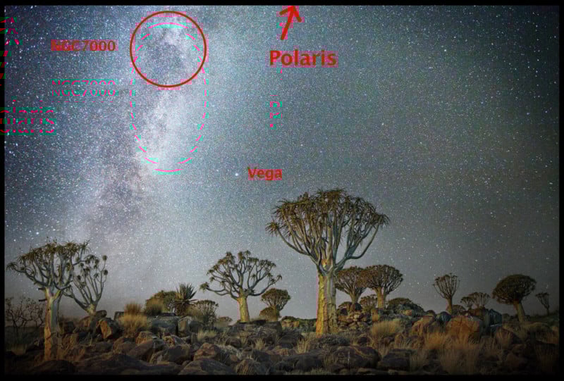

The caption says that this picture was taken in the famous Quiver tree forest in Namibia. However sharp eyes or people that have been to that place will realize that the sky does not match the foreground. For starters, in real life, there is visible light pollution in several directions around the forest and none of this is visible here on the horizon.
However, the most compelling evidence is to have our own galaxy oriented this way. It is simply impossible in the southern hemisphere! You can perhaps recognize NGC 7000 (North American, Pelican nebulae, Sadr region), the bright star Vega and Polaris, which would be located above the frame. But the North Star Polaris can never appear above the horizon below the equator as a rule.
The Cygnus part of the Milky Way, if visible, usually points downwards. All these elements constitute a solid case about the photograph being, in fact, a composite where the foreground was taken in Namibia and the background sky somewhere else in the northern hemisphere, and at a different time of the year.

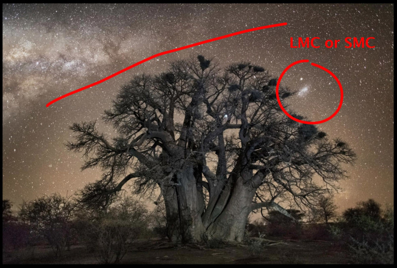

In this picture, the Milky Way appears over a baobab tree of Botswana. The Milky Way appears to be completely cloned out around the Eagle and Shield constellations, which can never happen in real life. In the upper right-hand corner, we can also discern either the Large Magellanic Cloud or the Small Magellanic Cloud completely out of place. This underlines a heavy cloning manipulation in the picture.

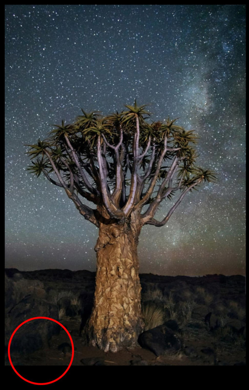

In this picture seemingly taken in Namibia again (with a Quiver tree in the foreground), we can see an upright Milky Way across the top right-hand side. Again the Milky Way can simply never appear in this manner in the southern hemisphere. With this orientation and focal length, the “Southern Star” (the point of the night sky around which the southern hemisphere sky rotates for a viewer from Earth) would be located approximately within the red circle. However this point is right above the horizon in Botswana! So the sky has conveniently been lowered so that the core of the Milky Way appears in the frame.

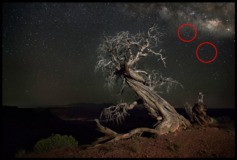

In this picture, shot in Utah, the Milky Way has blatantly been added in. The difference of luminosity of the Milky Way and the overall background sky doesn’t add up. When we zoom in and look at the stars in the Milky Way and outside of it, we can see that they don’t ‘suffer’ from the same aberrations (lens errors that affect the image). The Milky Way stars appear sharper and rounder while the ones below appear blurry and trailing. This only happens the other way around where corners get affected more than the center.
Another disturbing evidence is that the Milky Way has its core too high in the sky for the latitude of Utah. Judging by the size of the Milky Way, I would say the shot has been taken using a 14mm to 20mm lens. If you are stargazing in Utah, there is no way you can get that much distance between the horizon and the core of the Milky Way regardless of the time of year.
