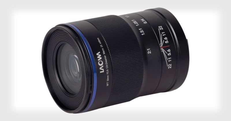

Over the past few months, pre-production copies of the new Laowa 50mm 2:1 F/2.8 Super Macro Lens for Micro Four Thirds (MFT or M4/3) had been going around among some M4/3 macro photographers.

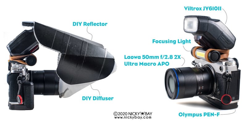

The lens arrived very shortly. BUT, I didn’t have any M4/3 camera! With my friend Victor Cheah’s help and the generous loan of an Olympus PEN-F with his custom-made Victor flash diffuser (THANK YOU!), I quickly put together a simple M4/3 setup for high magnification macro.
- Olympus PEN-F
- Laowa 50mm f/2.8
- Viltrox JY-610II flash with DIY diffuser designed by Victor Cheah
- Small COB LED Focusing Light

The Laowa 50mm is an APO (apochromatic) lens.
Achromatic lenses are corrected to bring 2 wavelengths (usually red and blue) into focus in the same plane. Apochromatic lenses are designed to bring 3 wavelengths (usually red, green, and blue) into focus in the same plane, and are also corrected for spherical aberration at two wavelengths.
What does this all mean to the layman? It just means that there is better control of chromatic aberration (less of those blue fringes between regions of high contrast). It will also have less bokeh fringing, leading to smoother out of focus backgrounds. i.e. better image quality.

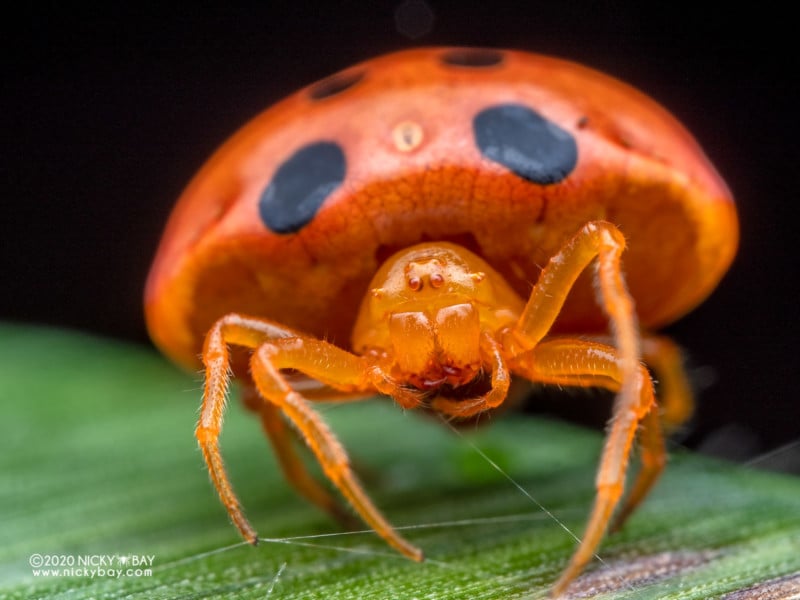

Ladybird mimic spider (Paraplectana sp.)
My initial test shots were set at f/11. The photo looks decent, but at 2x, the effective aperture is f/33 so if one were to pixel-peep, there would be some obvious diffraction. For more on ladybird mimic spiders, check out this article.

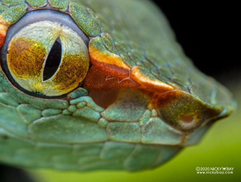

Wagler’s pit viper (Tropidolaemus wagleri)
Many asked if the working distance was too short at 44.45mm. It was still very usable for me, and I was able to go up to 2x on this venomous pit viper. With proper flash diffusion, lighting wasn’t an issue too.

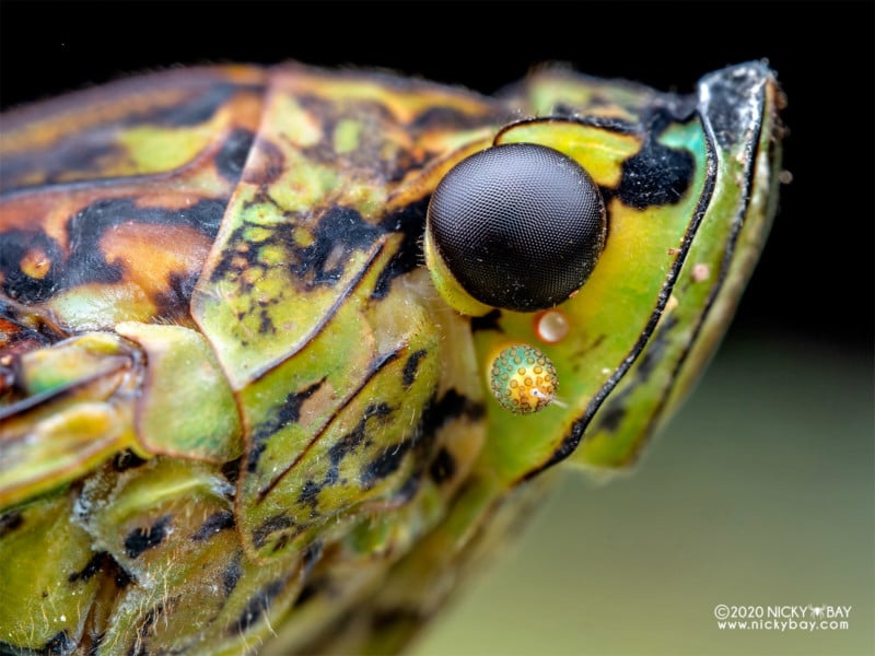

Planthopper (Dichoptera sp.)
Following the results with diffraction, I tried using wider apertures at f/5.6 and f/6.3. Sharpness improved considerably. This shot was a handheld stack of 3 shots. This planthopper belongs to the same family as the popular lantern bugs!

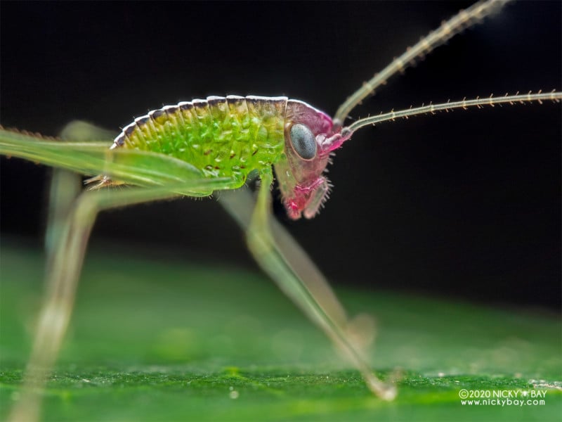

Katydid nymph (Tettigoniidae)
After several rounds of experiments, I had settled with an aperture of f/6.3 for 2x, and f/8 for 1x.

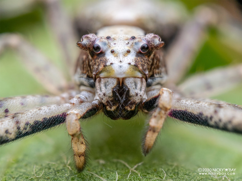

Crab spider (cf. Tarrocanus sp.)
I had gotten very comfortable with close-ups of most subjects at 2x magnification.

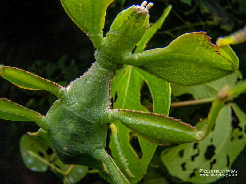

Leaf insect (Phyllium chrisangi)
Just for fun, I stacked a relay system onto the lens, consisting of 2 Raynox close-up filters, and a CCTV lens. The high magnification allowed the CCTV image to be relayed to the M4/3 sensor quite well. This is an experimental setup, so don’t try to look at the image quality. Image quality is typically low for CCTV relay systems.
It’s not every day that we can get to photograph the subject together with the person whom it was named after. Meet Chris Ang with Phyllium chrisangi!
The problem with such systems is that with a close working distance of 1cm (not due to the lens, it is a trait of such setups), the subject can easily climb onto the lens. Not really a disadvantage to me, as I love sticking the lens up close to the subject’s face. Once, I stuck the lens into a chameleon’s gaping mouth. But that’s another story…

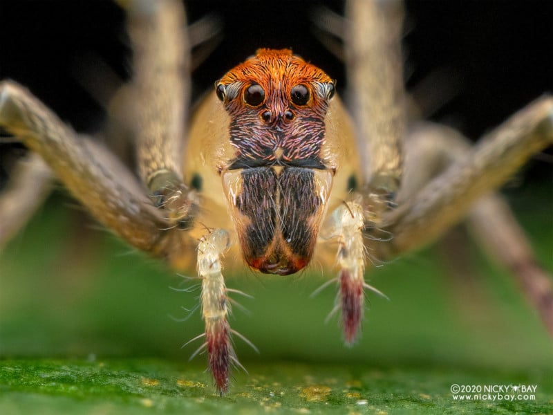

Lynx spider (Hamataliwa sp.)
Some of us called this the monkey-face. It is actually a tiny little spider at about 3-4mm long.

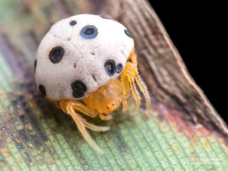

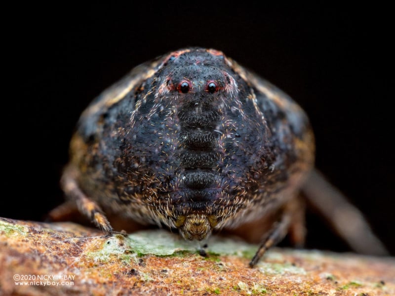

The first test shot in this post featured a red ladybird mimic spider. It is only apt to round it up with a juvenile, white ladybird mimic spider.
