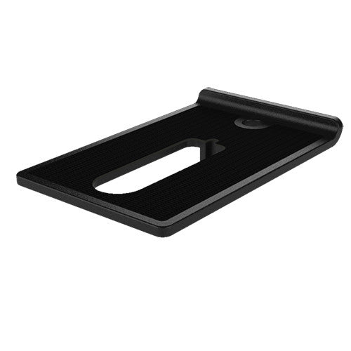

The Photographyandcinema's ATP Anti Twist Plate for Manfrotto 501 quick release is a wish list for alot of cinematographers using Manfrottos BHDV monopods and 701-501 heads ...
It comes with 2 plates, one for bigger dslr and another one for NEX type of cameras (or so they say)
I personally have problems with the original manfrotto quick release plate slightly twisting after a long day shoot and when i need to mount a quick shoot on my steadicam, the problem comes where its not 'quick' anymore cause i need to adjust the plate OR the steadicam .... So this is a life saver "If it works well"
Here, i've it on my 5d3 with 24/70
Its fits quite well and i'm sure they actually designed this based on the 5D series due to the user base ... After locking, I cannot use my bare hands to twist it ... I'll update here after a real world situation.
The cool thing about this that I was expecting the 2nd smaller plate to work on my Gh3 and it does ... So basically, i've saved USD$25 on another plate.
A little 'long at the rear' but i can live with it ... cause the gh3 was the main one that twisted more often during shoots ...
Overall, its awesome ... Finally a solution for twisting ... A piece of mind and one less thing to check for every shoot ...
The price is USD$25 (I got a $5 discount with as their subscriber) ... The shipping is USD$15 (Fking hell) and it a damn worth it cause it reached me in ONE DAY ... amazing speed from DHL ...
