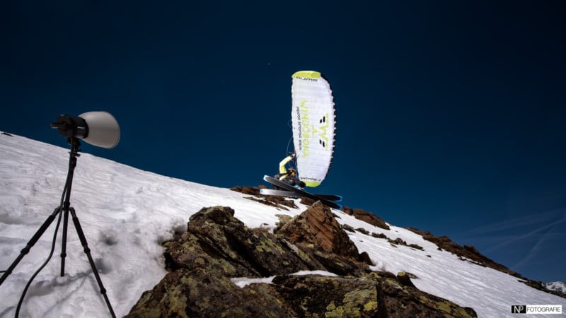

Some months ago, I did a speed riding photoshoot with FriedeFly in the Swiss Alps. I was able to try out some new stuff in the snow and managed to capture some really nice shots. During the shoot, I also played around with my old Jinbei DC II 600 V flash since I was fascinated by shots of skiers made with flash that overpowers the sun.
While using the Jinbei in this harsh environment, I faced a lot of problems. I’ve never liked the user interface, but in mountain snow it was even harder to use. For some settings, you have to press two small buttons at once, which never worked out for me — it always changed the wrong setting. Furthermore, it was a pain to get the triggers to work — they did not work properly without moving them around on the camera connector and when you accidentally touched a button they switched channels so that you have to fiddle around another five minutes to get them working again.
But the main problem was that I just didn’t have as much power to light up the speed rider as I wanted. The 600 Ws where already a lot, but it was hardly noticeable during harsh daylight. This was when I began to search for a flash that fits my need.

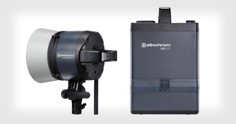

For me, the ELB 1200 combines all my requirements the best. It’s relatively lightweight, has a lots power, and has one of the brightest modeling lights on the market, which you can also use for video (it has a fan that you can switch off). It also has a built-in trigger with a large display which allows to change a lot of settings and also has a key-locking feature so that you won’t accidentally change settings.

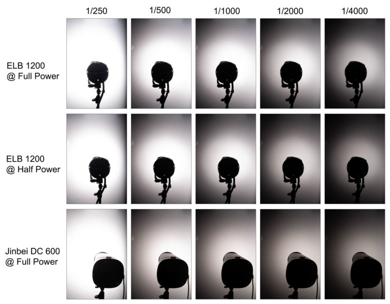

Of course, the ELB 1200 has more power than the Jinbei, but I was also able to control the power much more precisely. The ELB has 1200 Ws which can be controlled in steps of 1/10 (from 1200 Ws to 7 Ws). The Jinbei has 600Ws and can change the power from 1/1 to 1/128 (from 600 Ws to 4.7 Ws) in steps of 1/3. But if you change the Jinbei to Hi-Sync Mode, it’s only possible to control the power from 1/1 to 1/16.
Below is a photo series of the two units firing to a white wall (Jinbei in super-sync mode). On both flashes, I removed the reflector to make the power output more comparable. The camera was set to f/22 and ISO 50.
There are maybe better ways to compare the flash output power, but I don’t have any measuring instruments and for me it was more important to test the brightness with the camera that I’ll use in the field.
It is great that both devices did not show a noticeable gradient when using Hi-Sync at 1/4000 (my D750 does not support 1/8000). Gradients can appear when using Hi-Sync when the flash brightness falls off too quickly.

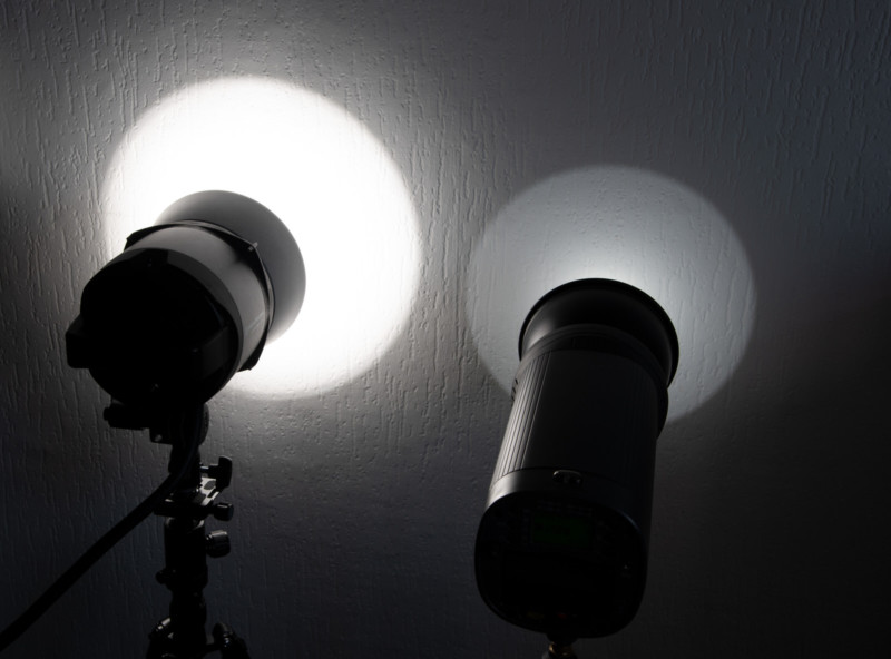

Both devices seem to have roughly the same brightness at 600 Ws (Half Power of the ELB). But since the Jinbei has a slightly narrower beam (see Picture below), the ELB might be brighter but you won’t see that light on the wall in front. That is probably also the reason why the ELB at full power does not look much brighter than the Jinbei at full power.
Elinchrom High-Performance Reflector
Along with the ELB 1200, I also got an Elinchrom High-Performance Reflector. With the reflector, it’s possible to throw the light much farther, which would hopefully allow me to light up a speed rider. The reflector is very light but a little bit bulky. My first thought was: “how should I carry this thing while skiing?” I did not find a reflector for the Jinbei (Bowens bayonet) that is that small and has the same tight beam.
Below a short comparison between the flash with no reflector, the standard reflector (90° 16cm) and the high-performance reflector (48° 26cm). As you can see a good reflector will probably help you more than a flash with doubled power.

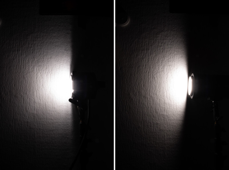

Power Measurement Retry
The first thing I noticed on my recent power output comparison was, that the ELB does not look much brighter than the Jinbei. Of course, that does not justify my expense so I had to redo the test.
As I already found out: the light beams are very different, so my test was not really comparable. Also, the color temperature is different, making it difficult for the eye to determine which one is brighter. So I repeated the test with both flashes and the High-Performance reflector attached to it. The bayonet on the Jinbei is different so I used some tape to attach it. With the reflector attached the flashes are way too bright to use the same settings as before. So this time I used ISO 200 f/4.5 and an ND1000. Here are the results:
The ELB 1200 is a small touch brighter at half power (600 Ws) that the Jinbei DC 600 at Full Power (also 600 Ws). I used the color pipette to get the center brightness.

Compared to the Jinbei (27x13x20cm at 2.5kg with battery) the Elinchrom unit is pretty heavy (4.3kg PowerPack plus 2.2kg Head). With the larger battery, the PowerPack is 4.7kg. However for a 1200 Ws device, the Elinchrom is really small (PowerPack: 18 x 13 x 28 cm, Head: 22.5x14x23cm), it is the smallest unit I found on the market.

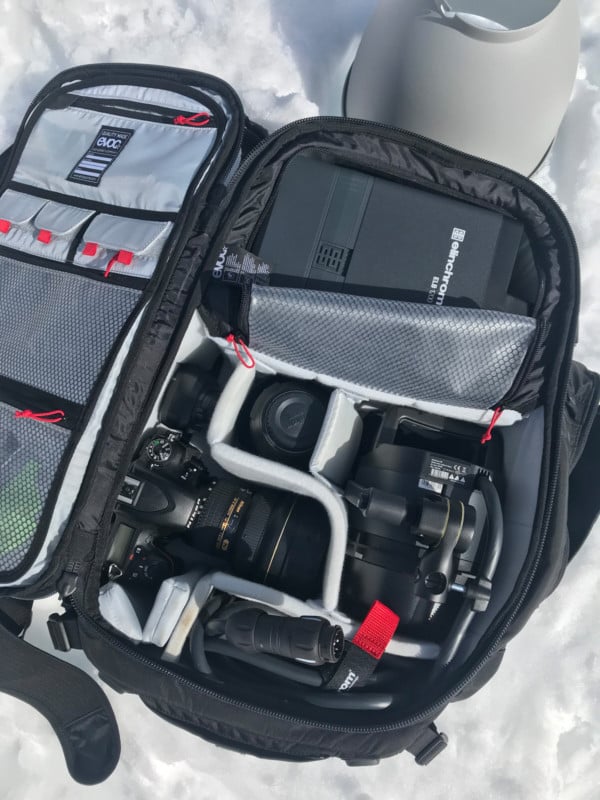

One of the things I really like is the fact how small the battery pack of ELB 1200 really is (for a 1200Ws flash). It was even possible to fit it in my backpack together with my Nikon D750, a 14-24mm and a 24-120mm. Solely the High-Performance reflector was a bit bulky, which I had to strap to the back. It is very light so it does not matter while driving, but you have to be careful when entering a chairlift or gondola.
Of course, the Jinbei was even smaller and easier to pack, e.g. it was also possible to carry my DJI Mavic inside the backpack… but if you want 1200Ws you can’t have it all.
