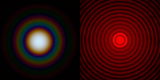

On the left is a simulation of the scattering of light called an Airy disk. You can see the spread of light colors in a prismatic pattern. But even with light a single color of light you get a spread when the aperture is very small. On the right is a photo from a red laser. The single wavelength of light produces a distinct set of rings.
When you shoot at a large aperture, a smaller percentage of light rays are passing closely to the aperture blade, so the scattering is limited and things look sharp. As you close your aperture down, a higher percentage of the light rays scatter on top of each other.

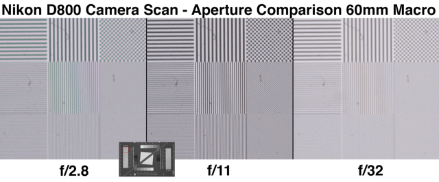

Here are three photos made with the same camera and lens:
At the widest aperture, (left image) the soft focus is caused by the chromatic aberrations and focus imperfections on the outer edge of the lens elements. As you stop down, you get to the sweet spot of the lens and the sharpest image (center image). And as you continue to close down, you run into the limits of diffraction (right photo), even though the lens itself is likely to have the fewest imperfections in this part of the glass.

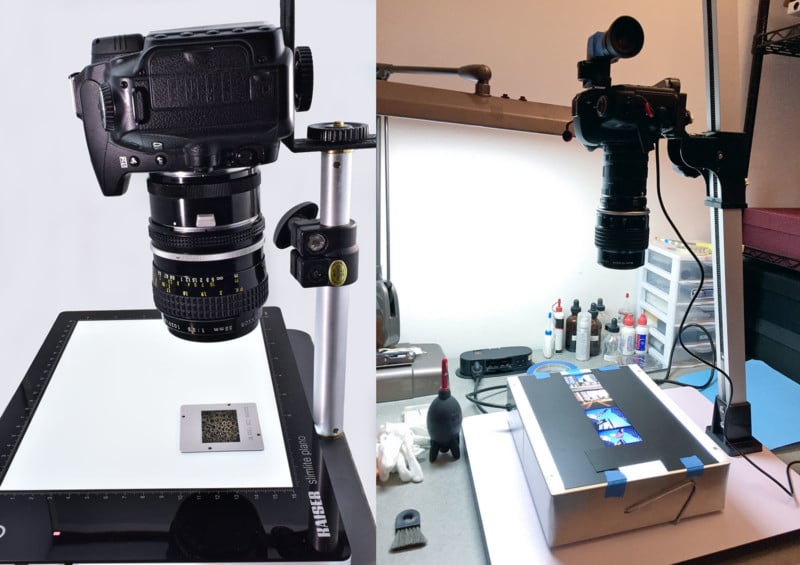

Camera scanning rigs. Photos by pedrik and Roger Gerbig and licensed under CC BY 2.0.
