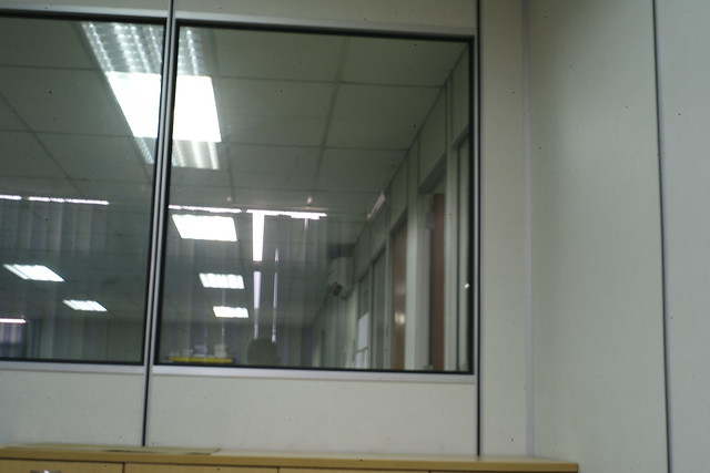

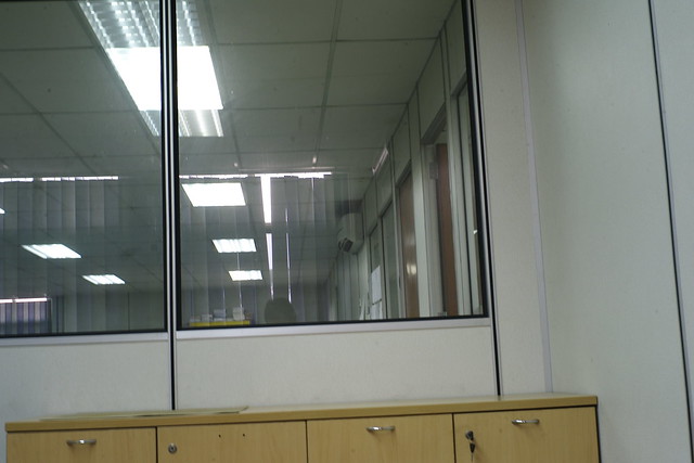

Took some pictures today and found out got dots
the smaller the F, the more obvious it is
whats the issue ar? how to remove it?
Thanks in advance many many
Bring your camera to camera hospital look for steven! Dust on sensor, my was more terrible than yours. Steven manage to clean all up. My sensor have at lease 50 dot. Good luck bro!

If it's dust, I don't even bother with cleaning nowadays. Dust stay on cos of static, after a while they will disappear and then reappear again. How often do u want to clear the sensor? I only did it once in the 4 years that I've got my M8. Usually easily removed with PP.
seems like quite annoying wen it comes to smaller apertures
ivan, did urs reappear, yet?

Not until I send to camera hospital for clean up. If there is just a few dot then sure can ignore it, but when see it obvious like 50 dot...pretty annoying right. Bro u can send in to let steven check up for u. Should be around 1 day.
Google camera hospital Singapore u will find the address.

not sifu here, but it does look like dust on the sensor.
you can possibly live with it, esp if you usually shoot indoors and wide-open. you may have to clone out he occasional dust bunny... but a more definitive solution is just to get it cleaned (for DIY, the orange sticker on your body cap tells you which page of the manual to read).
btw, if you think that the above is hideous, either shoot the sky or a white wall... you'll see. ;)
Dust on sensor is something very common for DSLR users too. I used to DIY on my Canon DSLR with wet swaps and using a loupe to check on the sensor. Try that. Do note not to get any of the grease surrounding the sensor onto the sensor. U will never get it fully cleaned after that.
U can get those wet swaps from Cathay Photo. Do it cautiously.
tested on the sky, lagi obvious...
80% i would be shooting wide open though....
guess will give it a try at cleaning it 1st, then see how
thanks
