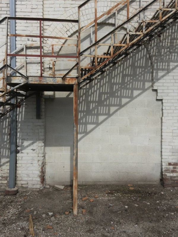

We returned to the studio to regroup and figure out the next scenario. The second look was to be shot with natural light outside. How would I unify images that were harshly-lit in an industrial environment with those shot in soft outdoor sunlight? The sun was going in and out of the clouds, meaning I couldn’t rely on shadows to carry the shot. I put Emily in front of a fence covered in vines in order to get some nice contrast shapes. Lucky for me, on our way back inside the sun popped out for a moment, so I had her stand under a fire escape to incorporate some hard shadows.

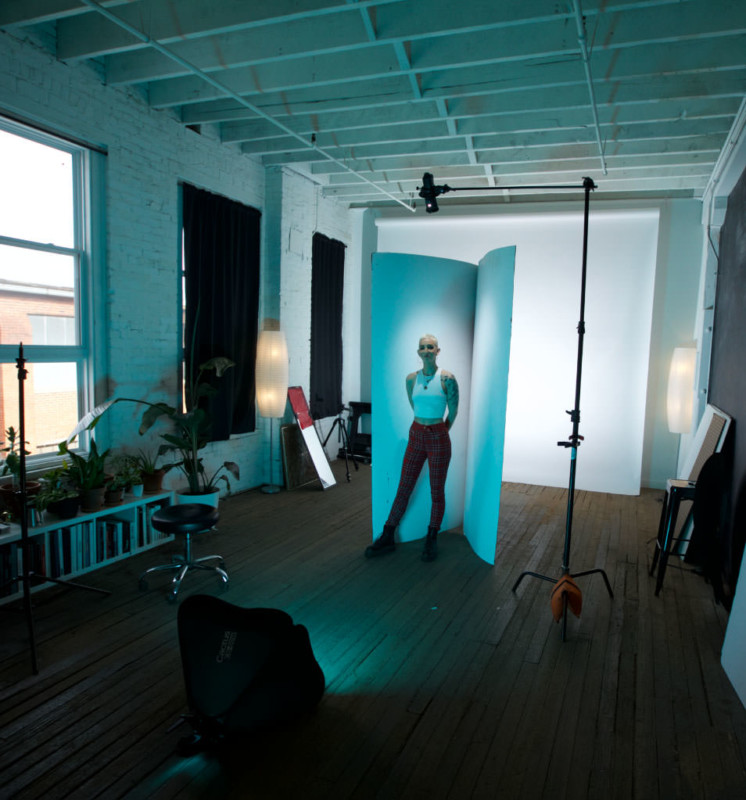

For the fourth look, I needed to incorporate cyan (not so different from the green), a spot grid, and shoot in studio. For the sake of cohesion, I decided to use the v-flat once again, this time placing her in the middle. By showing the top of the v-flat in the shot, it mimicked the shape of an open book, which I kind of liked. I lit the whole the model and v-flat with a cyan-gelled softbox (a stop underexposed). I lit her with a spot grid. I lit the backdrop behind the v-flat with a third, unmodified flash.
