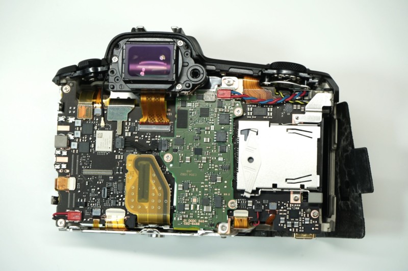

Kolari says that after several thermal analyses of the camera, its engineers determined that the processor on the motherboard was responsible for most of the heat inside the body.

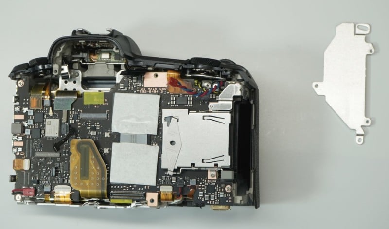

“In the stock design, Canon places two thermal pads partially over the processor and pumps the heat into a small heatsink,” Kolari writes. “That heatsink however sits under another board and does not vent heat anywhere further.”

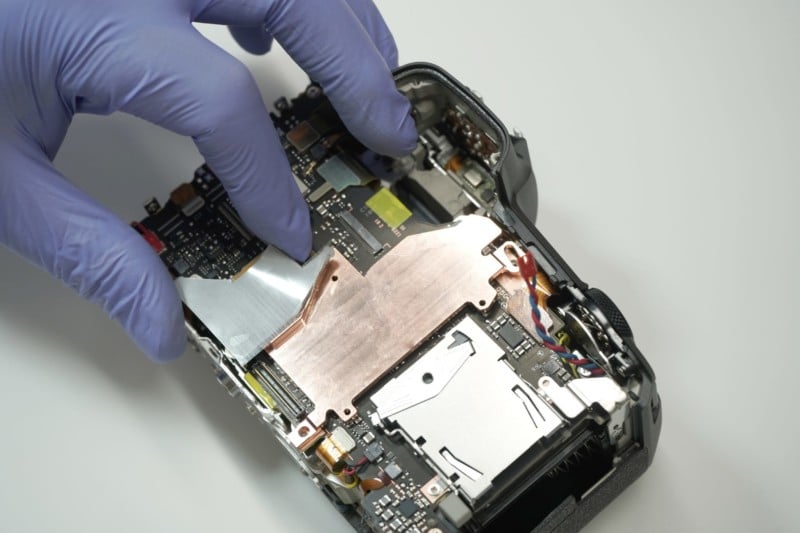

It was here that Kolari designed its own solution: a new heatsink that would vent the heat from the processor to the camera casing, where the company says it believed the heat would be able to dissipate faster.

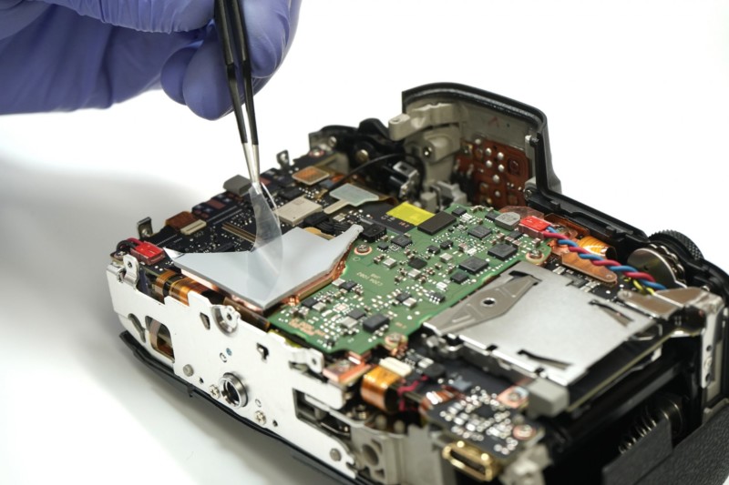

“We tested aluminum initially, but eventually settled on a thick copper heatsink to transfer heat more efficiently,” Kolari says. “This design draws heat out of the processor and brings it around the motherboard and out to the rear case where it transfers heat through a high-efficiency thermal pad. This design is fully internal to the camera and maintains the weather sealing of the camera.”
