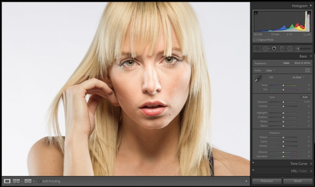

In this case, our subject has a trademark mole just to the right of her chin. Should you remove it, or…

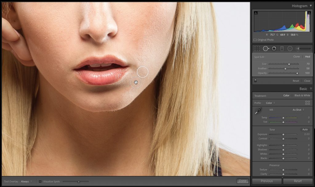

STEP ONE: In Lightroom get the Spot Removal tool (in the LR cloud, it’s called the Healing Brush). Make your brush a little larger than the mole or scar or whatever, you want to remove and just click once. The tool will find a nearby area of clean skin to sample from, and with any luck at all the mole (in this case) is completely and seamlessly removed. Admittedly, Lightroom’s tool is kind of a role-of-the-dice as to how it works because sometimes the places it chooses to sample from boggle the mind, but in this case, it worked, so don’t kiss a gift horse (and all that stuff).

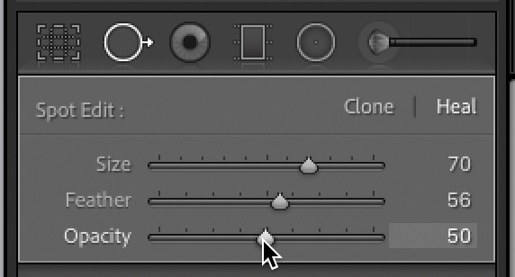

STEP TWO: Now that the blemish is completely gone, head over to the Spot Edit panel (near the top of the right side panels), and lower the Opacity to 50%. This is kind of “Undo on a slider” so dragging it to the left, reducing the Opacity, brings back part of the mole you just removed. By dragging it to 50%, you’ll still see the mole, but only at 50% of its original intensity so you reduce its impact on the portrait. That’s all there is to it (told ya it was easy).

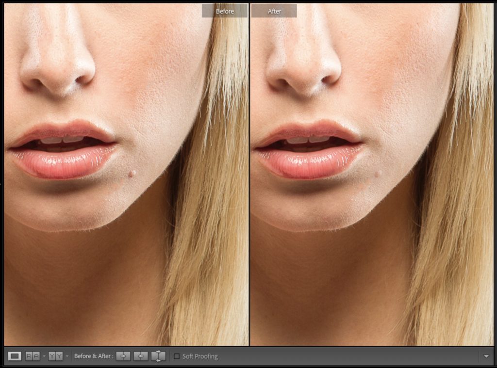

Above: Here’s a before and after, and you can see it’s clearly still there but with its impact and effect on the portrait much more limited, and more natural looking.
