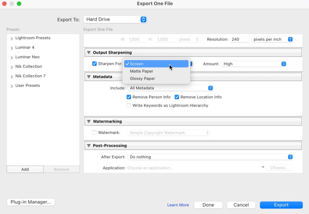

A. The only two things I do are to make sure when I export the files as JPEGs (using Lightroom Classic’s Export window seen below) are: (1) converted to sRGB mode for the Web, and (2) I add sharpening for online in that same Export window. I don’t resize the image – I upload the full-resolution image as is.
Above: (1) Here’s where you choose sRGB as your color profile for viewing in a Web Browser.
Above: (2) In the Output Sharpening section of the Export dialog, I turn on the Output Sharpening checkbox and choose “Screen” as the destination, and set my Amount to ‘High’ (unless I’ve previously sharpened this image using a plug-in, like Topaz Sharpen AI or On1 Tack Sharp.
