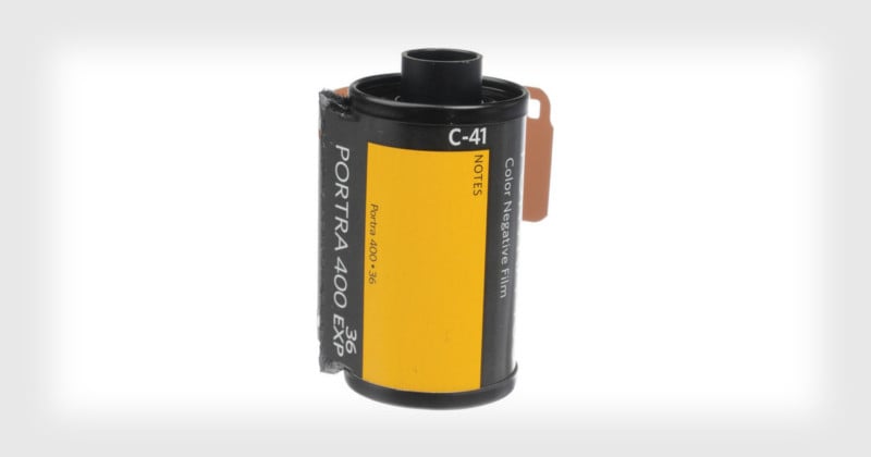

At night, it can be especially difficult getting enough light to shoot film. There are no color emulsions with speeds higher than ISO 800, and most stocks don’t even exceed 400. Pushing enables you to add sensitivity past the recommended ‘box speed’ of your film.
Most labs adhere to the conventional wisdom: film has a maximum latitude of 2 stops. I wanted to see what happens beyond that, pushing it to three.
So what happens when you push sensitivity? It begins with simply setting your camera’s metering to the pushed ISO — in my case, shooting Portra 400 as if it were 3200. The tricky part is in the processing…
