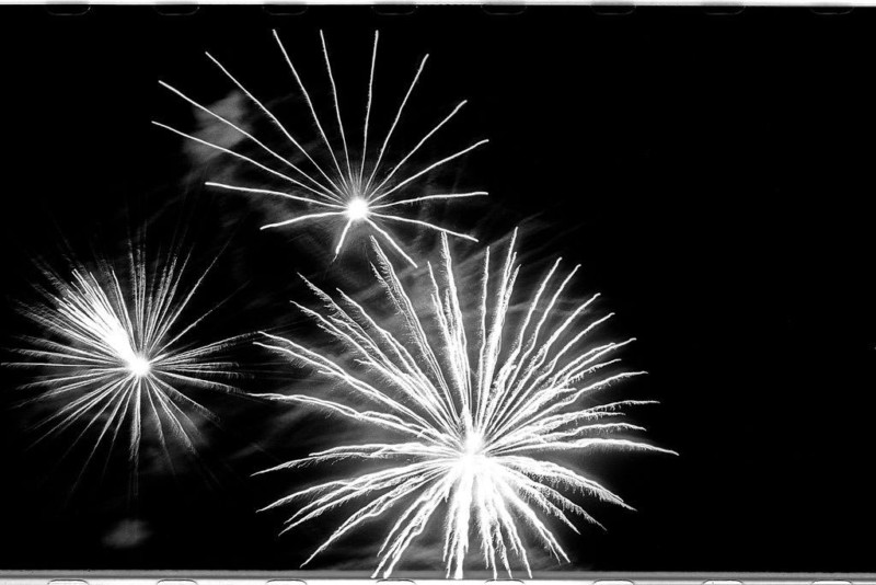

My shutter was already set to bulb from loading the camera and I kept it there. When shooting fireworks, same as I did with my Fuji Instax Neo 90 a few years ago, the idea is to open the shutter while the firework is in ascent to give you an image of its trail and not to close the shutter until after it has exploded fully.
Exposure time does not have to be exact with print film. Shutter speed becomes more of a matter of what you want in the image. Sometimes I’d open the shutter after the ascent, during the explosions. Sometimes I’d open the shutter during the falling cinders. I would guess most of my shutter times were between 5 and 10 seconds, but who’s counting?
And I didn’t use a tripod. I wanted to move freely. And also I was curious to see how the small, lightweight Leica without a flipping mirror would handle without formal camera support. As I released the shutter, I held my breath and tried to hold the camera tight against my face/head and arms as rigid as possible but I guess that wasn’t enough.
Notice the wiggly trails? That is the camera shake. Those lines would have been faithful to their paths had I just used a tripod. I guess I was pressing my luck by using a short telephoto, bulb shutter, and no sticks, but you know, there are no rules. There’s nothing inherently wrong with wiggly lines in firework photos, it’s just a different result than what is conventionally desired. And I’m happy with these, though I may bring my Leica tabletop tripod next year!
I processed the Tri-X in HC110b as I usually do and when I pulled the negatives from my Patterson tank, they were bursting with tone and depth! Once digitized on my flatbed, I had plenty of room to play with levels in Photoshop. I brought my black point in pretty generously and then burned highlights until surrounding midtones were also near black. Not only did this bring out a lot of detail in the highlights but it gave the scans a crispy punch that they were lacking before burning.
In black and white, rather than ubiquitous color, these fireworks images take on a bit of an abstract quality that I quite enjoy. There’s something old fashioned about them yet I feel that they are also sharp and contemporary.
