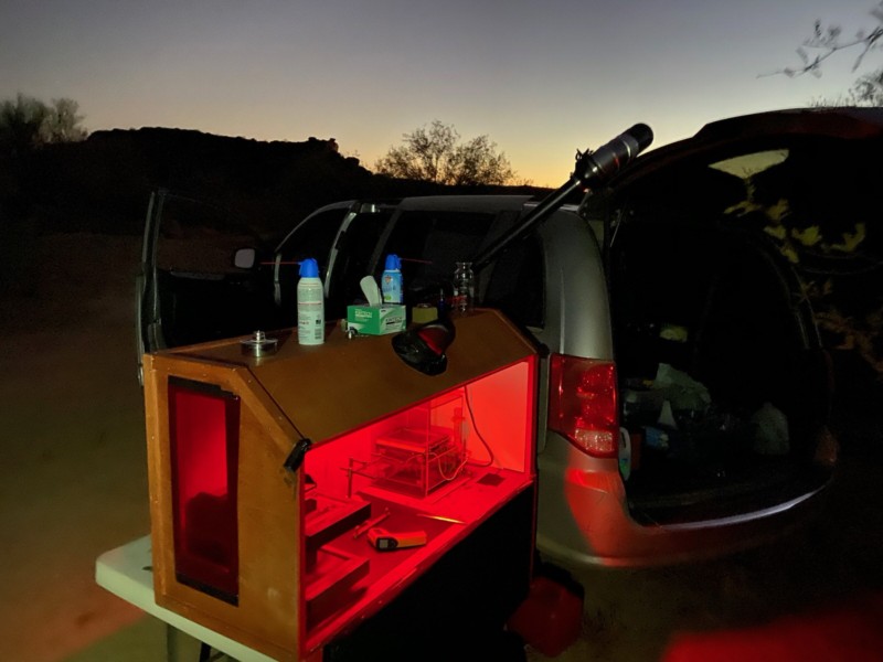

I set up in such a way as to have the most shade possible for my dark box and working table but had to move the car and reconfigure once a day because as soon as even some sun would reach the box, it would heat up to past 100°F. Midday in the shade it was still 90° though, so fuming times and ratios had to be adjusted with every plate.

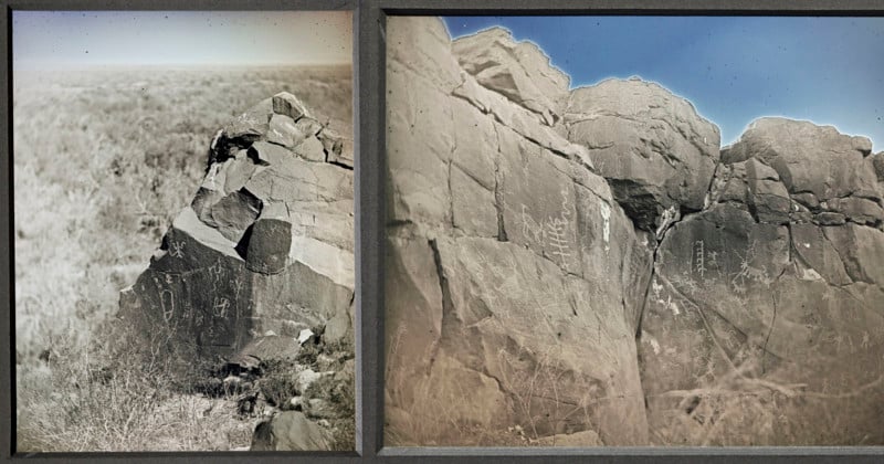

I fixed and gilded the plates after getting back home. Thankfully I was reminded that this can indeed be done by a good fellow daguerreotypist because gilding on location is a sure sign of begging for major trouble. I selected the following 5 that spoke strongest to me. Two plates are of the same composition; these were made with the Harrison, utilizing different aperture discs in order to have less or more depth of focus.
Dark box at dusk, petroglyph cliff in distance.
Plate 1, Dallmeyer 1aa
Plate 2, Waterbury Single Achromat
Plate 3, Harrison Petzval f16
Plate 4, Harrison Petzval f5.6
Plate 5, Harrison Petzval f16
