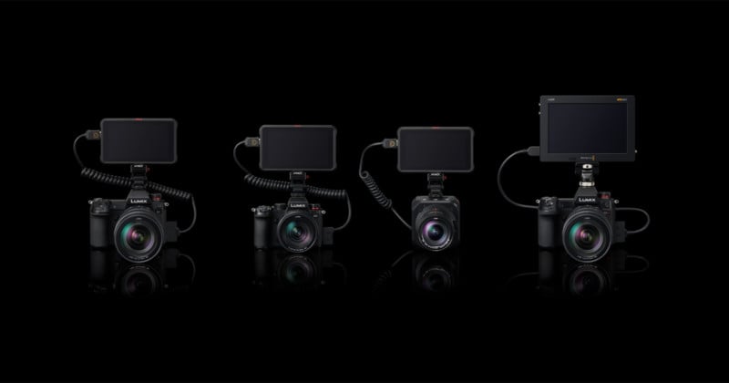

Panasonic has announced firmware updates for the S-series cameras that are set to improve and enhance the performance of the cameras. The updates are video-focused and bring the most features to the S1 and S1H cameras such as Blackmagic RAW support for the S1H and 6K recording to the S1.
Panasonic S1H
In addition to Apple ProRes RAW recording — which is already supported — the S1H complies with 5.9K RAW video data output and recording as Blackmagic RAW on Blackmagic Video Assist 12G HDR. Panasonic says that this is an industry-first for a full-frame mirrorless camera (as of March 18, 2021).
The update will allow for 12-bit RAW capture in full-frame 5.9K (5888×3312) at 23.96p/25p,29.97p, as well as cropped Super35 4K (4128×2176) up to 59.94p. Anamorphic 3.5K (3536×2656) up to 50p is also supported.
Panasonic says that by adding this second alternative for RAW video workflow, the S1H is more flexible for a wide range of use cases. Additionally, with this update, you can choose to add or not to add camera orientation information in vertical orientation to prevent unintended image rotation in playback, and power save mode can be selected while powered with an AC adapter.

RAW video data output over HDMI function
- [5.9K] / [4K] / [Anamorphic (4:3) 3.5K] 12-bit RAW video data output can be output over HDMI.
- Apple ProRes RAW can be recorded on Atomos NINJA V.
