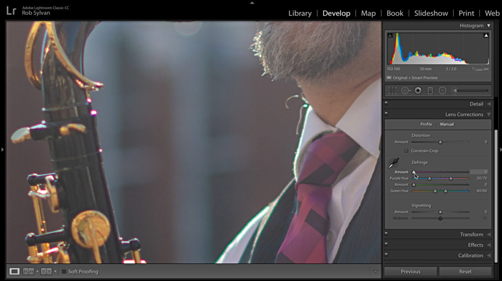

Here’s how it works. This photo has some serious CA issues with both green and purple fringing. Luckily we can address those issues with the tools in the Manual tab of the Lens Corrections panel as Scott demonstrated in the above linked video (go check it out and come back). However, you may also notice that in my photo, the musician’s tie is a very similar color to the fringe we need to remove. Here’s the before photo.
After making the necessary adjustments to the Defringe sliders I’ve vastly improved the CA problem. However, his tie paid the price (notice the especially desaturated edges). That is an unintended casualty.
Luckily there’s an easy fix. Grab the Adjustment Brush and zero out all sliders to start. Then dial in -100 Defringe, and paint over the area of the photo where you want to remove the Defringe adjustment we just made.
All that matters is that you don’t paint over the problem edges where the CA was, so feel free to use the Graduated or Radial filters if they work better in a given photo. This way we can erase that Defringe adjustment from similar colors to our fringe.
