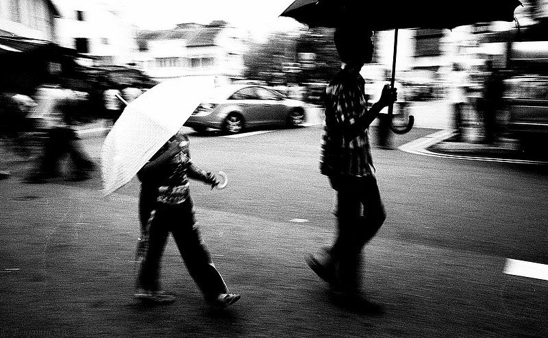

how bout this?
m4-p, elmar 50 2.8, tri-x 400, it was accidentally underexposed, d76 1+1 at room temperature, (can't really remember, but it's about 10-11 mins compared to 9.75mins if develop at 20 celcius)
could be underexposed too since it's almost rain in the evening
