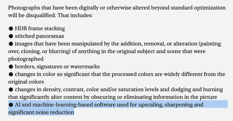

In practice, you don’t really think about this and to the end-user, it does just look like original details being cleaned up and brought out because it works so well (most of the time). However, organizations like the National Audubon Society, which just hosted the 2021 Photography Awards Contest, recognize the difference and specifically did not allow “AI and machine-learning-based software used for upscaling, sharpening and significant noise reduction.” In a sense, it can be argued that the final edited images from AI noise reduction software are composites.
Audubon 2021 Photography Awards Contest rules.

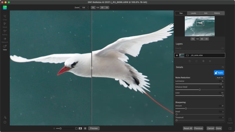

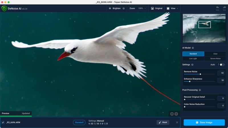

Opening each program, both have a similar layout in default settings. The photo being processed is oriented on the lefthand side, the main toolbar panel is on the right, and there are more information and tools on the top and bottom.
ON1 NoNoise AI
Topaz Labs DeNoise AI
As far as looks go, ON1 NoNoise AI is by far superior with its minimal use of color. Topaz Denoise AI on the other hand tries its best to skew your color perception by maintaining a blue color palette throughout the program — a big no-no for the editing process.
Both allow color changes to the preview background color but, for the most part, this is never seen unless your zoom is backed out all the way and it also doesn’t affect the panels surrounding the photo. ON1 goes a step further to provide a customizable accent color, but this makes a minimal difference to anything.

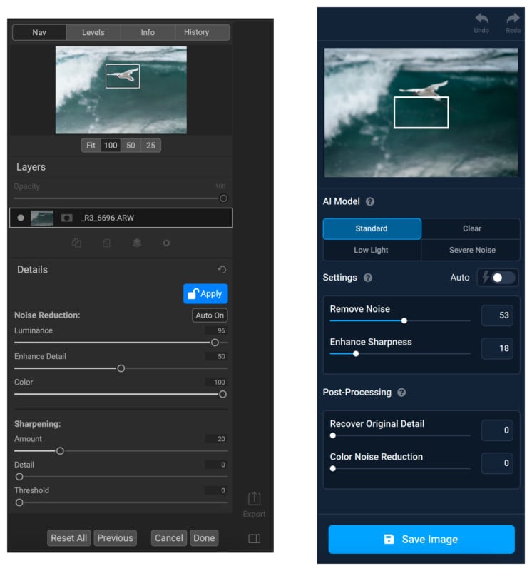

Looking at the main tool panels, we see a general similarity in that there are tools for noise reduction and tools for sharpening.
ON1 NoNoise AI on the left, Topaz Labs DeNoise AI on the right.
Topaz Labs has an additional AI Model section that has four options: Standard, Clear, Low Light, Severe Noise. Standard would be for your regular photos with low to moderate noise. Clear uses an older Topaz Labs noise reduction engine and does not rely on AI as much, and this mode is good for times when you see a lot of inconsistent noise reduction and artifacting introduced by the AI models. Low Light and Severe Noise kind of sound like they’d be targeting the same thing, however, if your final photo is meant to have a lot of dark spaces it might be best with Low Light.
While Topaz Labs has one slider for noise reduction and one slider for sharpness at the heart of its program, ON1 has three sliders for both and allows for more refinement, which is greatly appreciated. It’s more hands-on, but also more time-consuming. Both have Auto toggles which are handy to get a suggestion on where to start with the sliders. From my long experience with Topaz Labs, I know that sometimes the Auto suggestion is completely off base, but it usually will speed up the process.

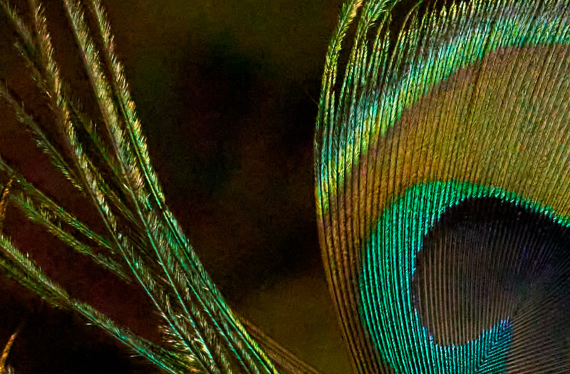

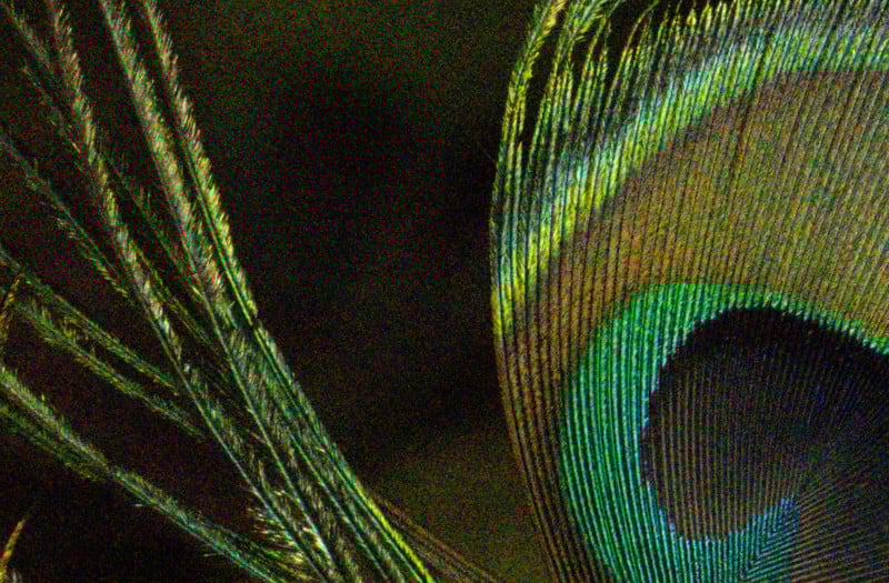

For example, below is a photo taken with the Sony Alpha 1 at ISO 25,600.
Photo processed with Topaz Labs DeNoise AI.
Photo processed with ON1 NoNoise AI using the Color slider to neutralize the magenta cast seen with Topaz Labs.

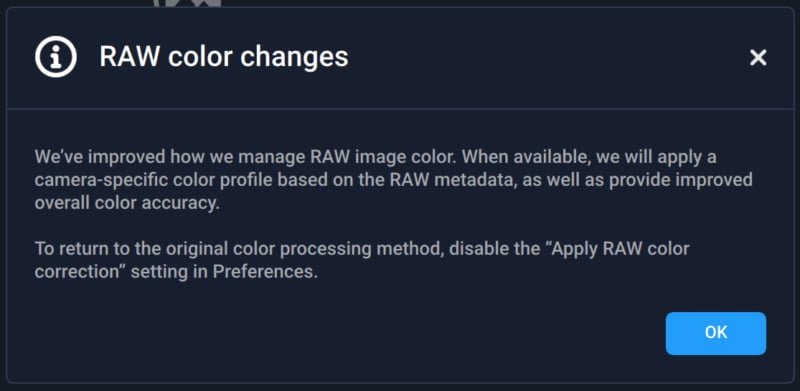

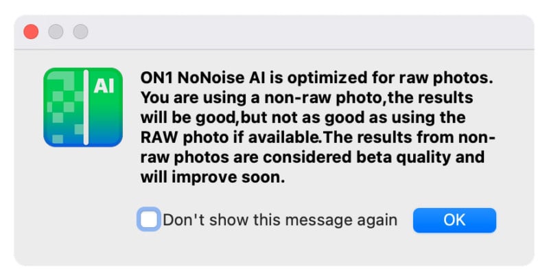

The suggested workflow for each program differs in that ON1 NoNoise AI prefers to work off of original RAW files whereas Topaz Labs DeNoise AI is mostly set up to take processed files. Topaz Labs just released version 3.2 which supposedly includes improvements to the RAW color processing, however from what I could see comparing v3.1 and v3.2 was a lens profile correction and that’s all. As for ON1, when you try to import a non-RAW file, there’s a pop-up message that says, “results from non-RAW photos are considered beta quality and will improve soon.”
Topaz Labs DeNoise AI version 3.2 release notes.
ON1 NoNoise AI pop-up message.
Topaz Labs easily wins here, as it is more flexible and leverages programs like Capture One to do a far better job at the RAW processing. ON1’s logic is that noise gets introduced during the demosaicing stage of RAW processing and therefore they can get to it at the source. What’s lost, though, is the incredible color processing and RAW-level adjustments from programs like Capture One that aren’t the same at all after ON1 outputs a converted DNG.

What I found here was that I was able to get more fine detail out of Topaz Labs with this comparison. However, ON1’s Color slider was able to do away with the high ISO color cast happening in the image.
