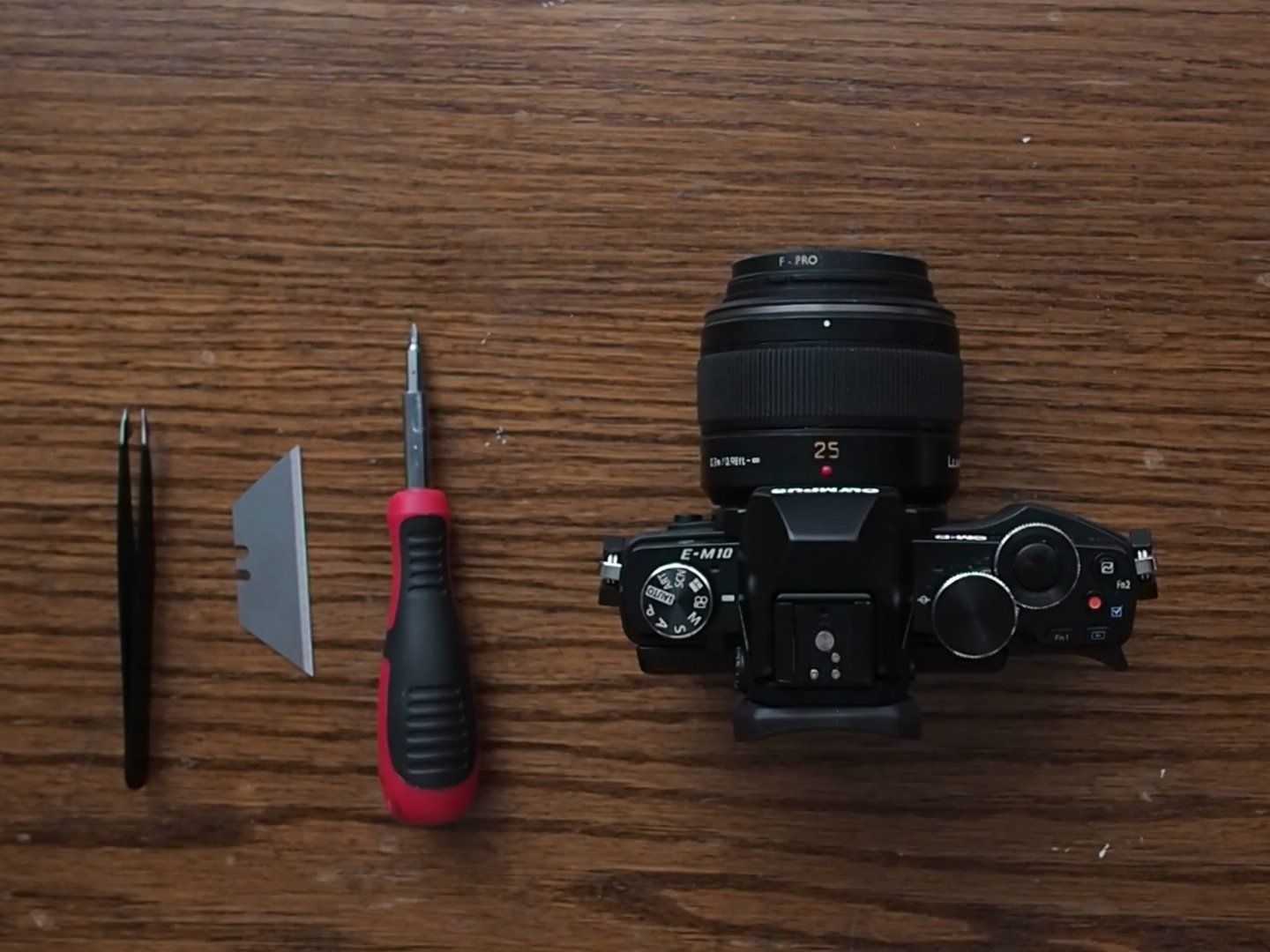

This is business and the fact that after opening up camera it will not look like new.I still have em5 unrepaired after disassembly myself. Look at this disassembly and understand why olympus is not willing to do this work..it's not worth their time even for independent or freelance repairers. You will understand why it is so when you look at this diassembly tutorial.
At least all you have to do is replace the sd card holder but it is not for the faint hearted or inexperienced person who have no knowledge of electronics. Opening up is easy but the organisation of the various sizes of screws need careful planning and execution.
