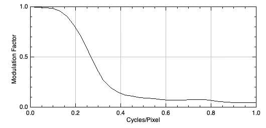

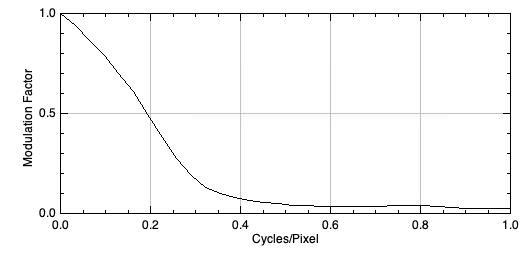

One way to compare two optical systems’ performance is to look at the Modulation Transfer Function (MTF) which measures the change of contrast versus spatial frequency. Using the same lens, same tripod, same light, and same aperture, we measured the MTF for the D850M versus D850 in 8-bit JPG. Even at 8-bit JPG, the MTF difference is huge.
Here’s the monochrome MTF:
Here’s the color MTF:

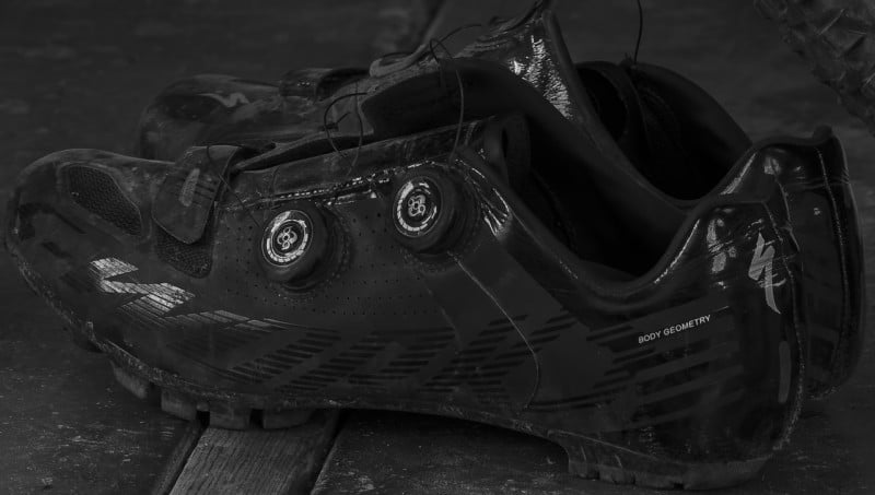

Let’s take a look beyond test charts since most of us are shooting real-life subjects.
Suppose you wanted to take a picture of a shoe. I don’t know why you would, but I did say ‘suppose’.

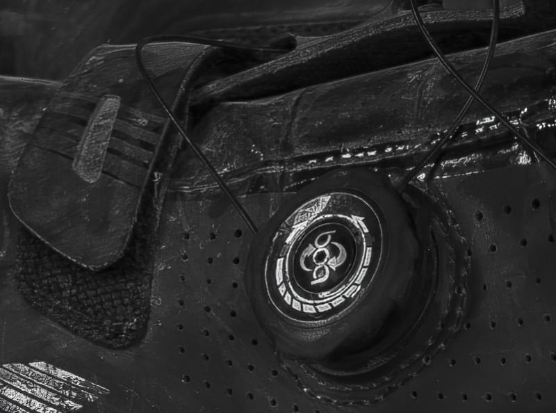

100% crop. That greyscale has some soul!
