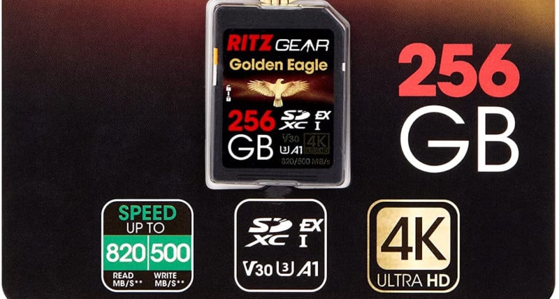

Ritz Gear is currently offering a brand new SD Express memory card that it promises boasts up to 820 MB/s read and 500 MB/s write speeds for $300. In real-world use cases, it will never come close to these promises and it says so right on the box.

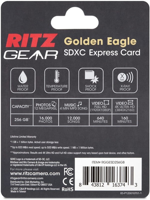

What’s even more baffling is that, on the box, Ritz basically admits that this card cannot hit the promises it claims. Even if someone, somehow was able to tap into the maximum potential of this card (which I want to reiterate is not currently possible with any camera on the market without exception), the actual performance rating this SD Express card has is pitiful.
All SD cards come with a set of letters and numbers that most average consumers probably don’t understand, but do reveal a lot about a card. This Ritz Gear SD Express card is rated as an SDXC, EX I, V30, U3, A1. Let’s break that down.
- SDXC: This stands for “Secure Digital eXtended Capacity,” which just means that the card format can be up to 2 TB and is only required to hit a maximum speed of 104 MB/s.
- EX I: This is a first-generation (I), SD Express (EX) memory card.
- V30: This is where it gets interesting. The V30 specification means this card can only sustain a maximum of 30MB/s, which isn’t particularly fast. So while Ritz Gear claims some very high peak speeds, the card can only actually sustain 30 MB/s, which is only enough for low bitrate 4K video and is currently found on UHS-I and UHS-II cards, the specification that Ritz claims it is multiple times faster than.
- U3: This is basically a repetition of the V30 note, and quantifies the same sustained data rate but is not specific for video.
- A1: This is the “Application Performance Class” which denotes a card’s minimum random read and write speeds as well as its minimum sustained sequential write speed. This was added to support devices like phones and tablets where data is recorded at random intervals instead of how like a camera records data, which is sequentially. Since no phone or tablet accepts SD Express, it’s a meaningless label, in this case.

So notwithstanding the egregiously misleading nature of SD Express, Ritz Gear admits on its own packaging that the real-world usability of its claims are false. The packaging and marketing of this memory card is specifically designed to mislead, lie, and take advantage of people who just don’t know better. Unfortunately, it appears to be working.
