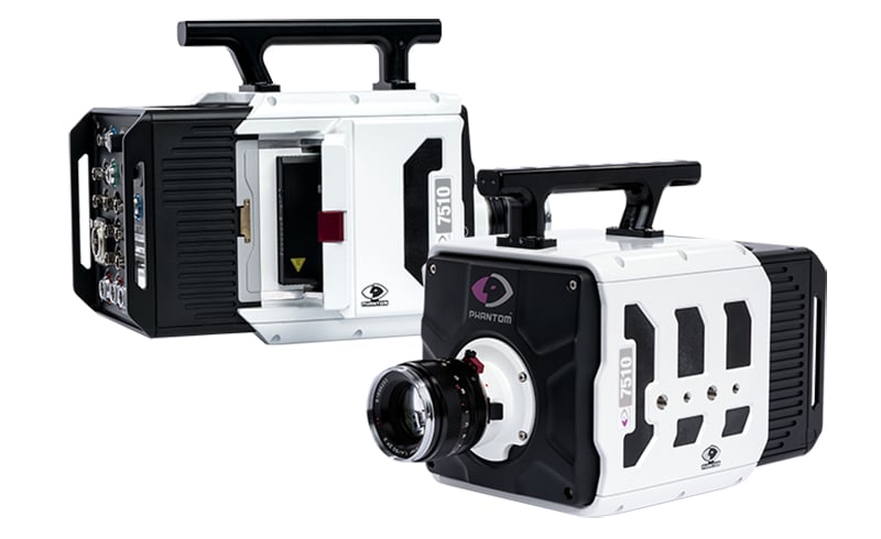

Vision Research, the company behind the Phantom series of high-speed cameras, has announced the Phantom TMX 7510 and 6410 which are its first to utilize backside-illuminated sensors. The TMX 7510’s 75-gigapixel throughput can provide an incredible 1,750,000 frames per second.

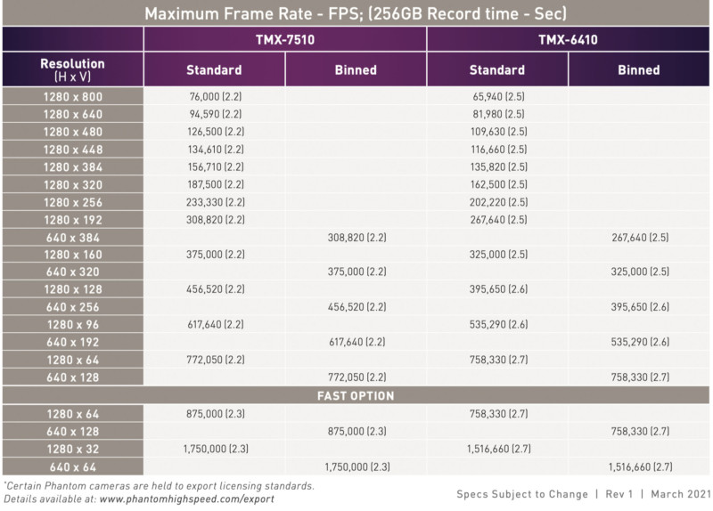

The TMX 7510 can reach that 1.75 million frames per second mark at a resolution of 1280 x 32. Below is a full chart of performance.
As seen above, the camera can capture in “standard” or “binned” modes. The TMX Series offers 2 x 2 binning for high frame rates to provide users field-of-view flexibility. For example, the TMX 7510 can achieve over 617,000 frames per second at a resolution of 1280 x 94, or a resolution of 640 x 192 in binned mode.

The TMX 6410 has the same BSI sensor found on the 7510 and has similar features but at a lower maximum framerate. While the TMX 7510 can capture 76,000 frames per second at its 1 MP resolution, the 6410 can do the same resolution at 66,000 frames per second. Additionally, the TMX 6410 has a maximum framerate of 1,500,000 per second compared to the 7510’s 1,750,000 per second.
The standard lens mount for both of the TMX-series cameras is Nikon F-Mount and includes aperture support for Nikon G lenses, but Canon EF, C-mount, and M42-mount options are also available. No pricing or date of availability for either camera was mentioned at the time of publication.
