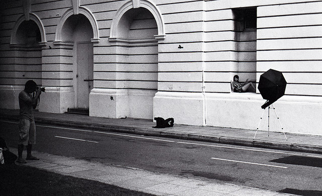

Have been noticing strangely uneven under-development in my recent pics, usually occurring at the left side of the image..
The problem only happens on random shots, with the rest of the roll perfectly fine.

Here are some of the problem pictures:
What do u guys think is the problem? appreciate it.. ;)
Looks like shutter capping, probably to do with the tension of your shutter curtains, causing it to have a dark banding on the side. You may need to get it calibrated.
have the same problem with high speed so my guess is also due to the capping of the shutter. understand that exercising the shutter at the speed can help.
