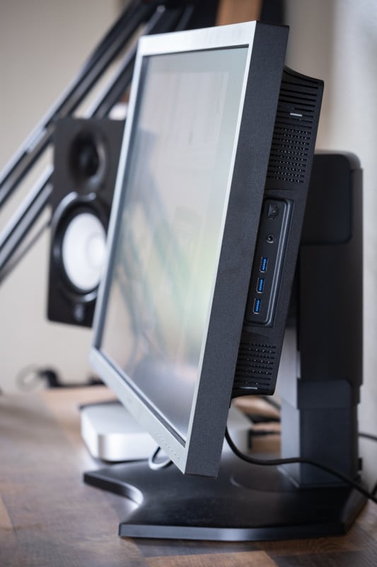

The third and final bit of design that adds to the professional vibe is the input/output (I/O) selection, which is substantial. The PA311D boasts a total of five ports that can carry a 4K/60p 10-bit video signal: two DisplayPort 1.2 ports, two HDMI 2.0 ports, and one USB Type-C port with DisplayPort protocol that also features 65W charging. You also get a headphone jack and a USB Type-A hub with two upstream ports on the back of the device and three downstream ports on the side of the monitor. The USB Type-C port also acts as an upstream.
Notably missing is any sort of media card slot, but given the target audience, the omission sort of makes sense. If you’re at the point where you’re spending $3,000 on a monitor that was tailor-made for photo editing, you probably have your media ingestion workflow dialed in already.

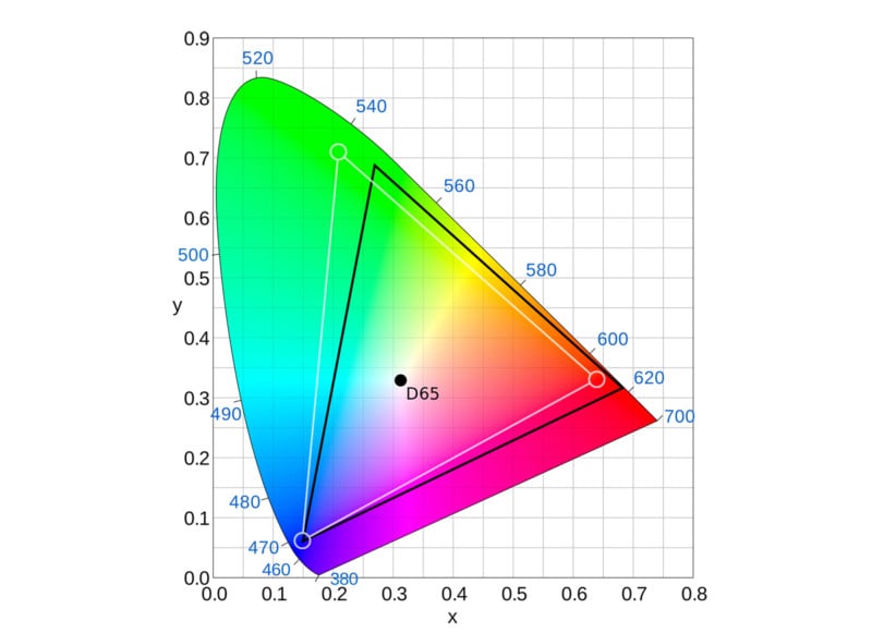

As NEC’s flagship, the PA311D does its best to cover both the DCI-P3 and AdobeRGB color gamuts, reaching an impressive 97% coverage of both when you set the profile to “full,” meaning the full panel gamut. This is difficult to do because of how the AdobeRGB and DCI-P3 gamuts are arranged in color space. Take a look at the CIE 1931 diagram with both color spaces represented by the white triangle (Adobe RGB) and the black triangle (DCI-P3):
In order to cover both of these, the display’s native panel gamut must be a triangle that is large enough to encompass both of the smaller triangles inside of it. This is why most monitors pick one or the other: monitors that cover exactly 99-100% DCI-P3 only cover about 84% of AdobeRGB, and monitors that cover exactly 99-100% of AdobeRGB only cover about 85% of DCI-P3.
The NEC MultiSync PA311D does its best to give you the best of both worlds, but it sacrifices a tiny bit from both color spaces in order to do so.

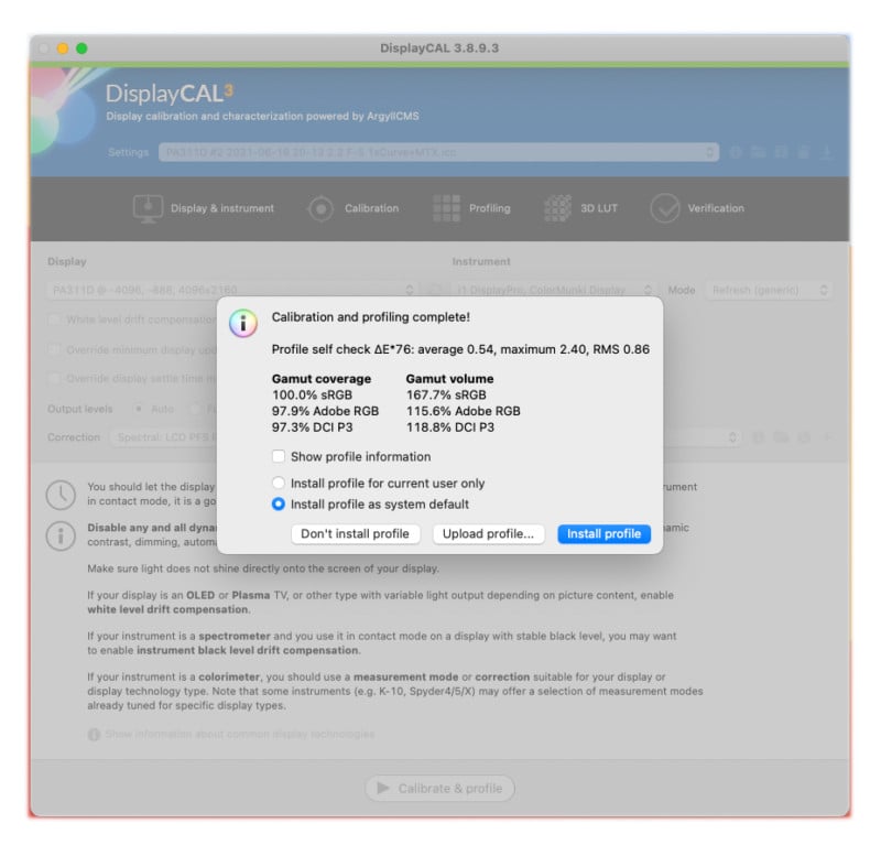

In our testing using an i1Display Pro Plus and the DisplayCAL software, we found that our review unit covers 97.9% of the AdobeRGB gamut and 97.3% of DCI-P3, all at a maximum Delta E 2000 of 1.26 with an average of just 0.3. Anything below a Delta E of 2 is considered invisible to the human eye.
This is excellent, and something you’ll rarely find in a monitor that costs less than $5,000.

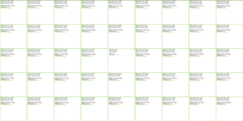

This standard of excellence extends to uniformity performance as well. We performed a laborious 9 x 5 patch test using DisplayCAL’s uniformity assessment and found that 42 of the 45 patches passed the recommended tolerance, with the remaining 3 patches drifting only slightly and passing “normal” tolerance.
With so much screen to try and light evenly, uniformity like this is phenomenal (click to view the full resolution PNG):
