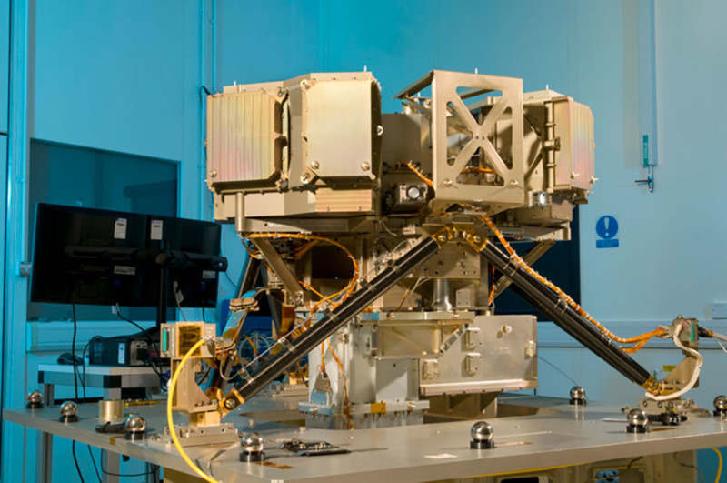

The Webb MIRI imaging unit
This portion of the MIRI instrument, seen here at the Rutherford Appleton Laboratory in the U.K., contains the infrared detectors. The cryocooler is positioned far from the detectors because it operates at a higher temperature. A tube carrying cold helium connects the two sections. | Credits: Science and Technology Facilities Council (STFC)

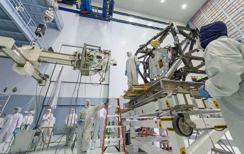

NASA Webb Telescope MIRI
MIRI (left) sits on a balance beam at Northrop Grumman in Redondo Beach as engineers prepare to attach it to the Integrated Science Instrument Module (ISIM) using an overhead crane. ISIM is the heart of Webb and holds the telescope’s four science instruments. | Credits: NASA/Chris Gunn; Text Credit: NASA/Laura Betz

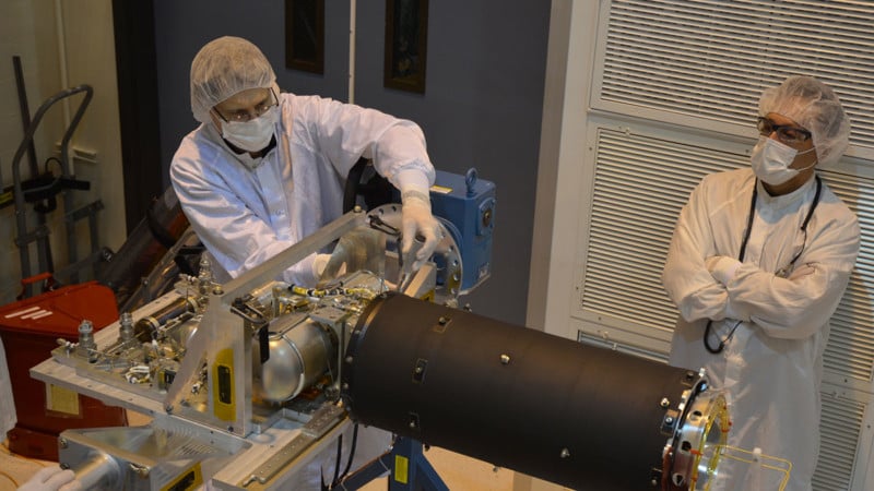

Webb telescope's MIRI cooler
JPL flight technicians Johnny Melendez (right) and Joe Mora inspect the MIRI cryocooler before it was shipped to Northrop Grumman in Redondo Beach, California. There, the cooler was attached to the body of the Webb telescope. | Credits: NASA/JPL-Caltech
“Those different regions are led by different organizations or centers, including Northrop Grumman and NASA’s Goddard Space Flight Center, and we had to interface with everybody. There’s no other hardware on the telescope that requires that, so that was a challenge unique to MIRI. It’s definitely been a long road for the MIRI cryocooler, and we’re ready to see it perform in space.”

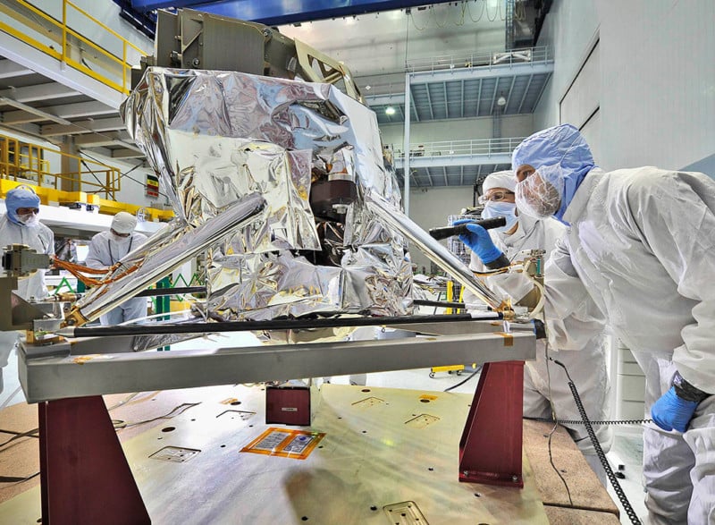

Header image: Engineers conduct a “receiving inspection” of the James Webb Space Telescope’s Mid-Infrared Instrument at NASA’s Goddard Space Flight Center after its journey from the United Kingdom. | Credits: NASA/Chris Gunn
