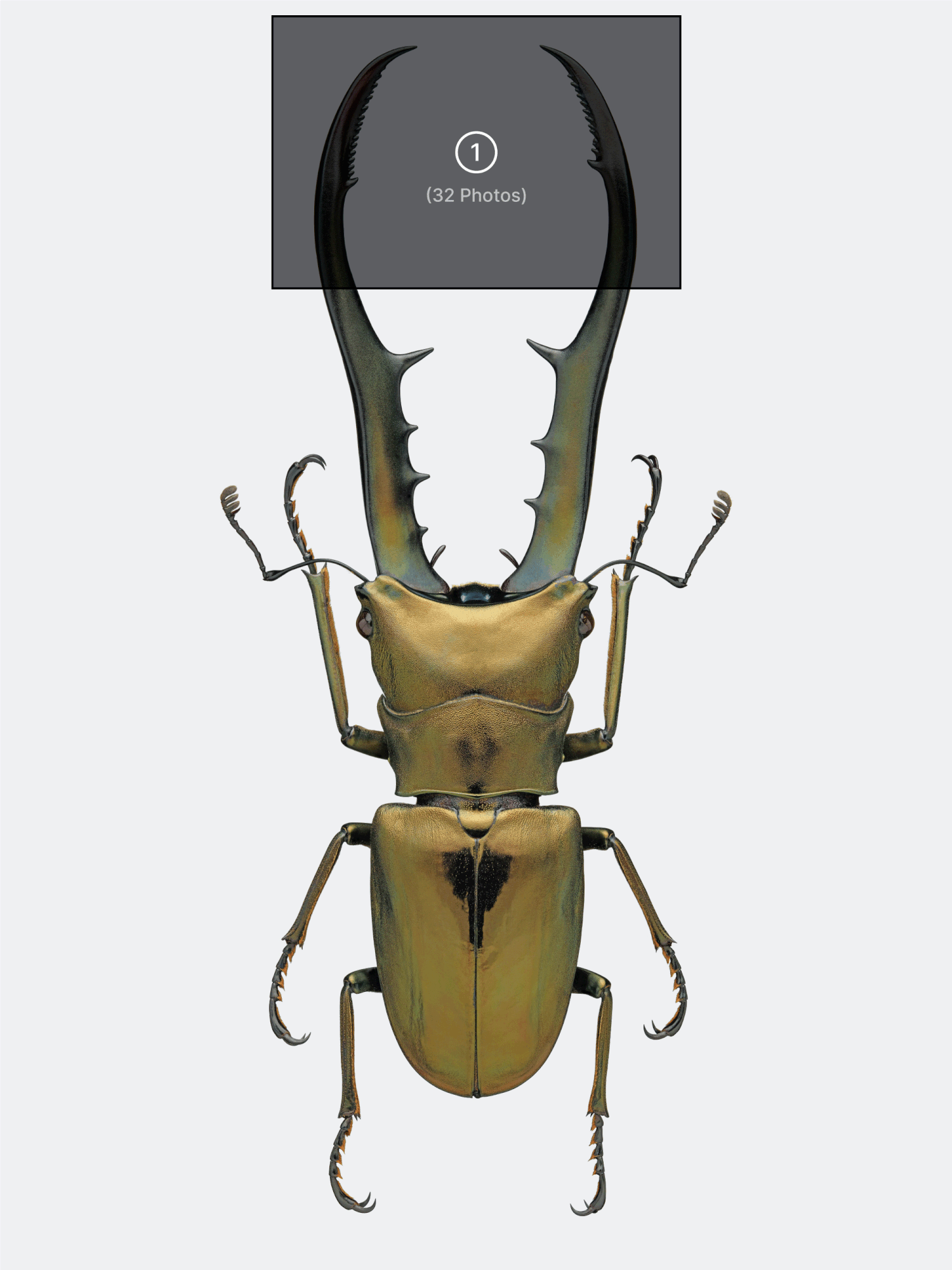

One of the great things about macro photography is that it doesn’t have to take up a ton of space. I live in a studio apartment and my entire setup fits along my kitchen bar top. The challenge, though, is that when taking photographs at such close distances, only a little slice of each photo is actually in focus. Since I want the entire bug to be in focus, I use a technique I call “micro panoramas”.
The objective is to walk away with a sharp photo of every nook and cranny of the insect. This means dividing the insect into several sections to photograph, and taking dozens of photos of each section to ensure every detail is in focus. Afterward, I’ll combine them all together to have one large, sharp image. This print contained a total of 635 photos.

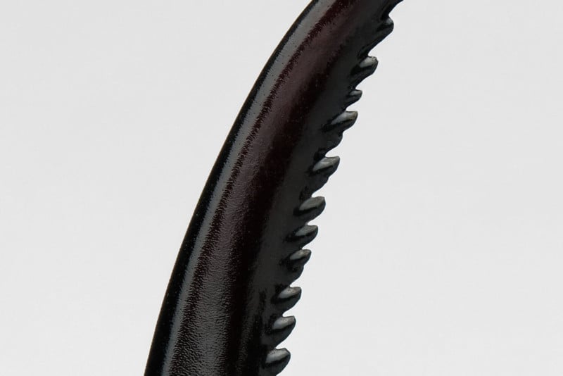

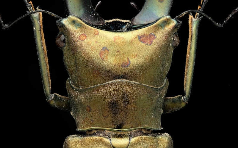

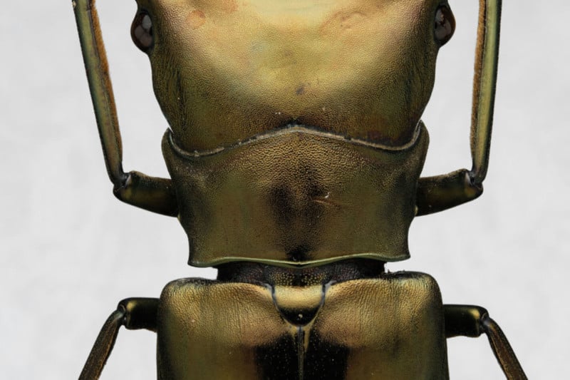

This step also reveals a whole new level of dirt and dust! At this point, we have no choice but to open Photoshop and meticulously remove thousands of individual particles one at a time. It’s a crucial step as you can see by looking at our giant stag beetle’s mandibles below. With all of the dirt, dust, and oil stains out of the way, the entire focus of the photo can now be on the natural beauty of the insect.
Here is a comparison of the beetle in his original condition compared to the completed image. With all of the dirt, dust, and oil stains out of the way, the entire focus of the photo can now be on the natural beauty of the insect.
Original
Completed
Look at the difference a nice digital scrub can make.
Here’s the final image compared to the beetle’s first unpacking. What a transformation.
