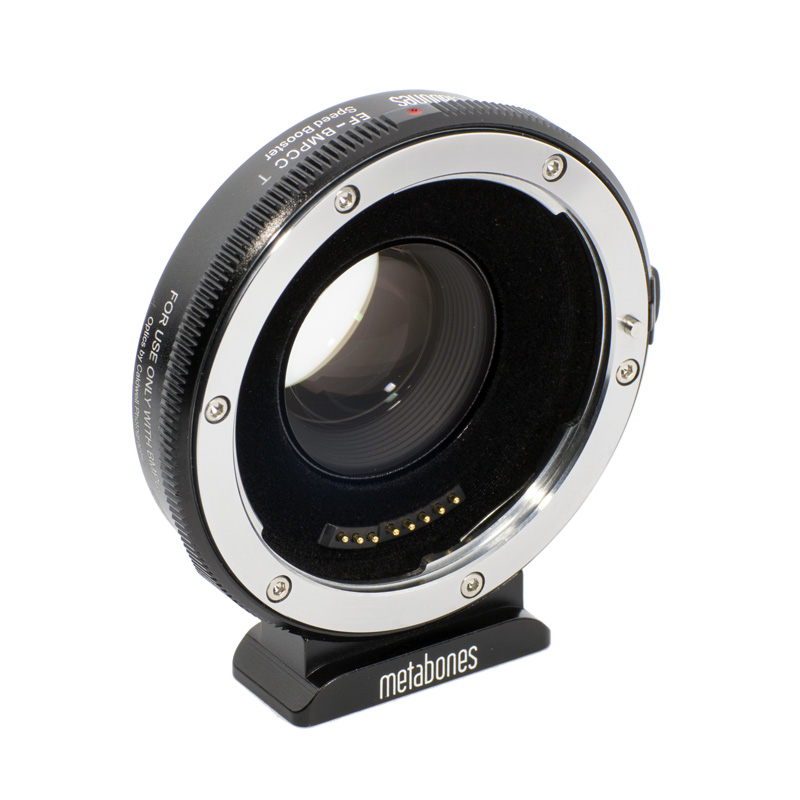

The Metabones EF-M43 speedbooster for BMPCC also works with the BMMCC, reducing the crop from 2.88x to 1.75x

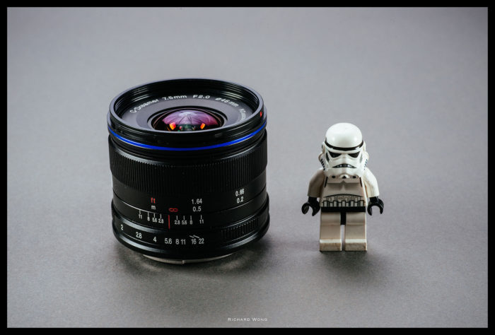

The 2.88x crop of the BMMCC used to mean that ultrawide lenses are hard to come by. But thanks to new entrants like Laowa's 7.5mm f2 M43 (effectively 21mm on the BMMCC) this issue is now moot.

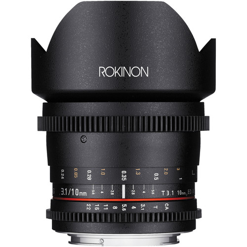

For those who don't mind a little bit more heft, the Samyang 10mm T3.1 EF mount mated with the Metabones speedbooster gives a whopping 17.5mm angle!
