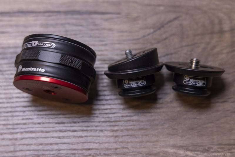

Below is the Move:
The Move catcher on the left, followed by the two plate options in the middle (for the Gimboom and legs combination) and right (for general system uses).
As you can see, it’s not a particularly large device. It’s only 2.36-inches wide by 1.18-inches tall and weighs a scant 220 grams (7.8 ounces). It’s made entirely of metal (specifically, machined aluminum combined with hard anodizing for high-durability), so it’s robust and strong enough to handle the rigors of repeated use on set, where tripods and other stabilization accessories generally take a beating.
The Manfrotto Move is ingenious in its simplicity. The larger “catcher,” which I like to call the puck, screws into place on the base of a tripod, on a slider, or on a monopod and boom. The quick-release plate can then screw into place on the base of a tripod head, on the bottom of a slider, onto the bottom of a timelapse machine like a Syrp Genie, or even on the base of a gimbal. Basically, if it accepts a 3/8″-16 screw, the puck can attach to it (it comes with a 1/4″-20 adapter screw as well) and the plate fits on anything that takes 1/4″-20. The system is able to support a payload of 44 pounds, which is way more than most will need.

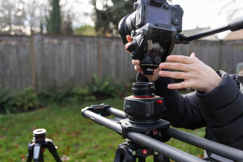

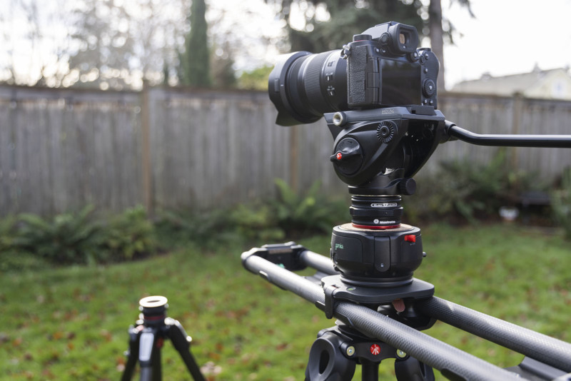

When I ran my production company in San Francisco, we would regularly be tasked with capturing video footage, timelapses, and photos for jobs. That would mean multiple cameras, tripods, and plates that needed to continuously get swapped and moved around, and it also meant we had a lot of redundant parts. I had two or three fluid heads per shoot, for example, because I needed two on tripods for interviews and another on a slider for B-roll. On top of that, we would use the same slider to capture timelase footage, which meant we would be screwing and unscrewing heads from the same slider multiple times in the same day.
If that sounds confusing, it’s because it was, and it was a major pain to do all of this and make sure we didn’t forget to screw something tightly into place — which definitely happened on a few occasions.

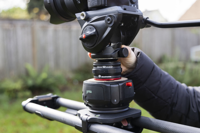

If I had the Move back then, I would be able to dramatically simplify my workflow. Placing one capture puck on the slider would allow me to swap heads easily. I could use a ball head for my photo camera and then quickly and easily swap to the fluid head for video.

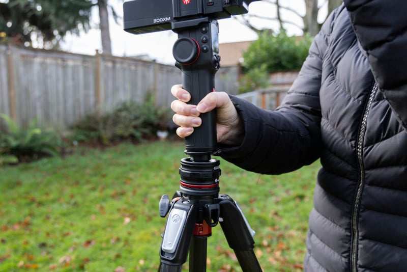

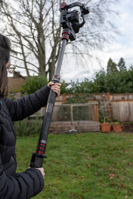

One of my favorite applications of the Move is with a gimbal. Manfrotto recently released what it calls the Gimboom, which is a thick monopod boom arm designed to hold the weight of a camera and a gimbal and go from ground level to an overhead position quickly, adding additional versatility and flexibility with its Gimbal. This lets you get unique, higher angles than you would be able to previously.

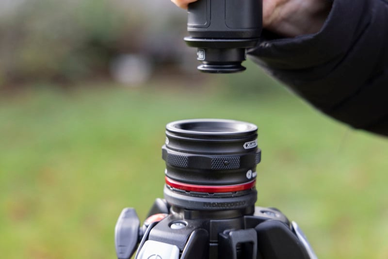

Pulling the Gimbal off a Move QR system catcher attached to a tripod.

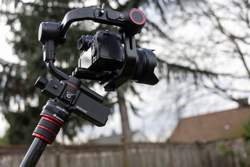

With a catcher on both the end of the Gimboom and on a set of tripod legs, I could pop the gimbal off from the resting position on a tripod and onto the boom to immediately get those angles. When done, I could just set the gimbal back on the tripod where it would be up and out of the way. While Manfrotto’s gimbal and others on the market ship with their own collapsible feet, the Move feels a lot safer. Instead of having to set the gimbal on a table or on the ground (which is, let’s be honest, really common), it can instead sit safely at eye level on the top of a tripod.
Manfrotto Gimbal attached to the Gimboom via the Move QR.

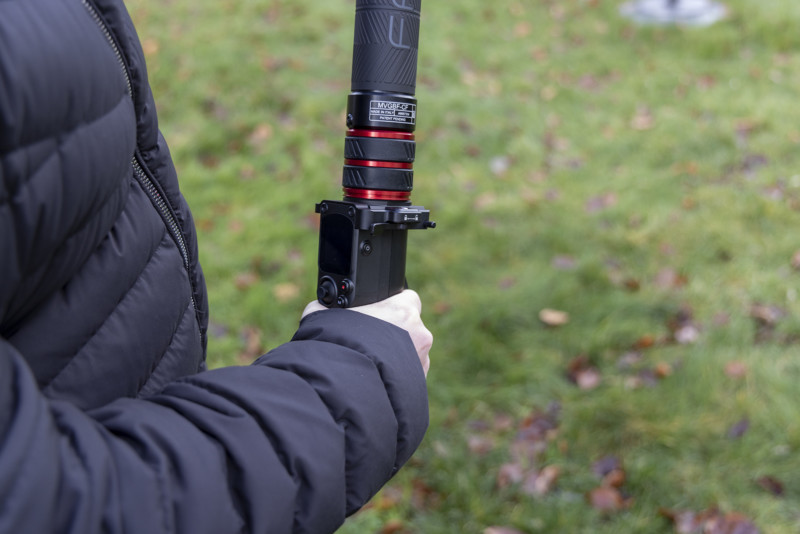

The Gimbal controller attaches to the bottom of the boom and wirelessly controls the Gimbal that is attached to the other end.
Could you do this before? Totally. Was it nearly as fast and easy to get it on and off the tripod? Nope. The Move just makes everything so much easier.
It is also worth noting that Manfrotto’s modular gimbal allows you to detach the handle from the head and use it as a remote control that, thanks to its perfect integration with the Move, lets you set up and use it in additional, useful ways much faster and more easily.

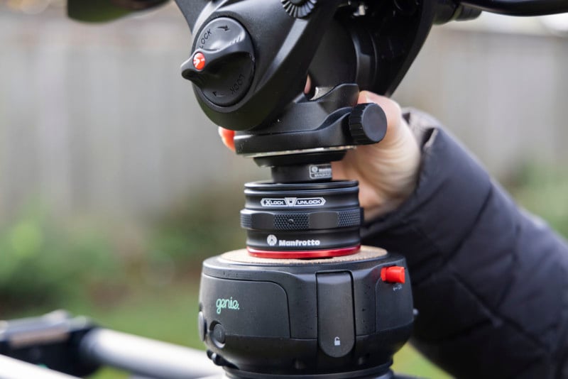

One thing that I was concerned about was if the plate would rotate while inside the catcher and make it difficult to tell if I was using a fluid head or just rotating freely in it. Luckily, the catcher holds the plate securely, and while you can turn it inside the catcher, you have to give it a significant force to do so. Once you do the secondary lockdown twist, however, it doesn’t move at all. Manfrotto says the Move is supported by an “Xlock” feature that increases the rigidity of the entire system when mounted and says that it’s not just a simple accessory but something that can improve the performance of the entire kit. I can’t find any reason to not believe them.
The other concern some might have is an issue my friends and I used to call “totem poling,” which is when gear gets too tall on top of a tripod or slider which can make it susceptible to moving in the wind. The addition of the height from one Move unit isn’t enough to cause this to happen in my opinion, but stacking two or more in a single system might cause this issue to arise. Luckily, the Move is really sturdy so it doesn’t like to flex much even if you get a bit tall.
