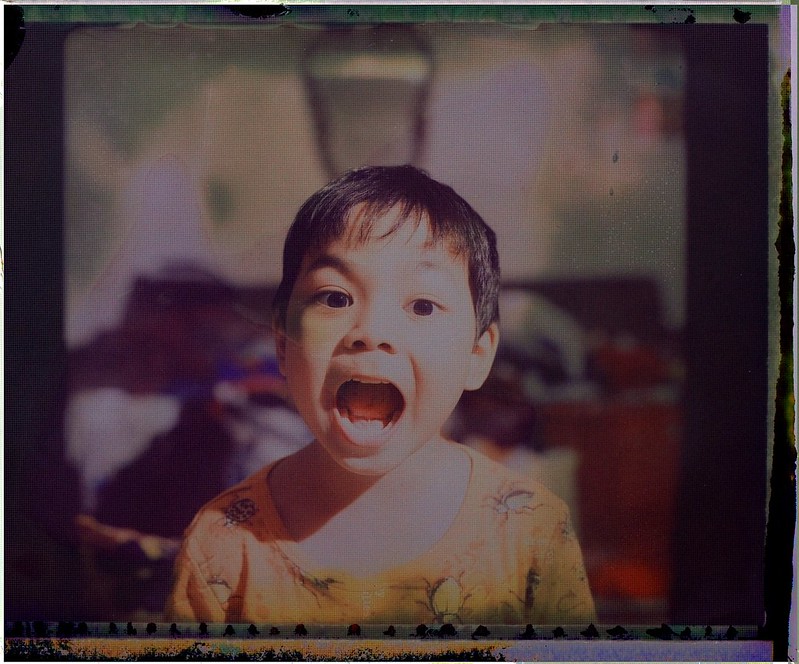

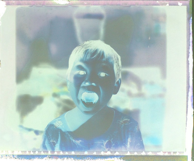

Anyway, here is an image recovered from the polaroid negative snapped with a digicam over my comp monitor.
My scanner was down so improvised this method.
Image recovered by bleaching away the matt surface of the polaroid throwaway peel off with bathroom bleach.
It was shot with the 127mm K/L lens up close for this boy.
Used generic Windows Paint application and inverted the negative to get the positive.

Hi Anuar, recently i try to bleach the polaroid negative (follow the instructuon from youtube) after i bleach and let the water flow on it, it seem like the non bleach bleach part have some chemical (sticky green) fall off. is it normal? thanks
gary
gary
Normally I would tape the edges to a PVC, glass or arcrylic board first prior to bleaching to preserve the negative image from being washed off by the bleach.
After the matt black stuff has been bleached, i'll remove the tape and proceed to wash it like normal film with running water and lightly run my fingers over to remove any residue on both sides.
The gooey green stuff is the image developer, processor and fixer that is spread evenly by the rollers over the negative when we pulled it out.
