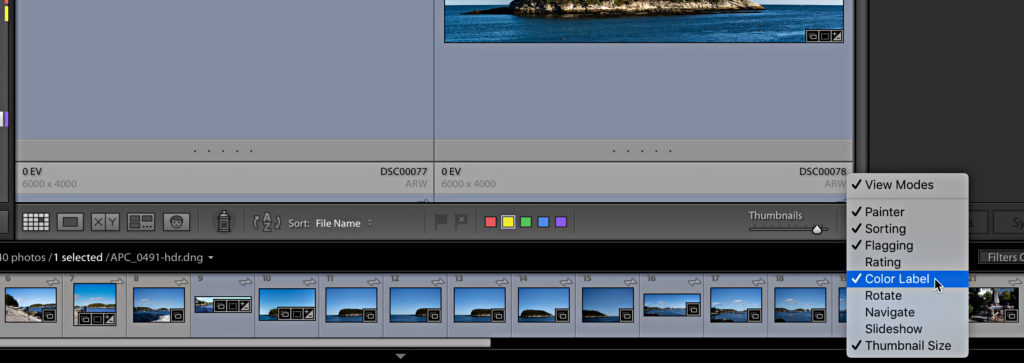

You can apply color labels to photos by selecting the photos in Grid view or Loupe view, and clicking the corresponding color label in the Toolbar (press T if your Toolbar is hidden, and click the disclosure triangle on the right side if the color label icons are missing from the Toolbar). You can also right-click selected photos and choose the desired color label from the contextual menu.
