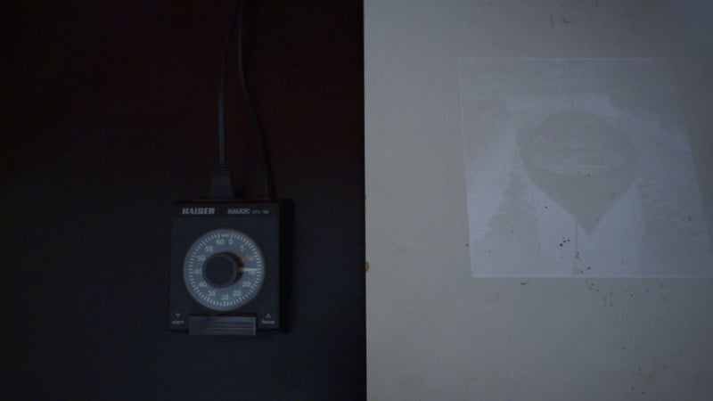

Like many people who still have a darkroom, I’ve bought most of the equipment in the used market. As is the case with such niche markets, you can’t always pick your choice from an endless supply of brands, models, and variations so I went for the best deal I could see, a Kaiser 6002 with several boxes loaded with all kinds of darkroom supplies. The seller was one of the nicest people I’ve met and explained in great detail what I was walking out with. In one of those boxes, there was a darkroom timer.
He had fully explained that it wasn’t the best timer in the world. It would only have two functions, turn the enlarger lamp on and off at my will so that I could focus and upon pressing the countdown button, it would turn the enlarger on for a set amount of time, making an exposure. Except that every now and then it would get stuck (usually around the 15-second mark) and give me an unending exposure, resulting in crushed blacks and grayed out highlights, depending on how late I was to react to the needle getting stuck.
Approaching the zone of doom… or maybe it’ll be fine this time…

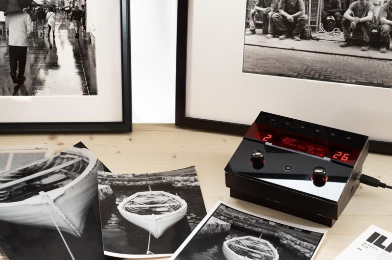

I knew people were already building simple timers using Arduino microcontrollers. So, why not build something far more advanced? It’s a small computer that is available cheaply and is easily reprogrammable. If it handles 3D printers, CNC machines and all kind of silly robots that you can find all over the Internet, how hard would it be to ask it turn a light off and on?
A few seconds after these thoughts, my industrial designer instincts kicked in. “It’s just software in a box”, a voice said from the back of my head. “Just build another box, upload the software and you have a copy that you can sell. If it turns out as good as you imagine it to be, people will buy it”.
Can you hear the people queuing up?
So I went out, bought two Arduino boards, an LCD and assorted lengths of wire and started working with them. Did a whole notebook worth of sketches of both the physical and the graphical user interface. From the start, I wanted to have dials and a few buttons that I could repurpose as I saw fit. It has a screen, after all. I could communicate with the user, telling what each of these dials and buttons does in a given menu or mode. Yet at the same time, I would keep the two most essential buttons serve only one purpose, one to focus and one to expose. No double clicks, no press and hold, no excuses. Press them and they should do their job.
First sketches of the box
Even though having an LCD is nice and informative, I wanted to have another way of displaying the most crucial information, the countdown time and the contrast filter that I’m supposed to use. For that, I added two large displays to either side of the LCD. Shortly afterward it became natural to look at those displays to figure out what I was supposed to do next when making a print; expose for a certain amount of time, replace the contrast filter, dodge or burn a certain area.
Maybe I should have gotten two egg timers. Nah, I’ll just design and build a small computer:
After deciding on the basic design language, I began to design the graphical user interface, all the menus and screens. There were many variations, seemingly good concepts that were abandoned shortly after using them in the real world and seemingly dead ends that made it back somehow into later versions.
One such concept was replacing the LCD with an E Ink display. Would’ve been easy to read under the red safelight and I liked the idea of displaying a clock face on the e-ink display to act as a progress bar. Had to abandon this idea after realizing even with partial refresh, e-ink displays have a very low refresh rate and a very annoying blink when refreshing the whole screen. Shelved the concept without building a single prototype and maybe I’ll bring it back one day but the progress bar idea made it into the next version of the hardware, as a series of LEDs that visualize my progress along the whole print recipe or the current countdown.

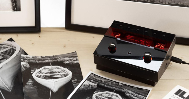

Here’s me making some test strips with F-Stops (don’t have to follow the time display, the progress bar tells me how long it’ll take):

With all my plans set, I could finally launch a crowdfunding campaign. I knew that there’s a great deal of negativity surrounding crowdfunding projects these days, especially in our community thanks to a few projects who have cheated out quite a few people by either overpromising with fancy looking non-working prototypes or cool-sounding concepts that became to no fruition of any kind. With no previous projects of this kind or a bought-and-repurposed brand name that is familiar in the industry, I had to be as transparent as possible. Which meant taking an extra month or two developing the concept into a later stage, shoot a lot of videos, share them around, show MAYA in use for everyone to see and understand.

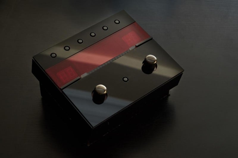

Photo of the first prototype unit
White Edition, has mostly the same capabilities without some of the bells and whistles
