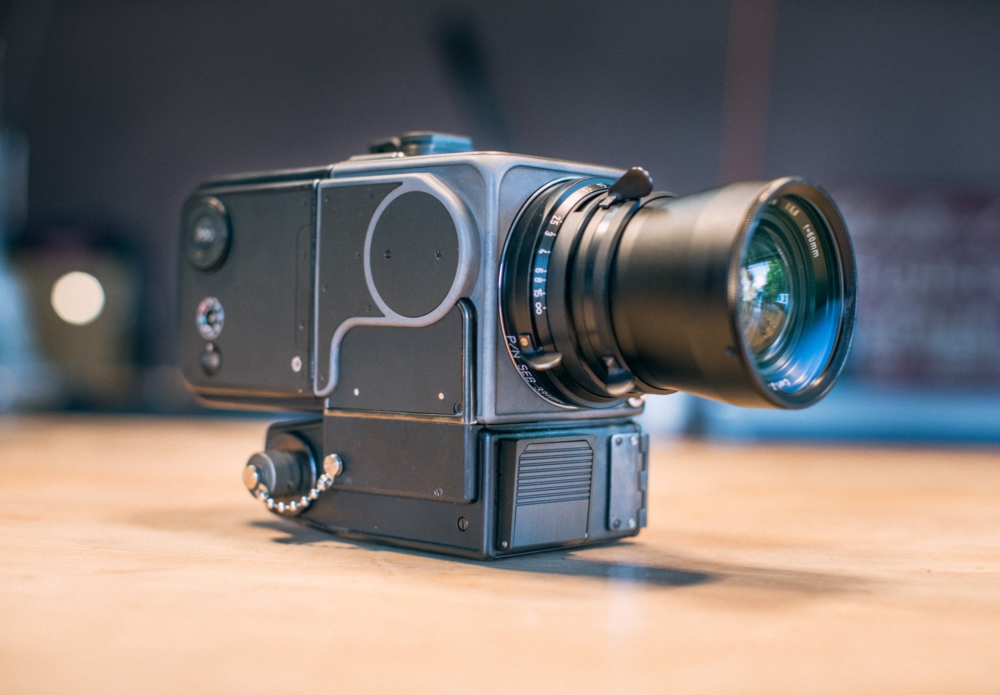

Four years ago, I set what seemed like an impossible goal: to make a functional Apollo 11 camera by the 50th anniversary of the moon landing. It was a crazy idea, especially with how inexperienced I was with nearly every process that would be required to do so.
I would need to build a workshop and learn how to operate machines that can precisely remove metal as easily as they can imprecisely remove your arm. I would need to learn how to 3D model parts, create accurate technical drawings, repair and reassemble rare camera bodies and intricate lenses that have very little documentation. It would take many thousands of hours of research, practice and learning, and it wouldn’t be cheap.

I was able to find an old government MK-70 in complete disrepair—with missing parts, chipping paint, non-functional motors coated in crystalized battery acid—and salvage what would have been extremely difficult to manufacture. Combined with a new body housing from another broken Hasselblad from 1965, a beater suddenly had a second chance at life as a moon camera. One that may have preceded it on the same production line.

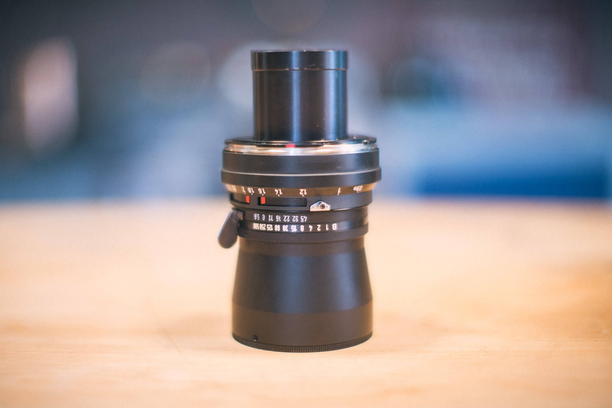

The hardest part of the entire process was modifying the 60mm lens that came with the MK-70. The moon lens had a beautiful, matte black finish with rings that clicked crisply as you pushed friendly little levers with your bulky space gloves.
My lens? Modern shiny black finish, no levers, and the aperture ring didn’t click:
Damn. If we’re going for hyper-accuracy, we need clicking!

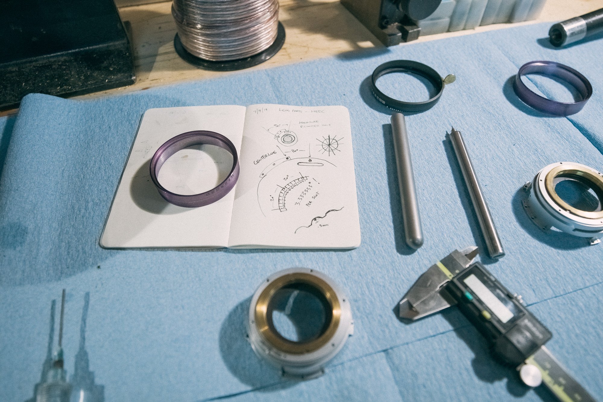

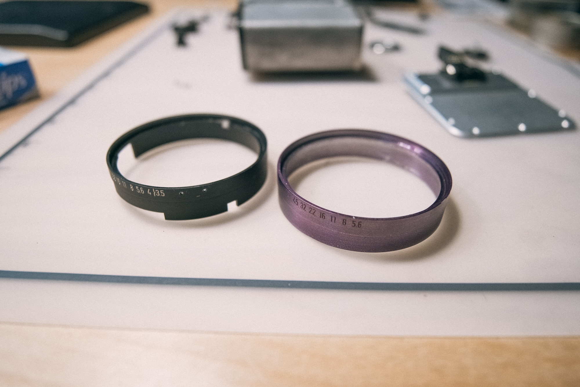

That meant a whole new aperture ring needed to be made, with engraved aperture numbers accurately spaced and internal gearing to make it *click* when you moved it. If any one gear, number, or bearing were off by more than half a degree, the aperture setting would be inaccurate, and the part would be junk.
After four weeks of reverse-engineering other lenses and realizing my math teacher in high school was totally right about Pi, I was able to model the new part, and have three blanks made by a very generous local manufacturer; three chances to screw up the laser engraving, the five-hour manual machining process, and the bead blasted anodize finish.
Thankfully, I only screwed up two.
Those friendly little levers were relatively easy to 3D print and cast out of metal after that, and the entire modification process was non-destructive, which means I can reverse the changes in the future if I need to.

You know what’s crazy? Any part of this camera could be swapped on the real thing and it would both fit and function as it would on the surface of the moon. There’s still a long way to go, however, to make it the most accurate representation of what’s still sitting in the lunar dust in the Sea of Tranquility.
