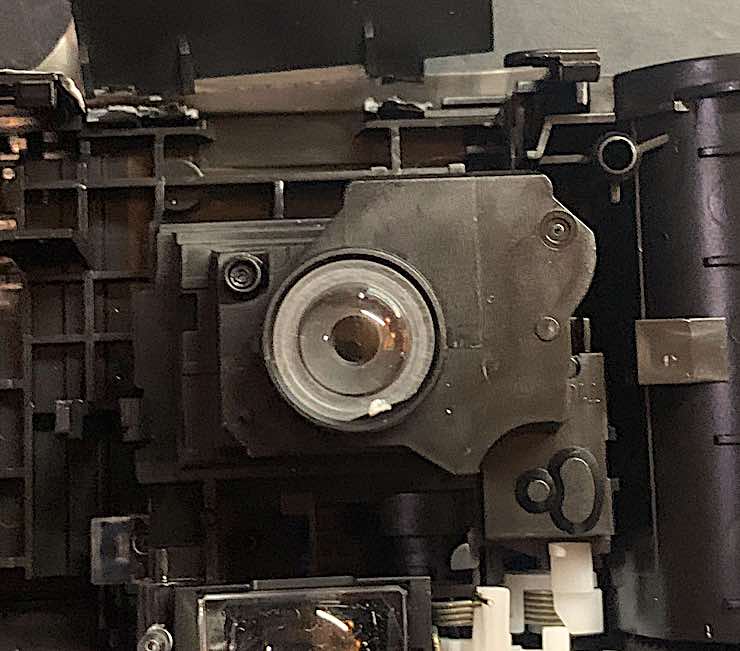

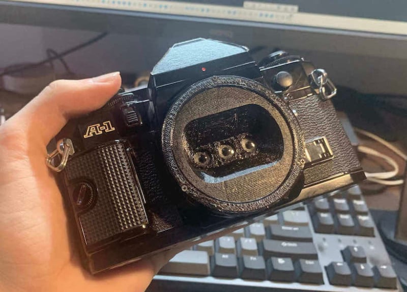

The only parts of this lens that aren’t 3D printed are the 3 plastic lenses and a few screws. The lenses came from expired disposable cameras I got for dirt cheap on the Hong Kong version of eBay. After passing out the disposable cameras at a party, I was left with 3 rolls of pretty terrible photos and 3 plastic 30mm lenses. It’s pretty easy to get the lenses out of the camera, you just need to rip it apart until you reach the lens (and while you’re at it, salvage the flash module and build a small camera flash!).
Disassembled disposable camera with its lens
The Design
I modeled up the lens in Fusion 360. It’s a pretty simple design, but it was a bit of a pain to figure out how far away the lens should be from the film plane to get the image in focus. I wanted things from about 0.2–1.5m to be in focus since I would be primarily shooting things close to the lens.
At first, I tried to calculate the distance to use, but eventually I just decided to make a ton of designs to slowly hone in on the right distance. The lens has a relatively small aperture of f/10, so it doesn’t have to be super precise. The final distance from the lens to the film plane was somewhere around 30mm (obviously, since the lens has a focal distance of 30mm), which meant that the lenses are recessed into the camera body by about 10mm.

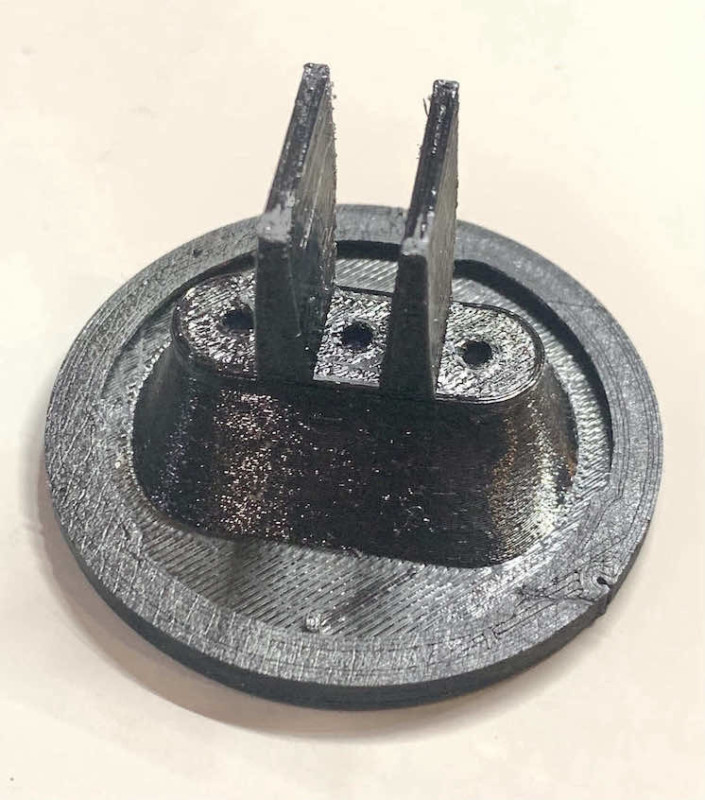

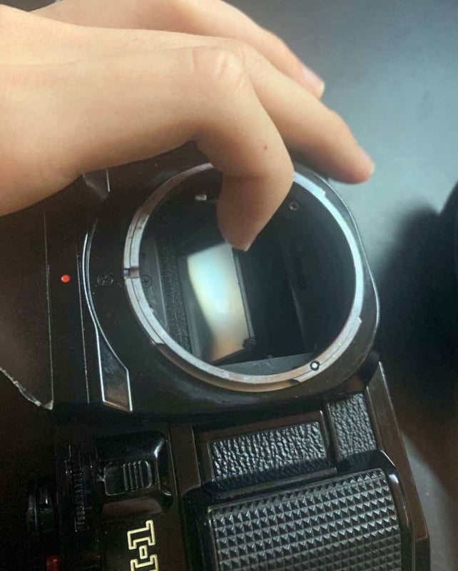

To keep the three images separated, there has to be a divider between each lens that extends into the camera all the way to the film plane. This was a bit of a problem for my Canon A1 since it is an SLR camera – meaning that the mirror for the viewfinder is in the way.
Some SLR cameras have a “mirror lockup” feature that allows you to flip this mirror up and out of the way (normally used to prevent camera shake when taking a photo), but my camera doesn’t have this. I instead just kinda push the mirror up when putting on the lens, being careful not to smudge the mirror in the process. Unfortunately, this also means that you don’t have a viewfinder to preview the image, but that’s a luxury I can live without.
You can see the two dividers which will extend into the camera’s body.
Pushing the viewfinder lens out of the way.
