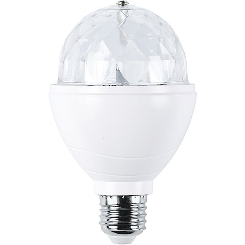

While looking through a store in Stockholm for fun things to modify light with, I found this disco light that fits in a regular lamp socket. I think it might be the same as this bulb I found on Amazon for $9.99.

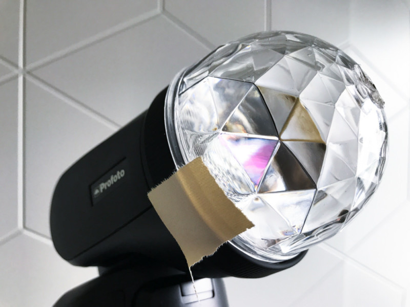

A quick visual inspection showed me that the plastic prism on top felt like it would fit perfectly on a Profoto A1 with its round head.
Remove the Bottom, Keep the Top

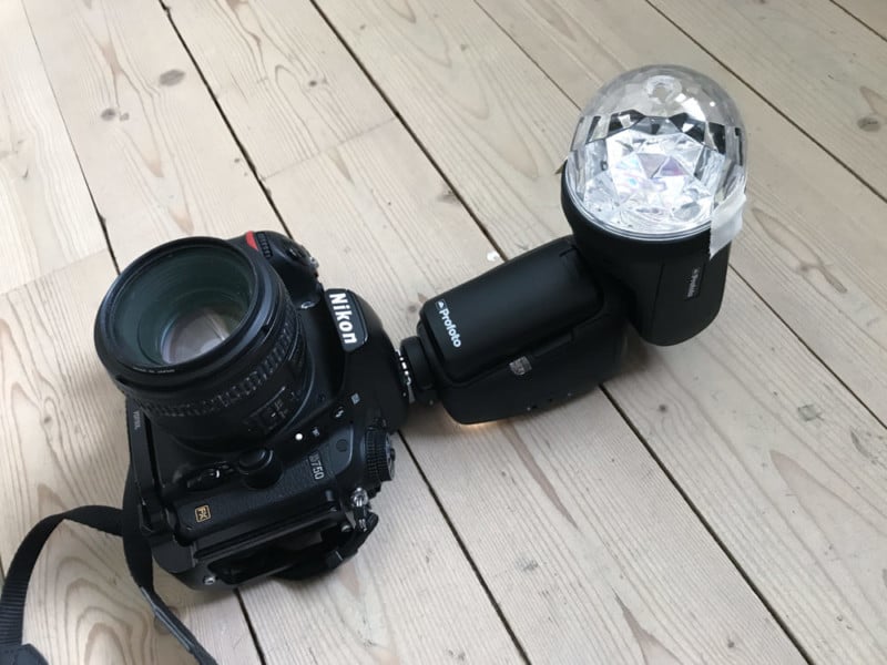

It was a perfect fit on my Profoto A1, just inside the outer ring. But removing it completely from the original mount on the LED lamp was not that easy. Pinch and pull and wiggle, and the top will come loose.
When you have removed the plastic prism, there will be a rod left inside screwed to the top that was a lot harder to remove.
A Not-so-Elegant Solution
To remove that rod (if you don’t, it will be long enough to make it hard to have the prism on your A1), I had to drill a few small holes around the screw to be able to wiggle it free.

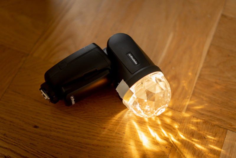

But then it fit perfectly outside the Fresnel lens of the A1. To make it easy, I just attached it with tape. A more elegant solution would, of course, be some kind of magnet, but that I save for version two.
Nice Light Patterns

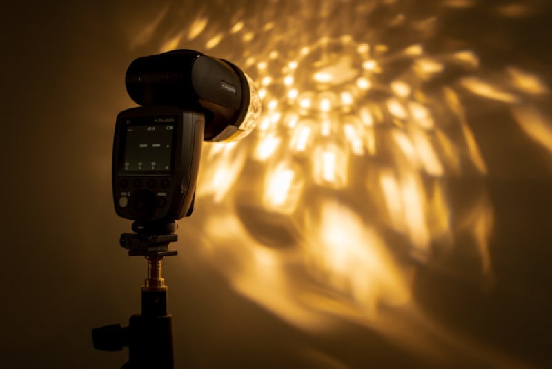

When you have it attached to your Profoto A1 (it might fit on the new Godox with the same round head, maybe?) it opens up all kinds of possibilities to light a background.

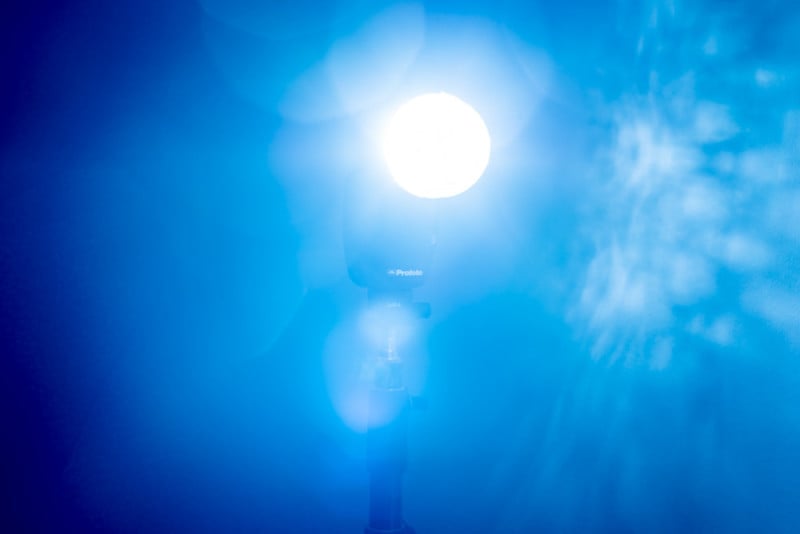

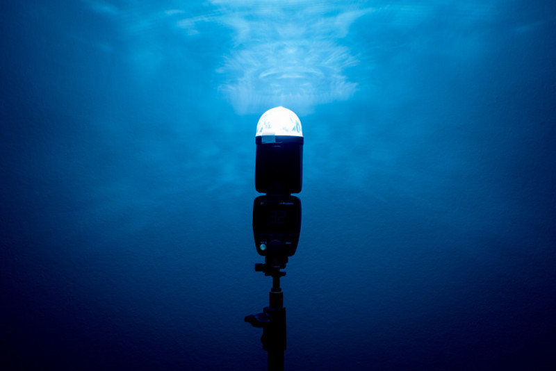

Put it close to a wall from the side, or aim it straight at something for one kind of light effect. Have it further away for something else.

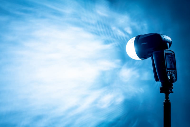

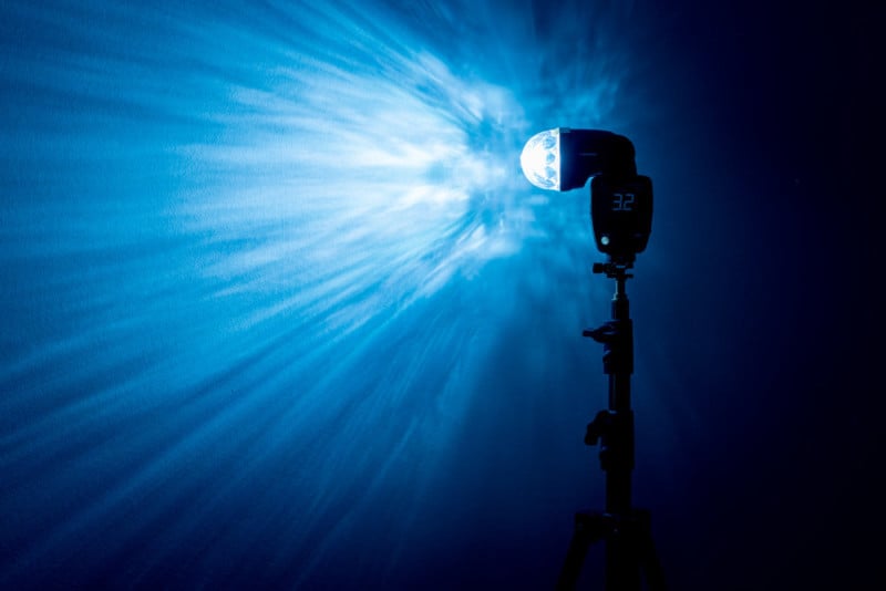

Use the Zoom Function on Profoto A1
You can create a lot of different patterns and effects from the same angle and position just by zooming the head of your A1.

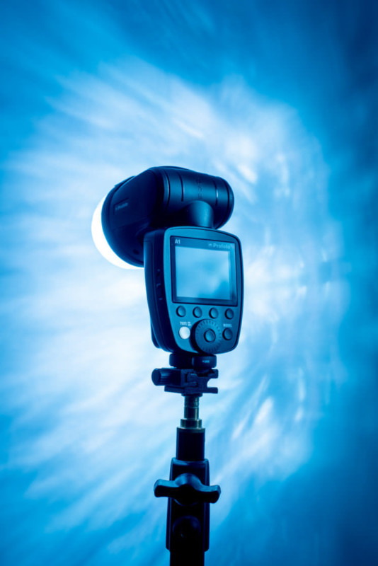

Cool Lighting Effects with Filters
Do you have a roll of color gel laying around? Cut it in small pieces and tape it inside of the prism, maybe more that one color?
