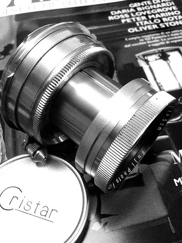

What you mean by collapsible lenses?
this is an example of a collapsible LTM lens, the early Leica summicron 50/2, summitar 50/2 and summar 50/2 are also similar. See the threads on the sides, it actually retracts into the camera body so that the overall profile is very slim. To use it, just extend and lock like a telescope.
I see thanks. So this is the only type of lens to avoid? What about lens like the canon 50 1.4 ltm or the nikkor one?
Those are fine. Most of the LTM lenses are fine to fit on the M9 or M8. Like Dan said, I will avoid collapsing those Collapsible on the M9. I've used mainly Voigtlander LTM-M adaptor which works fine on the M9.
