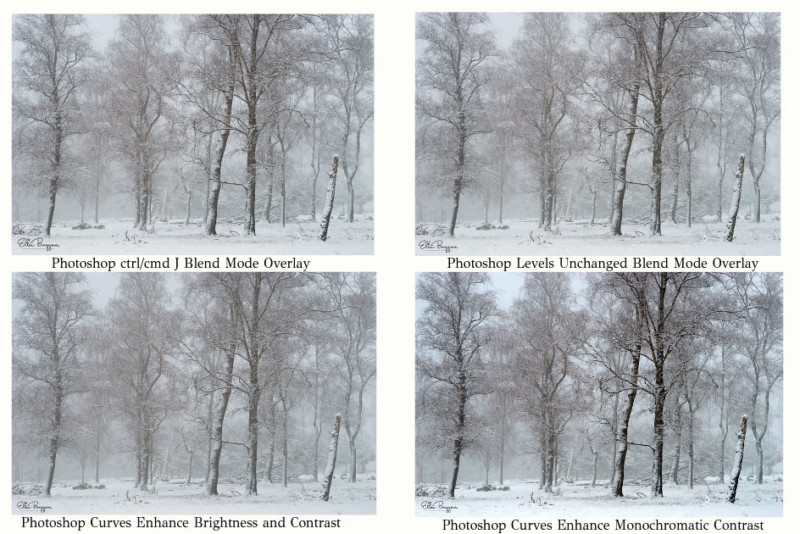

We can also add contrast in Photoshop. There are so many ways to do this that I could write many articles about it, but I will stick to explaining some methods that you might not have considered. The first method is to duplicate your layer and switch the blend mode to a contrast blend mode like Overlay. All the blend modes in the sub panel with overlay mentioned on top are essentially contrast blend modes and some are very extreme.
Now that you have changed the blend mode, there is more contrast, but you have also hugely increased your file size and this is why I do this differently. I add a levels or curves adjustment layer without making any alterations and then put the blend mode on overlay again. It has the exact same result, but without the disadvantage of a larger file.

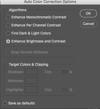

Next up is the wonderful curves adjustment layer in Photoshop which has some hidden options. Add a curves adjustment layer and alt or option click on “auto” which will give you four options to choose from. The dialogue box will look like this and some of these contrast options are really useful. I often use the Enhance Brightness and Contrast, of which I usually take down the intensity.
I also often use the option to add a levels or curves adjustment layer without any alterations made and switch the blend mode to soft light, which works in a more subtle way than the Overlay or Hard Light blend mode as you can see…
