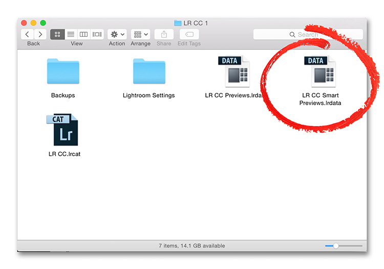

Q. Where are these Smart Previews stored? Are they on my computer or the external drive?
A. When you create your first Smart Preview, it creates a separate data file for your Smart Previews (shown circled in red above) and it saves them in the same location you have your catalog.

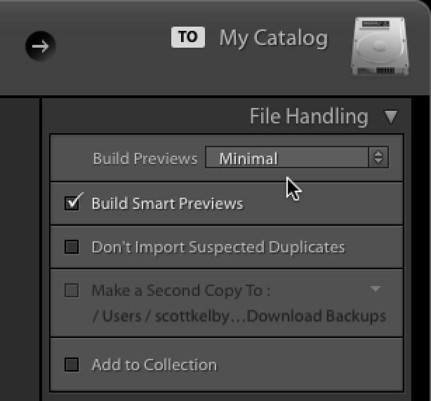

Q. When you import and opt to make Smart Previews, does LR also make regular previews as well? If so, why?
A. Smart Previews are an optional add-on (If you look in the Import Window seen above, it’s just a checkbox to add them, but you still have to select your choice for which type of regular preview you want (they are stored in two separate data files). If that weren’t the case (one replaces the other), then when you turned the ‘Build Smart Previews’ checkbox on, it would gray the other preview options out.

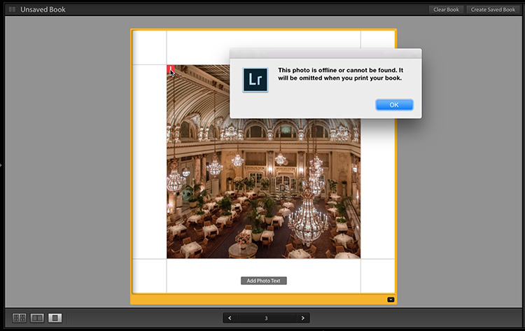

Q. Is there enough resolution with smart previews for creating books?
A. The Book module doesn’t recognize Smart Previews, so we’ll really never know if it has enough resolution (though I think it probably would for the smaller 7×7″ book, or if you just made the image small smaller than an 8×10″ image in the book), but that’s kinda irrelevant because if you take an image with just a Smart Preview over to the Books Module, you will see the dreaded red warning in the top left corner of the image. If you click on the warning icon it says “This photo is offline or cannot be found. It will be omitted when you print your book” as seen here, so it’s going to ignore your photo and not print it.

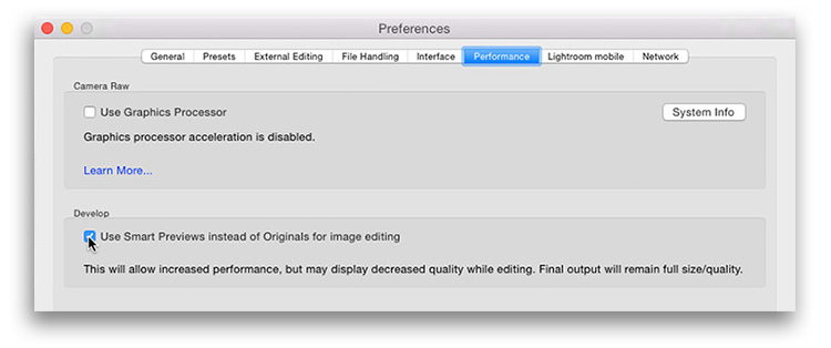

Q. I don’t have a very fast computer and not much RAM. Can Smart Previews help speed things up?
A. Actually, they can, because you can set a preference that Lightroom only use these significantly smaller Smart Previews when you jump over to the Develop Module, and that can speed things up quite a bit for folks in that situation. You find this setting by going under the Preferences, to the Performance tab, and turning on the checkbox for “Use Smart Previews instead of Original for image editing” as shown above.
