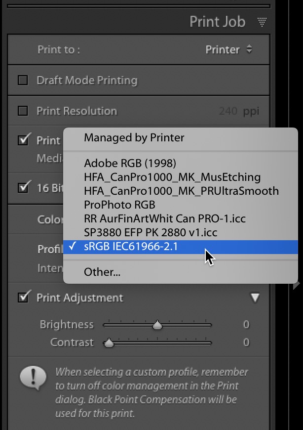

Q. If I’m saving my layout as a JPEG to send to the lab, which color profile should I apply?
A. Some major print labs will tell you to use sRGB as your color mode, but to make sure your lab is cool with sRGB, just drop their customer service dept. an email and ask them which profile they prefer (again, my guess is it will be sRGB, but better safe than sorry).

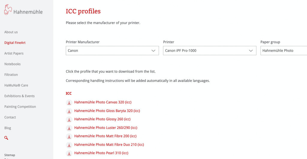

Q. If you are using a paper from a different manufacturer than the printer, how do you handle the profile?
A. If you’re printing to (say for example) a Canon imagePROGRAF Pro-1000 printer but you’re printing on say Hahnemühle Platinum Rag paper, you need to go to Hahnemühle’s website and download their free Platinum color profile for the Canon Pro 100 printer (at the Hahnemühle Website, under Digital Fine Art, choose ICC profiles, and then ‘Download Center.’ It will ask you which brand of printer you have, and then which model of printer. Lastly, it askes which of their papers you’re printing to, and then it brings up a download link to the free profile.

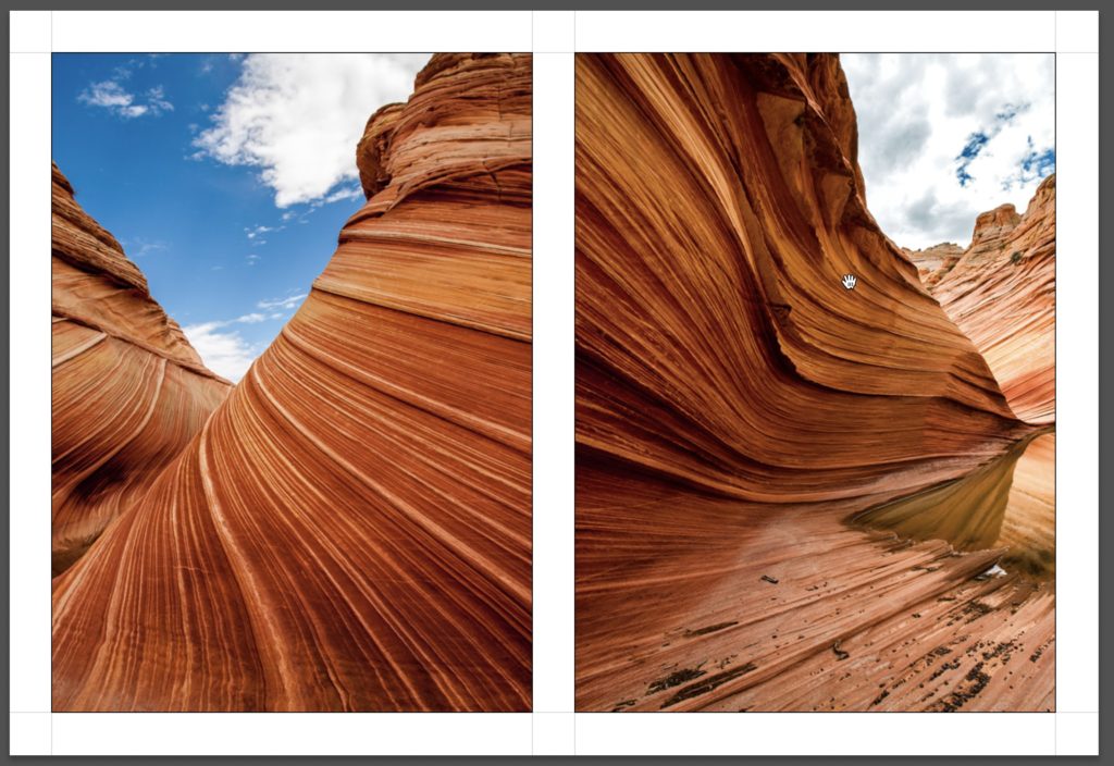

1. See the image on the right? Click and drag inside left/right to reposition the image inside the cell.

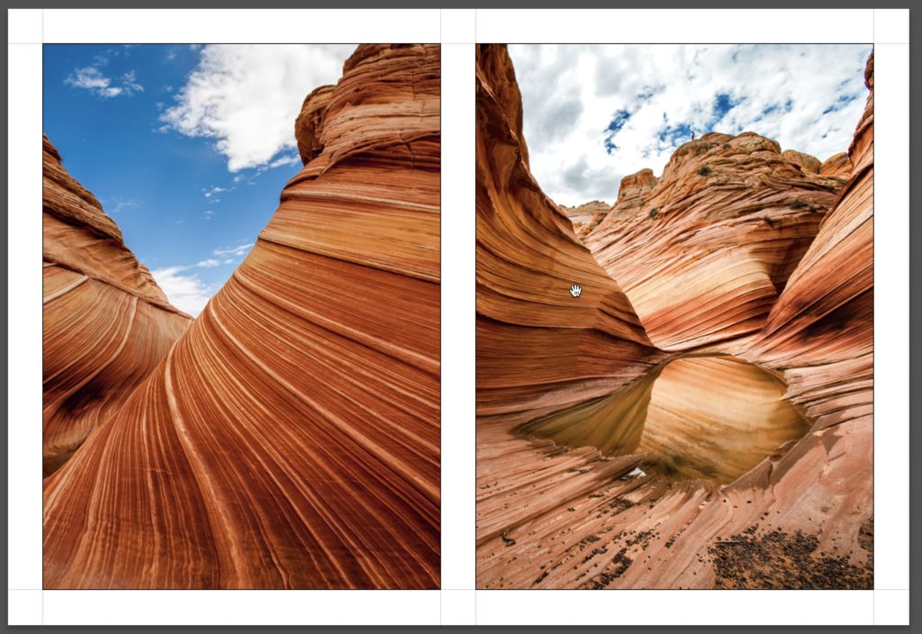

2. Here’s that same image repositioned in the cell.
Q. [In a layout inside the Print Module]: Can you control what portion of the picture will be displayed in the cell?
A. You can: just click and drag inside the cell to reposition the image. Depending on the image and the layout, you’ll probably only be able to drag left/right or up/down — not both.
