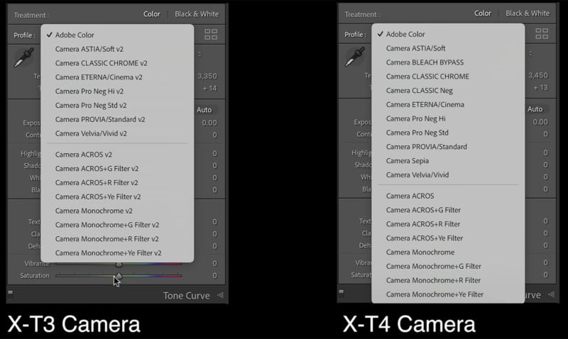

Depending on what Fujifilm camera you own, some film simulations might not be available to you. For example, those with an X-T4 have access to Bleach Bypass, but those with an X-T3 do not. These simulations are available in-camera as well as unlocked in Lightroom. But Lightroom can tell what camera images were shot on and will restrict available film simulations in kind:
Pal2tech says that while you can bypass this issue by editing a RAW file’s EXIF data before importing it, but that process is tedious and slow. Instead, he has found another way to make a setting change in Lightroom that will allow all film simulations to work, whether you’re using an XT-2, XT-3, or XT-4 RAW file.
