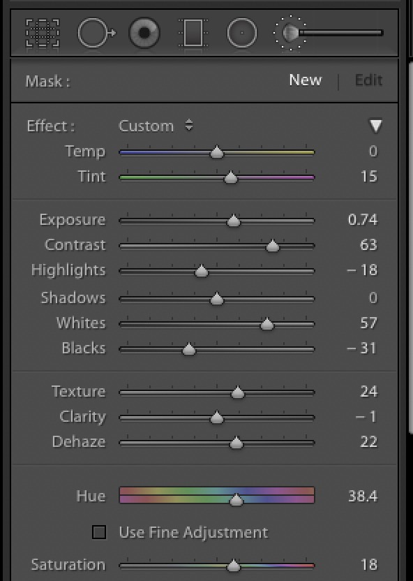

When you click on the Adjustment Brush, you’ll see that all the sliders are set to whatever you last used (as seen above), so if you just starting painting at this point, you’d be painting with old settings.

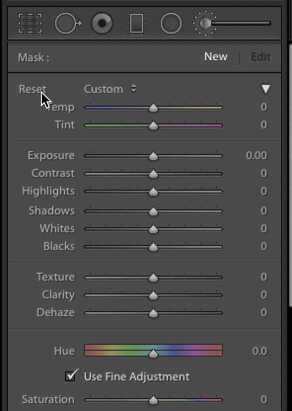

Above: If you hold the Option key (on Mac) or the Alt key (Windows) it changes the word “Effect” (top left) to the word “Reset” (as seen above) and if you click ‘Reset’ it resets all the sliders to zero for you (also seen above).
After The Reset…
Now that all your sliders are set zero, you can drag the sliders you want to make your adjustments. For example, if you wanted to brighten a part of your image (so basically, you’re painting with light), you’d drag the Exposure slider to the right (maybe start at +25 or +50 if you want that area really bright); paint over that area, and after you’re done painting, you can:

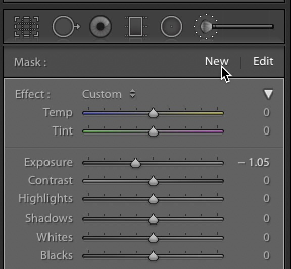

If you want to paint with the brush somewhere else in your image, with a different set of edits, once you start painting it assumes that any other areas you paint over will be tied to the one you originally created .To do that: click the “New” button up at the top of the Adjustment Brush panel. That tells the Adjustment Brush “Leave those areas I already painted alone — now I want to paint different adjustments somewhere else” and you do that by clicking the “New” button at the top of the panel (as seen above).
After The Reset…
