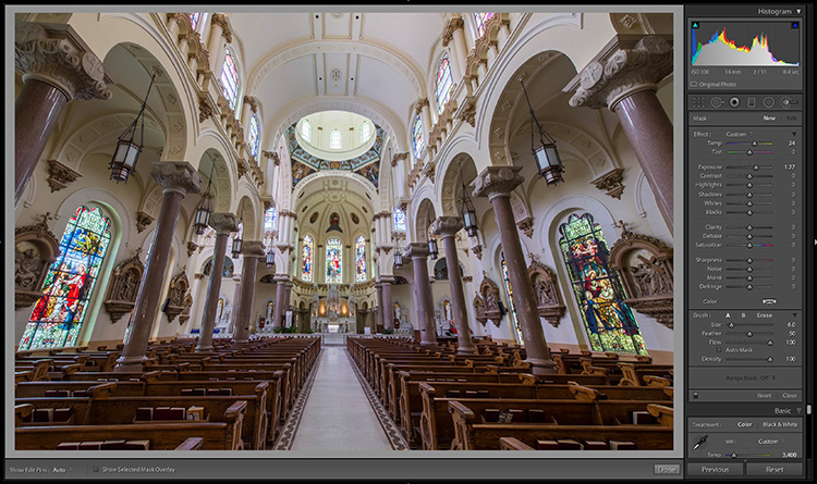

STEP ONE: Here’s the original image, and I want to make it look like those hanging lamps are turned on. We do this with the Adjustment Brush, so click on the Adjustment Brush tool. Then increase the Exposure Amount (here I increased the Exposure to +1.27. Then drag the White Balance Temp slider the right over to 24 to add some yellow to the brush. Note: This was a JPEG image. If you’re doing this on a RAW image, just drag it over a bit until it’s a bit warm.

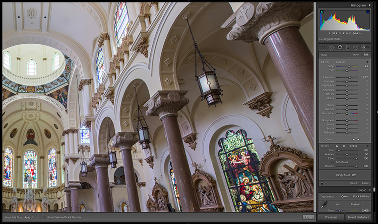

STEP TWO: Zoom in, and make the brush a little smaller than the size of the lamp you want to “light.” Now just click the brush once inside the area where the light would appear, and voilá it’s lit! (as seen here).
Above: Here’s a Before/After so you can see what the lamp looks like when it’s lit (on the right).
STEP THREE: In the case, the lamps gets smaller as they get farther away from the camera, so after you “lit” the two forward-most lights; shrink your brush size a couple of notches and then repeat the process for the next two farther away lights, and again with the next two, and so on shrinking your brush as you go. The final “lit” image is above.
