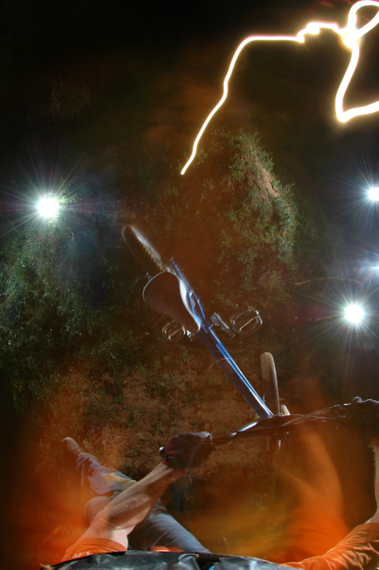

“It was in 2006, and I really wanted to capture a photo that showed what the rider sees while doing a trick… and I wanted to do it at night, because it would look way more cool!” Picard recalls. “At that time, GoPro was at its beginning—I don’t even remember if the brand was already available in France or not. I checked Wikipedia and it looks like the Digital HERO from 2006 was a 640×460 camera… would be hard to print a full page with that!”

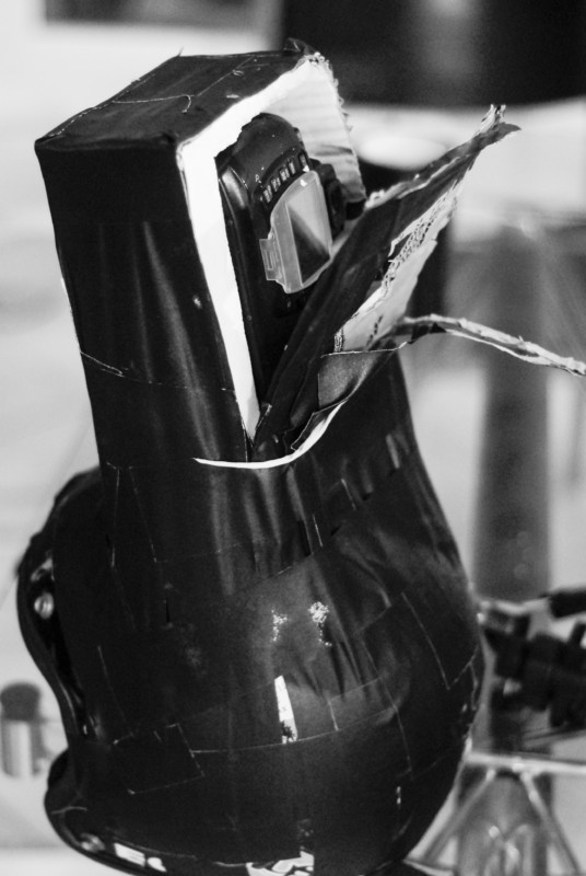

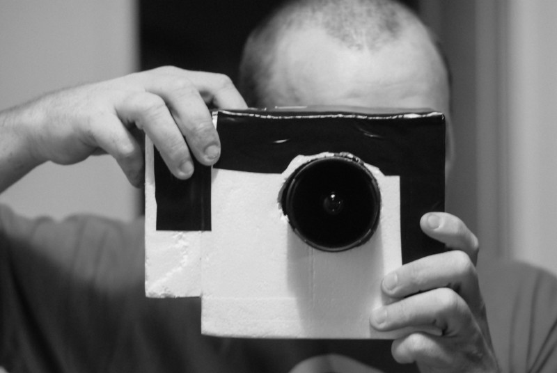

“The only solution would be to put a real DSLR on the head of the rider… and that’s exactly what we did,” he laughs, recalling the very ‘janky’ setup they came up with. “As you can see from the BTS pics (below), we put a Nikon D70 with the 10.5mm fisheye on a poly box, then taped it onto an open-face BMX helmet using a LOT of gaff tape.”
One problem, recalls Picard, is that the helmet was now both huge and heavy, but Bibi took to it without an issue. All that was left was to actually go out and try to get a photo using the helmet mounted camera.

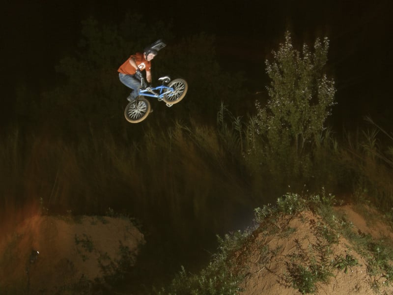

And… it worked! On the first try at that. After a few more practice runs, they used this setup to capture the photos below of Bibi doing a Tailwhip—that’s where you push the back of the bike and let it rotate 360° underneath you in the air… imagine doing that with a full-sized DSLR strapped to your head:
And here’s a photo of the trick in action:
Picard admits that the photos they captured are far from perfect.
“You can see the flashes and I cut off the right hand… but I don’t care,” he says. “I had a unique photo at that time, we had some fun, and nobody got hurt. In that kind of photography it’s all that really matters at the end.”
