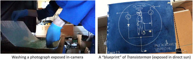

Figuring that if it was worth doing, it was worth overdoing, my first analog camera was an 11×15-inch large format camera that was designed to use Mike Ware’s New Cyanotype Process, where it would expose a negative cyanotype photograph directly onto coated paper. It turns out that there are many reasons that this hasn’t taken off as a common technique, but I found the entire process fascinating!
The Chemistry

The camera in this configuration has produced some pretty nice prints, with a lot of detail visible on static subjects like the roof of a house, but significant blurring for mobile objects like trees in wind. These two prints are nice enough that I actually found some 11×15-inch frames and hung them up, but it’s not like they’re digital quality. I love them more for the technical challenge than the actual image quality. Maybe that just means the images are only special to me, but then I’d recommend a project like this to any hands-on maker/photographer so you can produce your own!
