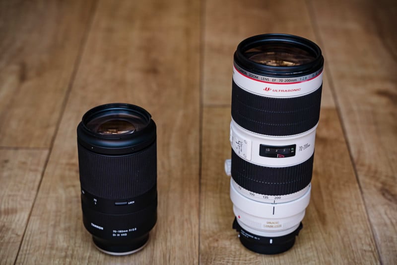

I’ve just received my own Tamron 70-180mm and thought it would be interesting to do a review specifically comparing it against the Canon 70-200mm to decide if is it worth the switch. I’ll compare both lenses across a range of parameters to see which comes out on top.
The Canon EF 70-200mm f/2.8L IS II USM and Tamron 70-180mm f/2.8 Di III VXD

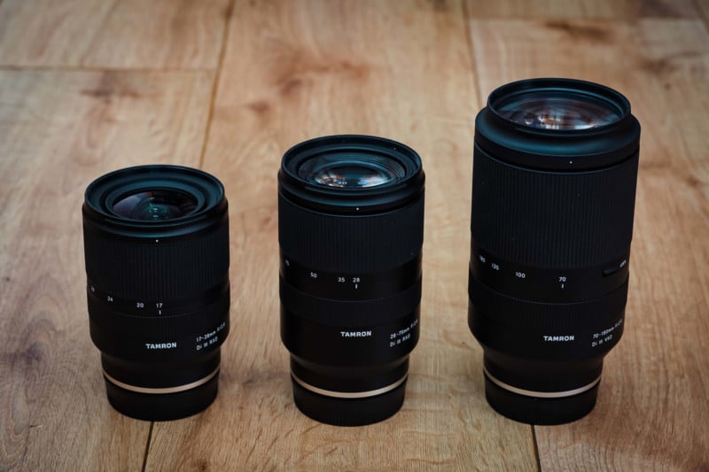

Having already bought and been hugely impressed with the E-mount Tamron 28-75mm f/2.8 Di III RXD and the Tamron 17-28mm f/2.8 Di III RXD zooms I was keen to see how Tamron’s longer focal length zoom would perform.
The Tamron “holy trinity” E mount zoom lenses
The current Tamron zooms that I have offer excellent image quality at a much more affordable price than the native Sony equivalents. I’m mainly a prime lens shooter but do like a set of zooms for backup use and for when I need that extra bit of flexibility. Being as I mainly shoot primes I don’t want to be spending a fortune on my zoom lenses. This is one of the main reasons I’ve been drawn to the Tamron range rather than the Sony equivalents.
The Tamron total for the three lenses is $2,977, and the Sony total is $6,994. The three Tamron lenses are less than half the price of the Sony equivalents, the saving of $4,017 is hard to ignore.

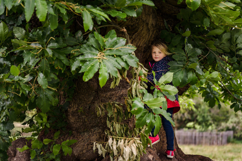

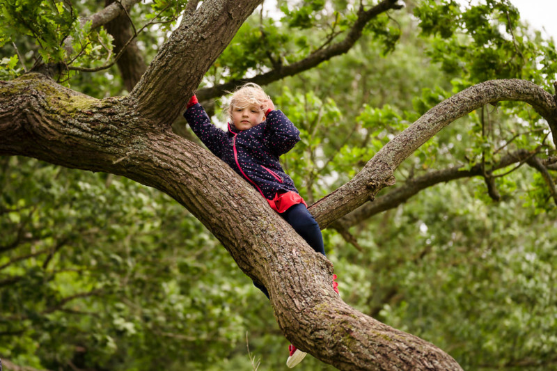

Zoom Range / Field of View
Before the Tamron 70-180mm f/2.8 Di III VXD was even available, there were plenty of people online ranting that they would never get it as it only zooms to 180mm rather than 200mm. When comparing wide-angle lenses, a few mm difference in focal length can make a big difference in the field of view. However, the effect is diminished as the focal length increases. One of the first things I wanted to test was to see just how much of an effect the loss of 20mm at the long end of the zoom range really has.

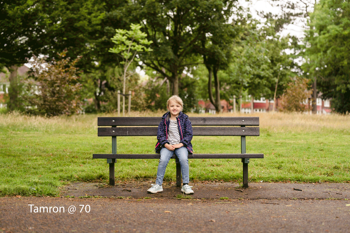

The following shots were taken with the help of my daughter, who sat as still as a five-year-old can (which is not very still) so that I had a human target. Both lenses were shot wide open at f/2.8 and focused on the face using eye AF. Upon import into Lightroom, I applied my standard preset and also tuned on the lens corrections to remove any distortion and vignetting. To make the comparison of field of view easier the images were combined into GIFs. However, this does reduce the quality a little. This first shot is with both lenses at their maximum zoom range.
Field of view comparison at maximum zoom
As expected, we can see that there’s definitely a difference with the Canon showing a slightly tighter crop. Is it enough to completely dismiss the lens? No, not for me. If you do need a 200mm equivalent field of view with the Tamron, with today’s high-resolution sensors, the loss of a few megapixels of data when cropping shouldn’t be an issue for most people.
For the next image, the Canon 70-200mm was set to 180mm to check how the field of view compared to the Tamron at 180mm.
Field of view comparison at 180mm
The field of view is almost the same, some of the difference seen is due to the movement of the tripod mentioned earlier.

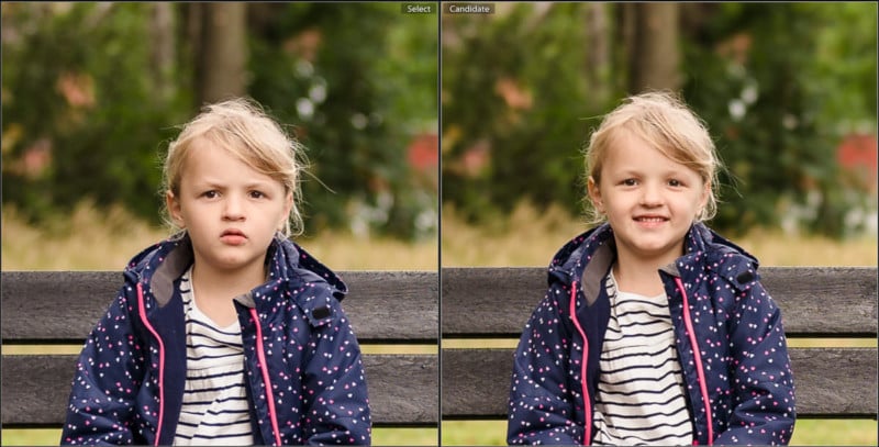

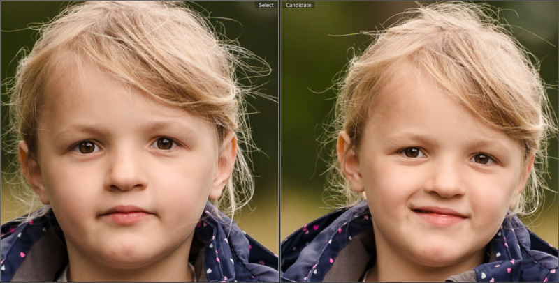

One of the ways that I evaluated sharpness in the past was by using the rather brilliant Focal software from Rikan. This is an automated test tool that gives an empirical measurement of lens performance/sharpness. Unfortunately, the software doesn’t support Sony cameras so I’ll have to make a more objective visual assessment.
I’ve made a side by side comparison of the images used in the field of view tests above. Zooming in at 2:1 and viewing on a 4k display. In the images below, the Canon file is always on the left and the Tamron file on the right. The first image shows the 2:1 comparison at the wide end with both lenses at 70mm.
Sharpness comparison at minimum zoom (Canon left / Tamron right)
Even when looking at the original files in Lightroom (not the web compressed versions you’re seeing here) I really can’t see any meaningful difference in sharpness between the two lenses.
This was also repeated with both lenses at their maximum reach — 200mm for the Canon and 180mm for the Tamron (hence the slight difference in size of the 2:1 crop below).
Sharpness comparison at maximum zoom (Canon left / Tamron right)
Again, I really can’t see any meaningful difference in sharpness, the Tamron is equally as sharp as the Canon.
And the winner is… using my completely unscientific/uncalibrated eye I score this a draw, both appear as sharp as each other.

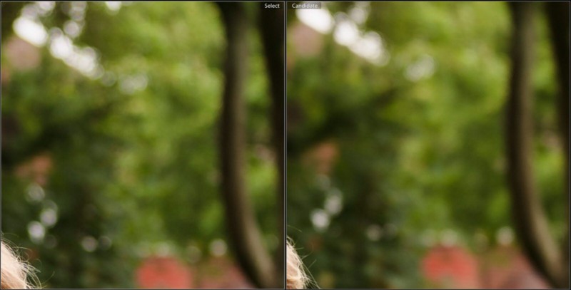

Bokeh

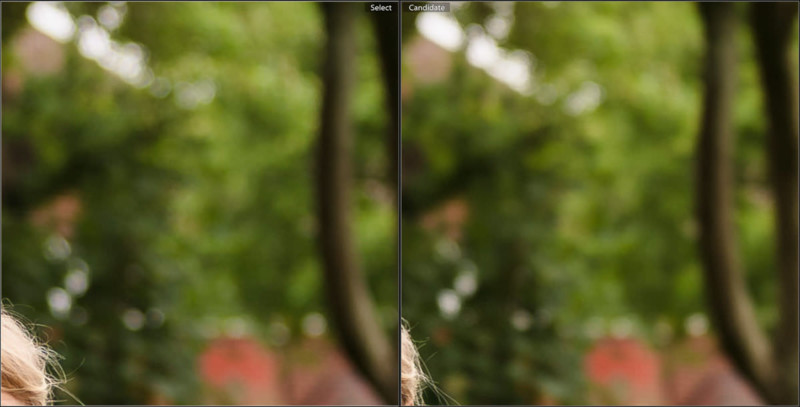

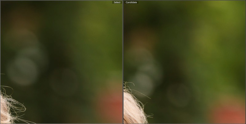

How the lens renders the out of focus areas is also really important. The in-focus areas need to be sharp with smooth out of focus areas desirable in order to give nice separation of the subject from the background. I want the bokeh to be as free from detail as possible so that the eye is drawn to the subject.
I again used the images from the field of view tests, but this time examining the out of focus background. This first image is from the 70mm wide end of both lenses, again the Canon image is on the left and the Tamron on the right, the crop is at 3:1.
Bokeh comparison at minimum zoom (Canon left / Tamron right)
I’m not seeing a massive difference, the bokeh is a little bigger in the image from the Canon lens but this is due to the Canon not being as wide as the Tamron (even though they both are listed as 70mm at the wide end). To try and even things up a little I also compared a 3:1 crop of the Canon at 70mm and the Tamron at 75mm, this is shown in the next image.
Bokeh comparison with Canon at minimum zoom and Tamron at 75mm (Canon left / Tamron right)
To me, there’s not a massive difference in quality here. There may be a little more detail/contrast in the left-hand-side image from the Canon and the Tamron looks a fraction smoother (it’s very marginal though to my eyes). This gives a very slight advantage to the Tamron.

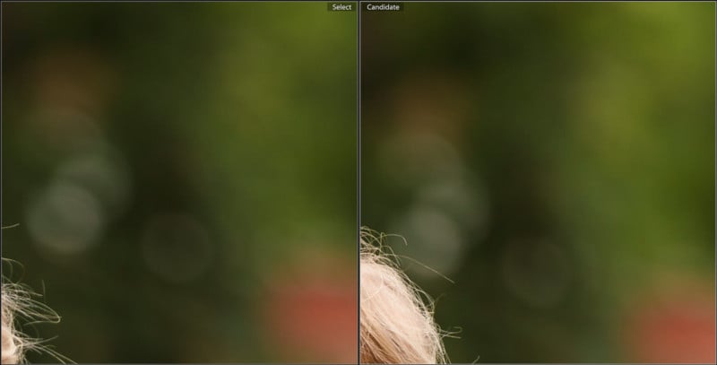

The same comparison was repeated with both lenses at their maximum range — 200mm for the Canon and 180mm for the Tamron. The 2:1 crop is shown below.
Bokeh comparison at maximum zoom (Canon left / Tamron right)
As with the wide-angle comparison, there is an obvious difference in the size of the bokeh due to the different focal lengths. Another crop was taken, this time from the images with both lenses at a matching 180mm.
Bokeh comparison at 180mm zoom (Canon left / Tamron right)
As with the wide-angle comparison, I feel there’s a little more detail/contrast in the out of focus areas of the Canon and the Tamron is a slight fraction smoother.
And the winner is… again using my unscientific/uncalibrated eye it’s a slight win for the Tamron

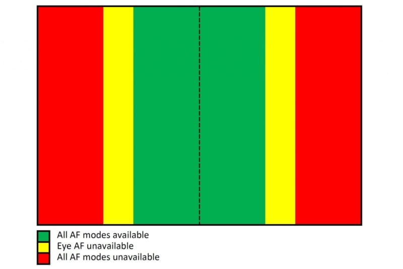

When I originally switched from the Canon 5D Mark IV to the Sony a7 III one of the main features that drew me over was the insane autofocus performance of the Sony cameras, I felt that the face and eye AF were game-changing technology. However, one of the drawbacks of using an adapted lens is that the face tracking/eye AF doesn’t cover the same viewfinder area as native Sony glass.
In the vertical direction, the coverage is roughly the same, with adapted and native lenses both allowing the AF system to work all the way from the top to the bottom of the frame. However, there is a significant difference across the horizontal axis as you move from the center of the frame out to the edge.
To find out the range of the AF system I did some tests to map out the areas where repeatable AF occurs for both lenses. This was done using a face as a target which was approximately 3m from the camera. The tests were done with each lens wide open and a record made of where the AF performance changed as the target moved around the frame.
On the Tamron 70-180mm, the AF works just like native Sony glass, allowing eye AF, face detection, and manual AF point selection across the entire frame. However, with the adapted Canon 70-200mm on the Sigma MC-11, the AF coverage is reduced. The eye AF only works in the center 40% of the frame. All of the other AF modes will then operate up until you get 60% from the center of the frame. Once you get further out than 60% from the center of the frame AF does not reliably work. I’ve summarised this in the graphic below.
Sony a7 III AF coverage with the Canon EF 70-200mm f/2.8L IS II USM and Sigma MC-11
This reduction in AF area coverage on the adapted Canon 70-200mm f/2.8 can make focusing a problem when you’re using autofocus and the composition is away from the center of the frame. I don’t have any access to any other Canon to Sony autofocus adapters so I’m not sure if this change in performance is unique to the Sigma MC-11 adapter.

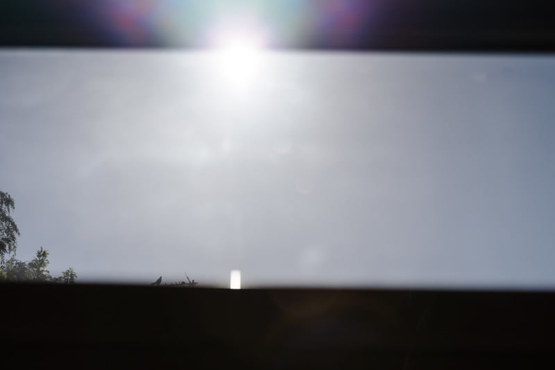

Flare

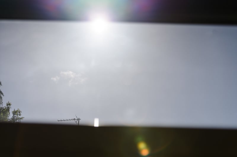

I’ve only done some very simple and quick testing of the flare handling of the two lenses. These tests were done shooting directly into the sun through a window with both lenses wide open at f/2.8 with the zoom at 70mm. I wanted to shoot through a window so that I could keep some of the frame dark so that any flare would hopefully show up better.
Canon EF 70-200mm f/2.8L IS II flare test
Tamron 70-180mm f/2.8 Di III VXD flare test
Not the most scintillating of photos but they do show that the Tamron is streets ahead of the Canon in terms of controlling flare. I’m not sure if the newer Mark III version of the Canon 70-200mm would fare any better, as according to reports, the only changes were to some lens coatings which may help with flare control.
And the winner is… The Tamron 70-180mm has much better flare control.

Size

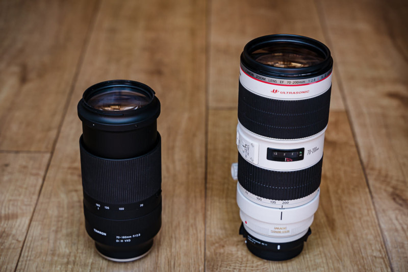

Rather than take the length measurements from the manufacturers’ websites, I took my own measurements. I wanted to ensure that the lengths were measured in the same way on both lenses. The measurements were taken from the front-most protrusion of the lens body to the lens mount flange and not including the internal bayonet.
The Canon EF 70-200mm f/2.8L IS II USM has a length of 200mm, but you also need to add on the 25mm for the Sigma MC-11 adapter. This brings the total length to 225mm. The Tamron 70-180mm f/2.8 Di III VXD is 26% shorter when at 70mm focal length as the lens is 147mm long.
Tamron 70-180mm fully retracted next to the Canon 70-200mm
When fully extended at the 180mm the length of the Tamron increases by 30mm to 177mm long. However, it’s still significantly shorter than the 225mm of the Canon lens and Sigma adapter.
Tamron 70-180mm fully extended next to the Canon 70-200mm
This is a big plus for the Tamron with the shorter length, especially at 70mm, giving much more packing space in the camera bag.
In terms of diameter, the Tamron is also smaller and uses a 67mm front filter (which is the same as the other Tamron zooms), where the Canon has a 77mm filter thread. As well as being smaller diameter the smaller thread makes any filters for the Tamron cheaper.
And the winner is… a big win for the small Tamron.

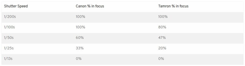

The two lenses use different methods for image stabilization. When the Canon EF 70-200mm f/2.8L IS II USM is mounted on the Sony a7 III the system is only utilizing the IS within the lens itself and the IBIS system in the camera body is disabled (the SteadyShot option within menu 2 page 4 is set to off and greyed out so that the setting can’t be changed). The Tamron 70-180mm f/2.8 Di III VXD doesn’t contain any in-lens stabilization and relies entirely on the IBIS system within the camera body. I was really curious to find out which system would work best. It’s often stated online that in-lens IS works better than IBIS at longer focal lengths. However, there is a significant weight difference between the lenses which could also impact the results.
It’s hard to do an accurate, quantifiable, and repeatable image stabilization test. Although probably not a perfect method, the best I can come up with is to shoot a static target while hand holding the camera at differing shutter speeds.
To make the test as extreme as possible I set each lens at its maximum focal length in order to magnify any unintentional movement of the camera. This does give a slight advantage to the Tamron lens with its slightly shorter focal length of 180mm. I then set a target (a biscuit tin lid with a very detailed pattern!) very close to the camera, at 1.8 meters, again so that any movement of the camera would be more noticeable. With the lens wide open I took a series of individual shots (not burst mode) at 1/200s. I then reduced the shutter speed in one stop intervals and took a series of shots at each interval, repeating until I could no longer obtain blur-free images. All the shots were taken trying to utilize my best sniper breathing techniques in an attempt to minimize the camera movement. The files were then bought into Lightroom and viewed at a 4:1 magnification on a 4k screen and evaluated. I then looked to see what percentage of images were tack sharp and motion free.
Image stabilisation test file
The results of the testing are summarised in the table below.
The results from the testing show that the Canon, with its lens-based IS system, has a clear advantage over the Tamron, which utilizes the in body IBIS system of the a7 III.
Note that this is a very extreme test, the shots were taken at the maximum focal length of the lens with a target only 1.8m away and I was being very critical when looking for any movement in the files.
And the winner is… The Canon, the in-lens IS system beats the IBIS method used on the Tamron.

One of the big advantages of using a native mount lens is not having to use an adapter. An adapter introduces another set of interfaces / potential failure points. Additionally, the Sigma MC-11 adapter is not weather-sealed, so shooting in inclement weather is not advised. The flap on the software update socket on the MC-11 in particular looks like a weak point.
Sony has a fairly big stake in Tamron and I think this plays a large part in ensuring there is full functionality of all the standard features when a Tamron lens is fitted. All the focusing modes work as well as native glass but also there is in-camera correction for shading, chromatic aberration, and distortion. You can also use the camera to perform firmware updates for the lens. If there are any further firmware updates for the Canon 70-200mm f/2.8L IS II USM then these could be problematic for me to perform as I no longer have any Canon bodies to enable me to update the lens firmware.
There’s a certain cachet to be had when using one of the big white Canon L series lenses with the red ring, they certainly attract knowing looks from other camera users. Although any 70-200mm lens would struggle to be called discrete, the big white Canon zoom certainly does attract attention whenever it is pulled out from the camera bag. This can be a big disadvantage if you’re trying to be discrete or shooting for natural/candid moments. The much smaller and more discretely colored Tamron 70-180mm should hopefully enable some more stealthy shooting.
It’s interesting to note that the new Canon RF 70-200mm f/2.8L IS USM for their new mirrorless RF mount cameras also adopts a telescoping design. This gives it a more compact and lightweight design compared to the Canon EF 70-200mm f/2.8L IS II USM. The RF 70-200mm weighs in at 1070g but costs a whopping £2599 (Amazon UK price as of July 2020).
Sample Images
I have no real-world wedding images to share yet so here are some pictures of my daughter running about and climbing some trees!

For me, it’s a resounding yes. I’m actually really surprised by the sharpness and bokeh test results of the Tamron 70-180mm. Somehow Tamron has been able to match the optical quality (and in some cases exceed it) of the big Canon zoom with a lighter, smaller lens that has fewer glass elements. The AF speed is incredibly fast and gives coverage over the entire frame. The only real downside is the reduction of build quality/robustness of the Tamron. However, that is offset by that incredible weight reduction which would not be possible without the build changes implemented.

Sony a7 III with Tamron 70-180mm f/2.8 Di III VXD
The real test for me will be how well this works in the wedding environment. Due to the ongoing coronavirus / COVID-19 situation weddings aren’t properly up and running in the UK yet.
