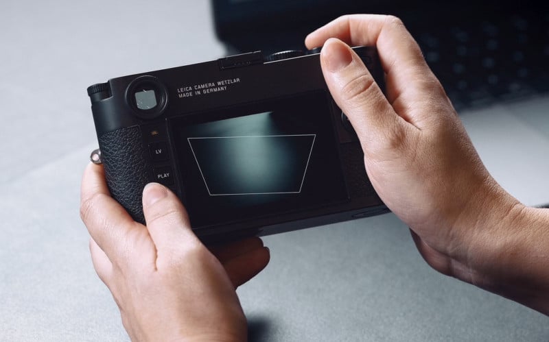

Leica Perspective Control (LPC) is found as a new option inside the Capture Assistants section of the menu.
Once turned on, the feature using the orientation sensors built into the cameras to figure out how the camera is oriented in relation to the ground, whether it’s straight, tilted upward, or tilted downward.
Using this information, the feature then uses computational imaging to automatically correct the distorted straight lines within a photo in order to make them straight again — this problem is commonly encountered by photographers shooting things like landscapes and architecture.

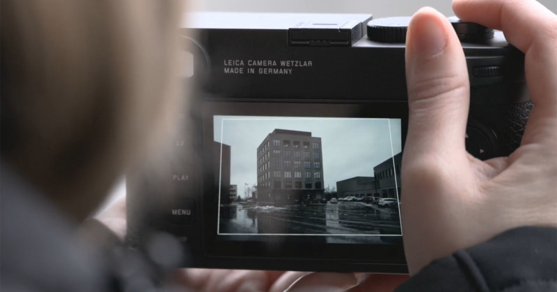

When framing a photo using live view, the photographer will see an auxiliary frame overlaid on the view that shows how the resulting photo will be cropped through the perspective distortion correction process.
